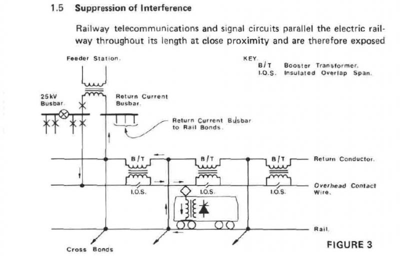

Another use of transformers in current mode is on railway traction supplies to create a return current parallel to the overhead supply cable to reduce the electromagnetic effect from the over head cable.

Interesting. That's clever, although I'm a bit confused as to why the 'cross bonds' between the 'return conductor' and rail do not seriously undermine the good intent of this system.
The wires at the mid-point of the booster transformers is required to ensure that the current gets sucked up into the return conductor. Without the mid-point connections, the transformer would be open-ended, and no current will flow.
I think I understand what you're saying, but there's a compromise to be had between the cost and losses of booster transformers, and the acceptable amount of current that can go through the rails and not interfere with signalling equipment.
The label 'cross bonds' by the way, is actually indicating the connections to the other tracks on a multi-line railway.
I realise why those connections (which I mistakenly thought were labelled as 'cross bonds') from between the transformers to the rail have to be there - for the reason you give. However, what was confusing me is that (except in the case of the 'last' transformer - i.e. the right-most one in the diagram) there are such connections from both sides of the secondary of each transformer to the rail. To put it one way, all but one of the transformers' secondaries appears to be partially 'shorted out' by the rail.
Thanks for clarifying. I guessed that, but thought that the label was also referring to the connections between transformers to rail.
