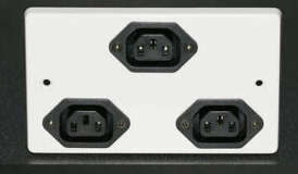

However, of more interest/relevance are things like this (and modular variants thereof) which, if part of an electrical installation, would be within the scope of BS7671 and, if not shuttered, non-compliant with it.
Returning to common sense, the apertures of C13/C15 female connectors are pretty small, and one would certainly have to 'poke something small into it' to achieve contact with life parts. A 32A (or larger) female 60309 connector is perhaps a little more worrying, since the apertures are much larger, and the 'life parts' not all that deep within them.

In common-sense terms, perhaps yes, but not 'non-compliant with BS7671', since such trailing sockets and leads are not usually within the scope of BS7671.
