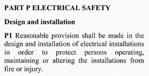

As we (nearly) all know Part P has nothing to do with notification.
It states:
That's it.
Definitions:
"Electrical installation (abbr: Installation). An assembly of associated electrical equipment having co-ordinated
characteristics to fulfil specific purposes."
and Approved Document P is guidance so virtually irrelevant.
Notification in Wales is still subject to Schedule 4 which only states what is NOT notifiable:
Quite so, but as I have been trying to explain to eric, although he persists in talking about 'Part P', it is, in fact, 'part' of the Building Regulations - which (as you go on to explain, do have a lot to say about notification (in general and, specifically, in relation to electrical work).
Definitions: "Electrical installation (abbr: Installation). An assembly of associated electrical equipment having co-ordinated characteristics to fulfil specific purposes."
That's the BS7671 definition and so is not really relevant to 'Part P', or to any other 'part' of the Building Regulations. The definition in the Building Regs is:
“electrical installation” means fixed electrical cables or fixed electrical equipment located on the consumer’s side of the electricity supply meter;
- but that begs the question about the definition of "fixed electrical equipment" and, as I wrote to eric, the nearest the Building Regs get to a definition is one of "fixed building services", which is not really the same.

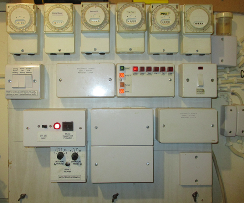

The electrics for my boiler, together with a fairly complex CH 'control system', are all supplied through a single 13A plug (to facilitate changeover to a genny supply) - see pic below. It's not in my kitchen, but could be, and if I were, and I were in Wales, then that 'blanket' interpretation would mean that it was not notifiable. Whilst it may be 'obvious' that the TV and kettle base (screwed to wall or work surface) were not notifiable, is it equally obvious to you that none of my CH control system would be notifiable?
