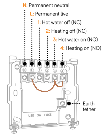

Update...
My brother-in law is an electronic engineer and whilst not a central heating expert, came round for a few hours and with the wiring diagram and some kit, went through is all, testing along the way.
What he discovered was that the wiring was fundamentally correct and the cyl and room thermostats are working, but the timer was not giving the correct signals (Tempus 6).
Upon further investigation, we discovered a likely bad connection where the timer pins insert into the back plate (he manually jumped two of the connections with the timer off the wall and everything jumped into life). Lots of emery cloth and fiddling later and we got it to work* but it remains intermittent depending on whether we press the unit against the back plat firmly or not, confirming this is (one of) the issues, despite lots of connector and pin cleaning. Perhaps the timer is on the way out (2004)?
In addition to this, we discovered that the 3 port valve was not behaving itself again - despite heat being called for, the valve lever stayed in the left hand position for hot water only, even with the room stat way up high. I also discovered when I first went to it that the lever was loose and in the heating position, despite this not being the commanded status.
*When I say working, it still doesn't command the central heating properly (at all) - when I select heating, nothing happens - but at least when I ask for hot water, it all now works.
Also, from memory, I have never since I;ve lived here (20 years) been able to just request heating only on the timer and it do anything - nothing happens. In order for me to get central heating, I must also switch the hot water on at the same time which doesn't seem right does it? Surely I should be able to just ask for heating but with the water side off and the boiler, pump, 3 port etc do their thing and heat the house?
So - should I bite the bullet and get a new timer AND back plate? If so, what is the cheapest, reliable one? I was thinking of this... https://www.unventedcomponentseurop...9wb_DvY5xhGJDND39P0Fy4aqetfQZPRhoCIuIQAvD_BwE It seems to do everything I need?
Also looks like the 3 port valve head is intermittently not quite right - are the £30 copy heads from Amazon okay?
Any thoughts on the call for heating only and nothing happening, ever situation?

I feel confident that the timer is okay, and it's just the connections that are poor and causing intermittent faults so I might try to fix this by properly cleaning everything up 'on the bench', rather than leaning into a dark kitchen cupboard. No harm in trying if it saves having to buy a new timer.
The Drayton Tempus Six programmer does provide the facility to have just the heating on without the hot water, my next question would have been about the dip switches / jumpers, so well anticipated!(y)
New programmers always come with a new backplate. I'm not aware of them being sold separately, but then I haven't looked, as I said before, I always swap them as a pair anyway. The blackplates are supposed to be the same, and most are, but I have known them not match up particularly well across different manufacturers.
Also, there are two parts to the electrical connection for the programmer, the slots on the backplate and the pins on the programmer itself, in the case of bad connections, it is most likely to be the backplate, but it might not be, it could be the pins on the programmer.
I don't know if this is an issue in your case, but the backplate should be mounted square and flush to the wall and not twisted, sometimes they are fitted so that the plate is distorted if the wall or any back box is uneven, which can cause a bad connection. Or, the programmer isn't securely fixed to the backplate. I've also lost count of the programmers I've seen that have their fixing screws missing or the location lugs broken, that prevent the two parts making a good connection.
Thanks. I stripped, cleaned and re-made all the connections both on the wires to the back plate and also the pins and slots etc to the point they were all solid and pristine and things have not improved - till flakey and random, making me feel that it is fact the timer that is faulty?? Perhaps a dry solder joint or bad relay?
On the point of the relays in the timer, I noticed that sometimes I don't hear the relays click when I switch it to the on position (either channel) and sometimes I do - is this a smoking gun as things only work when I hear the relay. Yes the backing plate is flush and square.
It's time (pardon the pun) to buy a new timer. I'm thinking of the Drayton LP522 - any other suggestions? Just want a simple to use 2 channel.

1) Why has switching the heating only on never worked?
2) Why do pins 1 and 2 (CH off and HW off) have no wires connected to them in the backing plate - they are redundant. Additionally, there are 3 cables leading to the backing plate. One of which is just mains power. The other two have multiple cables, but what I notice is that the red from one is joined to the red of the other via a connector block. Same with the black cable - joined with the back from the other cable. Any ideas why? Or why pins 1 and 2 are redundant?
Thanks.
you do not need a wire in CH off but you do need wires in HW off, it has never been wired correctly
Thanks, would that explain my inability to not request heating only? If this is required, how has it worked all these years, albeit no CH only?
So.... what do I do with two red wires joined together and two black wires joined together at the back plate?
If I split them, which ones go into the HW off and what do I do with the bare end(s)?

Impossible to be sure without being there to test things out, but my guess is that there has been a past issue with that timer and someone has batched it to get it to sort of work.
You need to determine where each wire goes, check it against the diagram I linked to above and install a new timer - then decide whether the valve actuator is faulty or not. It would do no harm to get one anyway, just in case, then if not needed it can be a spare.
Guess what wire goes to the programmer terminal 1? Hint:

A simple test, if you can do it safely would be to remove the programmer and add wire links between the terminals L, 3, & 4. as per below. Leave all of the other wires as they are.
This will replicate the heating and hot water being set to 'on' at the programmer. The room thermostat and cylinder thermostat should still work, so you can test the heating, and afterwards and set the thermostat low to prevent it staying on. Also, the hot water should heat up and once hot, the boiler will go off. However, don't do this test unless you can do it safely, because the programmer will remain disconnected, the live pins of the backplate will be exposed. If you do the test and everything works as it should, then you know that the programmer is faulty.
However, in the long term, if you wish to have the heating on without the hot water the connection from terminal 1 of the programmer will need to be added.

Can I suggest the OP buys themselves a small, cheap multi- meter, which includes a continuity buzzer and learns how to operate it.
It will make identifying which wire actually belongs on terminal 1 of the timer, much easier. Looking at the Y-plan diagram, terminal one of the timer should connect to terminal 7 in the joint box + the grey wire to the valve actuator + terminal 2 of the cylinder stat..
Indeed. I'm also starting to get a bit concerned about the extended 'trial and error' fault finding, there is obviously some intermittent connection failure somewhere and possible 'arching' which if it makes its way to the boiler PCB may start causing more serious / expensive problems.
