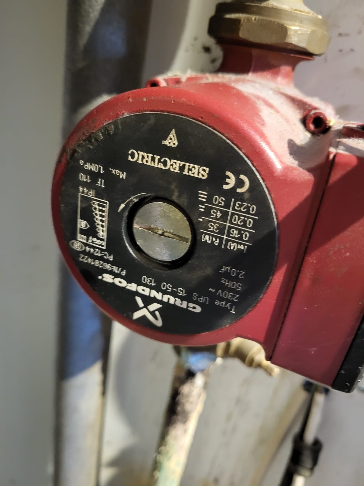

The screw that you used to bleed the pump is silver coloured,as said above removing it will expose the shaft ,so you can see if it is rotating.

Hi Terry, Is it ok to remover the silver screw? I dont want water flooding out of it. Also the short stub. I have lessened it but im worried about opening it too much in case it starts a flow of water and i cant get it back in. Is it safe to screw it out altogether?

Best done when the system has been off and cooled for a while. Yes the screw can be removed from the pump,water will come out ,more of a trickle,so have large towel on hand. The short stub should not have it's screw removed ,just loosen it . Air will come out if present ,followed by water ( rather like bleeding a radiator).

I started to take the big screw out but its ****ing water so i got cold feet lol
