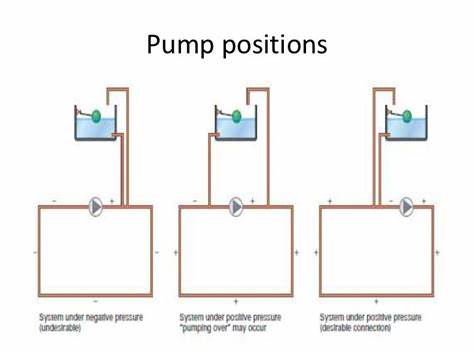

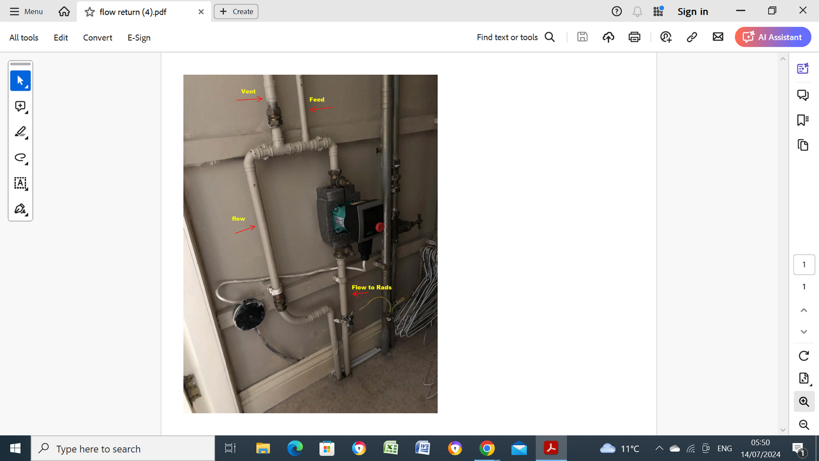

The suggestion is to tee in the cold feed into the pump (red pipe) inlet, then remove the next (blue) section of piping and cap it just above where all the returns come back, you will then have the traditional (from the boiler) Vent, Cold feed, Pump, VCP system, the distance between the vent and cold feed should be less than 150mm, the up-and-under (or under and up) refers to where you tee in the cold feed, just bring it down a few inches under the pump inlet and then loop it back up into the inlet, system 3 gives a idea of the VCP system.
Also, a screen shot of a VCP system but the cold feed was not carried up and under.

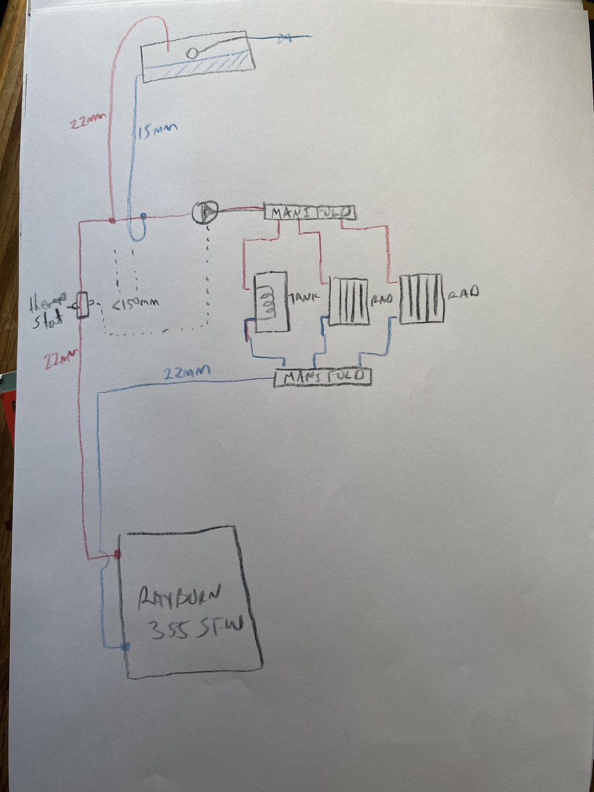

See attached schematic I drew up from the various comments. Is this more or less what is being suggested?
One question, can this circuit thermosiphon? I currently have the thermostat up near the header tank and pump in the loft, and the water rises up when the fire starts which activates the thermostat and starts the pump. I presume in the proposed circuit the water will not thermosiphon and so the pump thermostat needs to be down directly next to the rayburn?

Schematic is correct.
You should still get thermosiphoning even though the primary flow and return are normally 28mm in a solid fuel system, also the pump is on the same circuit which will also restrict the thermosiphon, the HW cylinder is normally used as a heat sink in the event of a power outage/pump failure and the system is normally plumbed somewhat like my schematic, if the stat is fixed in place then you can get a pipe stat which straps onto the pipe and locate it much closer to the boiler, also suggest, if not allready done so, to use pipe insulation especially on the boiler flow pipe to help the thermosiphon effect.
Should also have said that horizontal pipe runs have a big effect on thermosiphon circulation, the cylinder is located as directly above the boiler as possible.

Will the thermosiphon still work given the return loop is through the pump?
Also, if I plumb the tank so it thermosiphons and is a heat sink, then presumably it will not thermosiphon when the pump turns on and directs water through the radiators. It looks like people solve this issue by using an injector tee or are there other ways around this?
Nathan
It will have some restrictive effect but not huge, I have seen a number of systems with the pump either on the flow or return with no big problems, the horizontal pipe runs (see above) will have a far greater effect but by installing the (a) stat close to the boiler and setting its SP suitably after firing the system then should work but your system certainly does not seem to have been designed by a solid fuel genius, to say the least.
