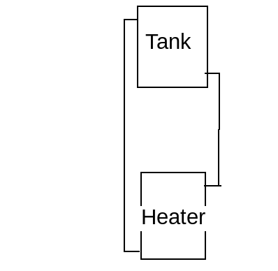

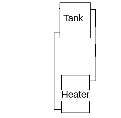

Flow to the top of the boiler, return to the bottom. Ideally you'd have the same on the radiator.
Yes, it needs to thermosyphon. If you rely on a pump, and the pump stops operating for whatever reason, you will have a potentially dangerous situation which could lead to a steam explosion.

So at a very basic set up of no radiator; which one is plumbed up right
