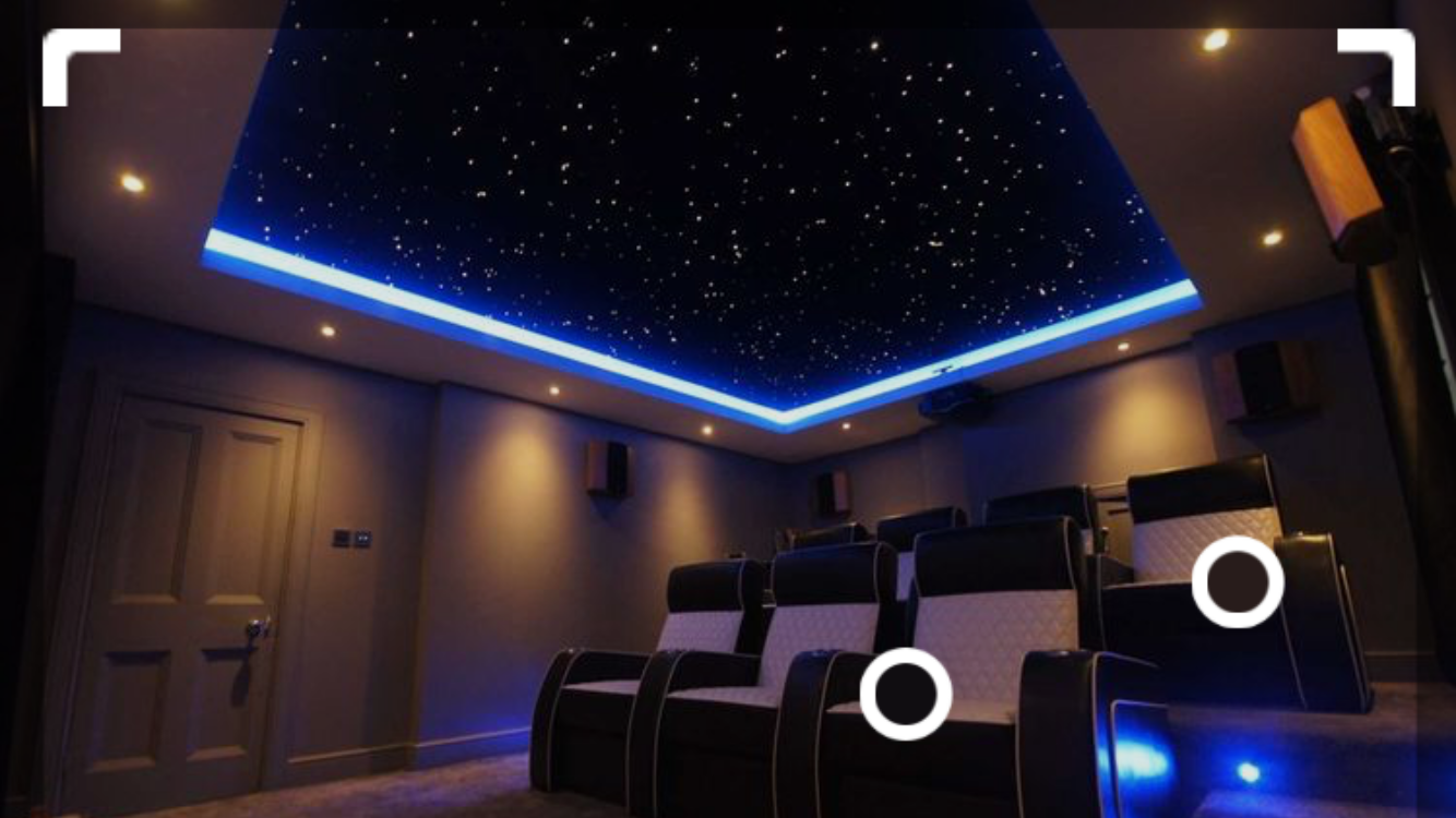

Making a budget version of this ceiling:
From this:
Would 3x2 screwed up into the 8x2 joists give that effect or does it need more than a 3" drop?
I’d guesstimate on the first pic that’s a 6” drop. But any drop will be noticeable.
Are you thinking about downlighting around the edge just like in the pic? Just wondering how much recessed middle you are going to have.... what’s youre room width? 8’? Length? The cinema room looks quite big and square in proportions.
Yes, downlight around the edge, I was going to do that 600mm wide.
The room is 5x2.8 so the 3" might suit it.
You going to do the led strip light too? If so, tlc electrical do this and a swanky aluminium profile to hide the led tape. I’m doing that around my roof lights..... blatantly stole the idea off another forum member as his looked so good.
Have a look on avforums.com there are lots of past examples.
I'd have thought you'd want a bigger drop than 63mm though.
From the video it look like they have done 8-10".
Wow!!! Imagine a penny less tramp did the same, that's what I'm aiming for :LOL:
I do like that star ceiling though, nights have to see if I can sort something like that out.

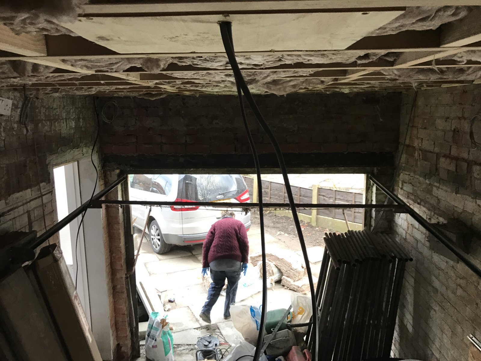

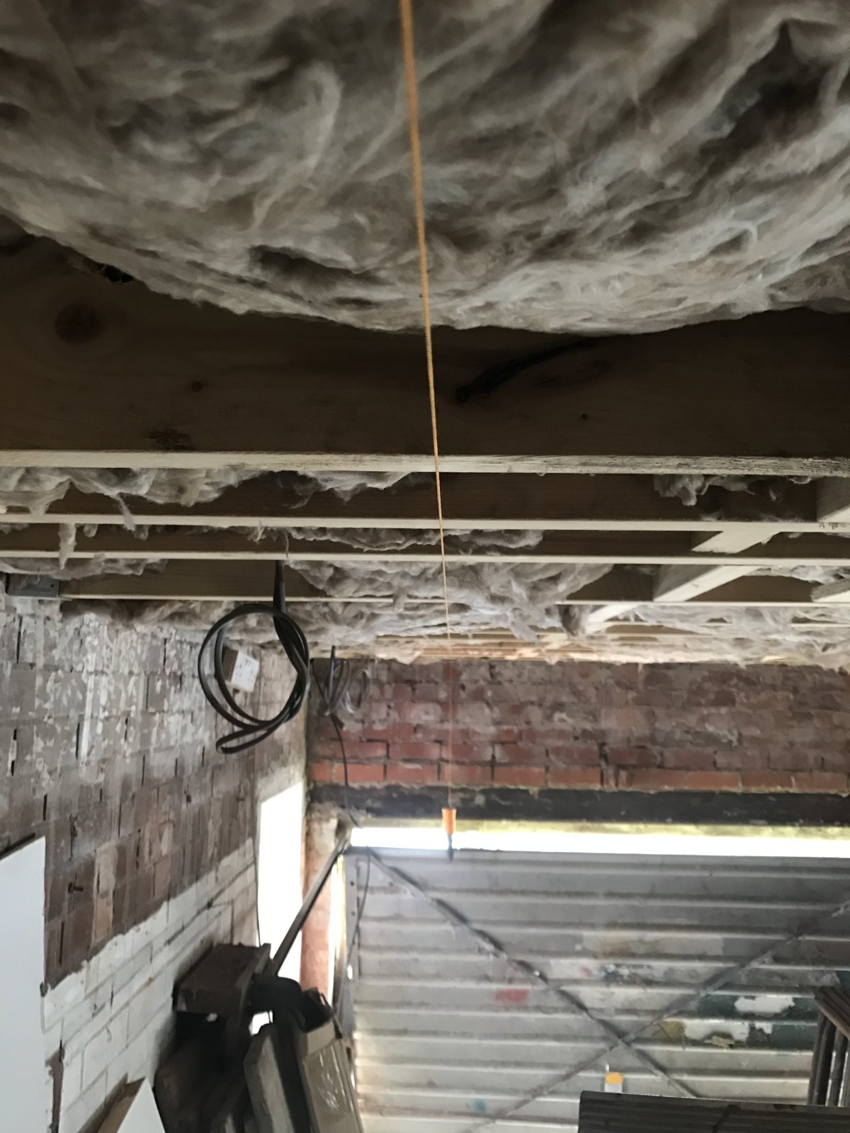

Here's mine after the first day, piece of string:

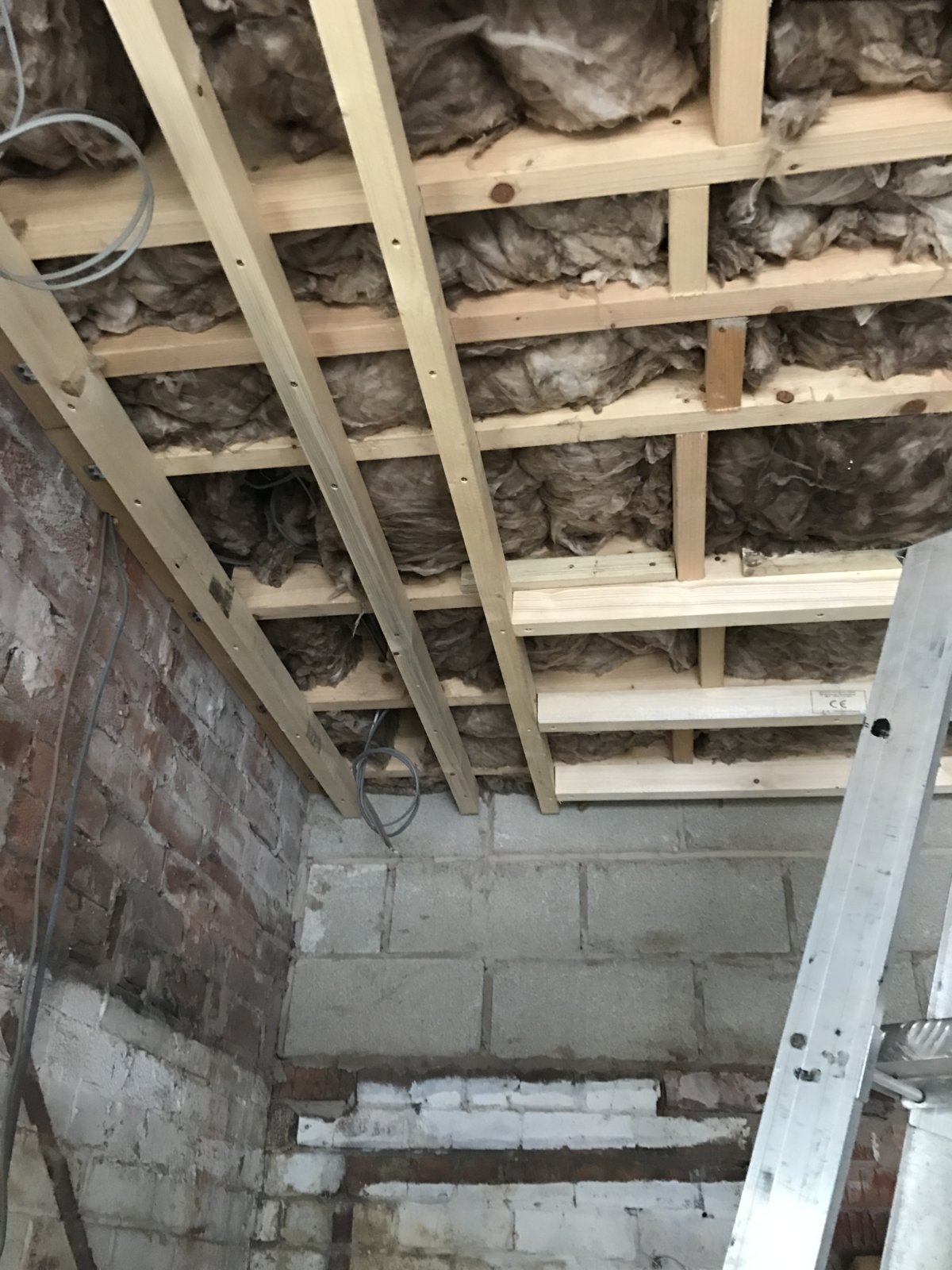

Some wood:

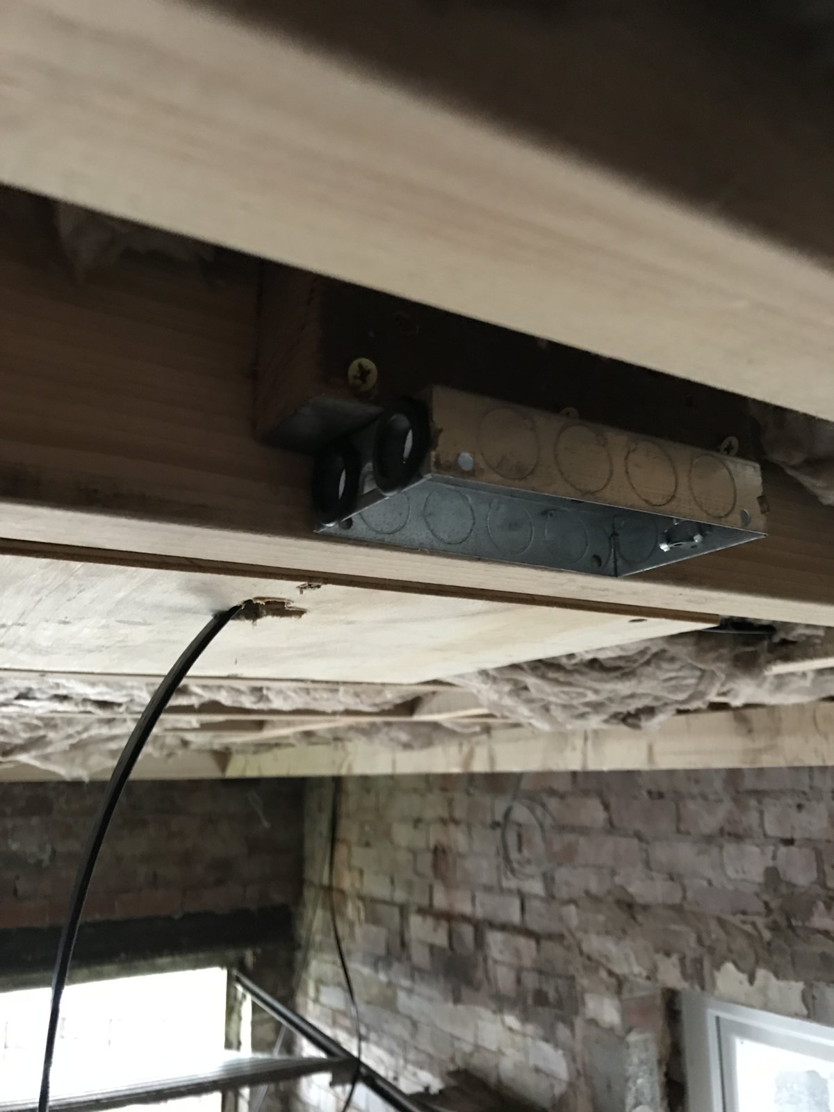

A back box and HDMI cable:
I've ordered a cheap USB powered led strip that I was going to feel through with the hdmi cable but yours sound nice Pilsbury, I'll google them :)
If I had watched that video this morning I would have spaced the wood down another 3" :(
