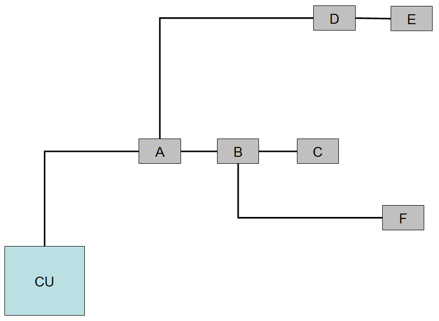

Grave error.
A radial circuit is not, not, NOT a single cable running from the CU through every socket.
A radial circuit looks like this:
A & B could be sockets or JBs.
