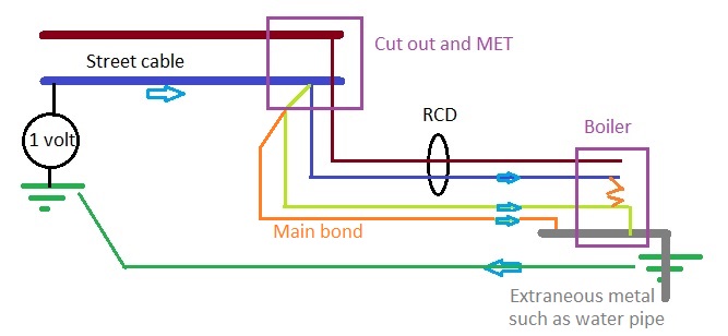

In most cases that is true but there can be situations where there is current in the Neutral and nothing in the Live that will cause the RCD to trip.
It will occur when the network Neutral is a volt or two above ground and there is a Neutral Earth fault in an appliance that also has metallic connections to ground. It could also be a Neutral to back box fault where the back box in a damp wall close to ground level.
The majority of the current will divide and flow through the Main bond ( orange ) and the appliances CPC ( light green ) returning to the sub station via the ground ( dark green ). Some however will flow through the RCD on the Neutral, then through the fault to ground via the extraneous metal and back to the sub station. If the fault is a dead short then each path ( Neutral, CPC and Main bond wll each carry about 1/3 of the current.
