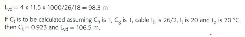

Yes but they are all around 0.004. Certainly a lot higher than 0.0017 (for 0.923 Ct)
Right, at last I think I am starting to understand :) ...
Given the parameters that the book example indicates (13A in each leg {b}, tabulated CCC = 20A {It}, Ca-Cg=1, and max conductor temp 70° {tp}), the 0.923 figure for Ct is, indeed, correct in terms of Equation 6 in 6.1. of Appendix 4.
What we have been missing is that, whilst we have all been applying a correction factor for determining VD at tp (i.e. 70°), what Equation 6 is trying to do is estimate the required correction to VD for the actual temperature which will be reached with given values of Ib and It. For example, with everything else unchanged in the Example, if It were 27A (i.e. Method C), rather than 20A, then (per Equation 6) the estimated temp rise would be less, and hence the estimated Ct would be lower, hence VD (adjusted with that Ct) would be lower.
In concept, that makes good sense - why determine VD at 70° if a cable is so lightly loaded (in relation to its CCC) that the conductor temp is going to be far far less than 70° (i.e. if Ib<<It)? However, the equation is attempting to achieve that estimation of temp rise by including the term (Ib²/It²), and how well that really works I'm not sure. Given the apparent lack of 'precise science' in relation to the tabulated CCCs (i.e. It), with suspicions about the addition of 'safety margins' etc. (and, in the past, suggestions of changes for what might be called 'political' reasons!), I would definitely have my doubts.

Also, how does this come to 0.923 when they are using the usual 20 to 70°?
I don't understand what you mean by "the usual 20 to 70". Whilst tp (=70) comes into the equation, as above, ambient temp does not. In terms of the parameters which exist in their equation, the 0.923 figure is correct.

Ah. I may have confused the 20 as 20° but I don't think that makes any difference to my question.
The top line is using 18 which relates to 70°, but then it says to calculate Ct and get 0.923, they also quote 70°.
Ah. I may have confused the 20 as 20° ...
Yes, the 20 is It - ie. they are talking about a 'just-compliant' ring final with a CCC of 20A.
... but I don't think that makes any difference to my question. The top line is using 18 which relates to 70°, but then it says to calculate Ct and get 0.923, they also quote 70°.
Yes, but as I have explained, although one has to put the maximum conductor temp, tp (=70°) into that equation, since Ib is less than It, it is trying to work out what conductor temp would actually be obtained - and, since that would be less than 70°, results in a calculated Ca less than 1, indicating that the VD would be less (with that Ib and It) than it would be if the cable were 'fully loaded' (Ib=It), and hence assumed to reach 70°.
If the cable were 'fully loaded' (Ib=It) then that equation gives Ct=1, which is what you would expect, since the conductor would (maybe - at least 'is deemed to'!) reach 70°, so the tabulated figure (for 70°) does not need any 'adjustment'.
Put another, perhaps simpler, way - the tabulated values of mV/A/m relate to a cable loaded to its maximum tabulated CCC, and achieving 70° as a result. With any load less than that maximum tabulated CCC, the temp will be lower, hence the mV/A/m less than the value tabulated (which assumes 'fully loaded', hence 70°).

Right - scribbling done. I actually make it about 104.3 metres. As I said, it's not a trivial calculation - so are you sitting comfortably .....
I will assume that the "12A evenly distributed along the two legs" is equivalent to 6A at the middle of each leg (i.e. a quarter of the total ring length from the CU).
Of that 6A, 4.5A will travel by the 'short route' and 1.5A by the 'long route'. The two 1.5A 'long route' currents (one from each side of the ring) travelling in the two 'middle quarters' of the ring will cancel, since they are going in opposite directions, and therefore will have no effect on VD.
Considering just 'one side' of the ring, the current in the half of that leg (i.e. quarter of the ring) more remote from the CU will just carry 10A (half of the 20A load at the centre of ring) (the two 1.5A 'long route' currents having cancelled). The current in the half of the leg closer to the CU will carry 14.5A (10A from central load, plus 4.5A of the 6A load on this leg, plus 1.5A of the 6A load on the other leg).

No-one has jumped on me yet, (despite the passage of best part of 24 hours), but I've just spotted the flaw myself!
There was clearly a fundamental flaw - since, with my calculations, whilst there was clearly a total of 32A worth of loads, there was only 29A coming out of the CU!
Whilst I still think I was correct in saying that the two 1.5A currents ('taking the long route') would 'cancel' in the two 'middle quarters' of the ring (so each just carried a net 10A - half of the central load), what I had overlooked was the fact that the same is not true in the two 'outer' quarters (the ones connected to the CU), since each of them carries the 1.5A 'long route' current from the other side of the ring. The current in those two 'outer quarters' is therefore (as I should have realised it had to be!) 10 + 4.5 + 1.5 = 16A - i.e. half of the 'central 20A load' plus 4.5A of the 'short route' 6A load on 'this' side plus 1.5A of the long route' 6A from the other side. My final expression therefore should have been ...
L = (11.5 x 4) / (26 x 0.018) = 98.3 metres
... which, of course, is exactly what 'the book' (and others) say (but I still don't know where BAS's 24A came from), and it is the temperature correction of that which takes it up to around 106 metres ('around', since it depends upon exactly which correction factor one chooses!).
