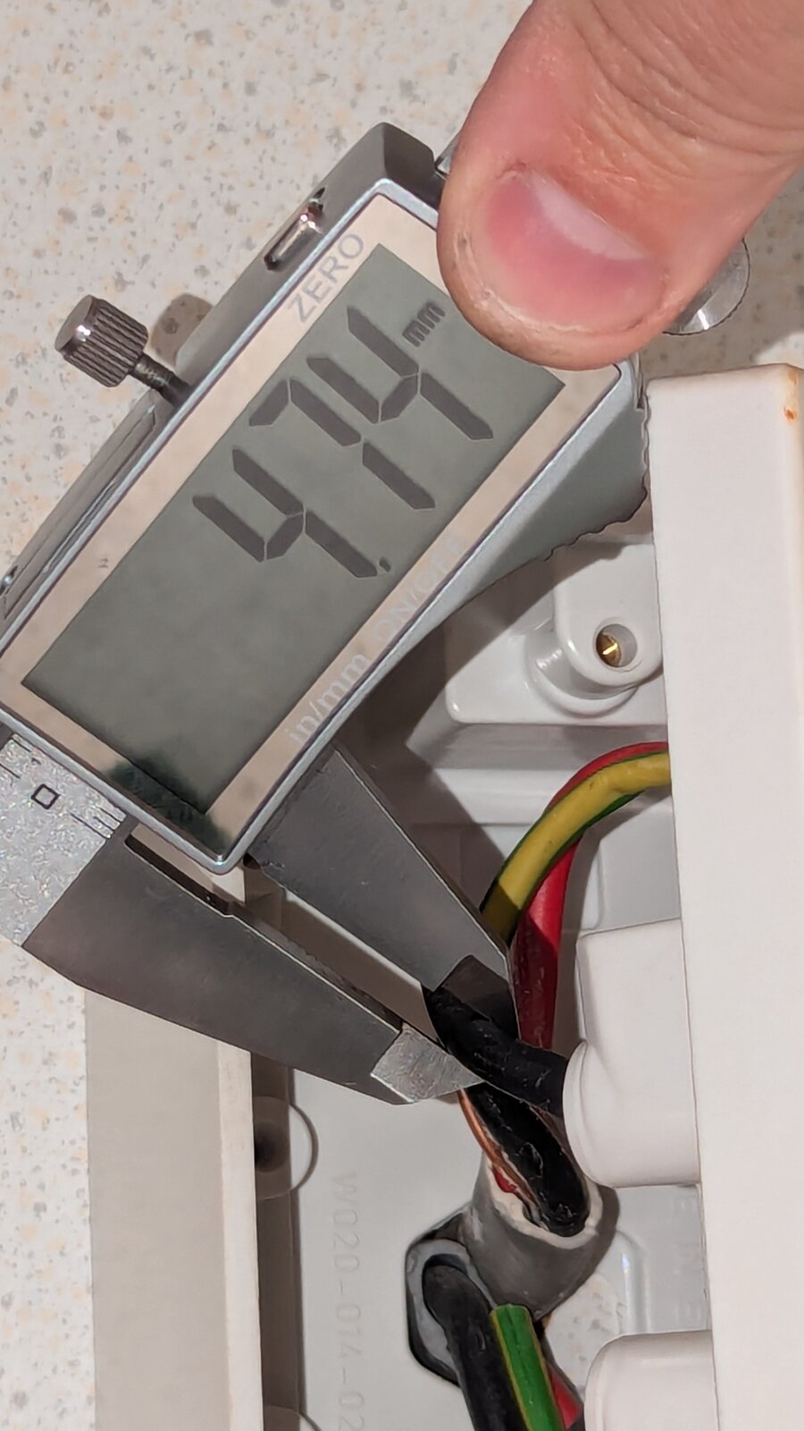

Thanks. Does cable length factor into that? Its (very approx) 25m long. It does not go through insulation for the majority of the run, just perhaps 2 metres or so of 100mm rockwool type stuff.
I'll power off the circuit this evening and pop the cover off the isolator and take a look to see if it is 4mm or 6mm. Nobody has checked, we've just assumed as the breaker / rcbo is 32amp.
Not unless it is very long.
That would have an effect of reducing the current rating but as only 22A is the circuit requirement 4mm² might still be alright and 6mm² definitely would be.
I presume you have been using a cooker or oven and hob until now with no problems.
Ok.
6mm² was required for a 30A rewireable fuse and people still use it from habit but since 32A MCBs/RCBOs took over 4mm² is fine.
Well well, looks like 6mm² cable after all?

Hi again. Electrician saying diversity for an oven and hob on same circuit is hard to justify, as they're frequently operated together. Also that "12000 / 230v gives approx 52.2 amps, therefore 6mm cable not suitable under any installation method, as max current is 47A, even before derating to 35A for being in a wall/conduit and not clipped".
AS they're the one signing off I think I'm going to have to get a new 6mm or even 10mm circuit put in "10mm flat cable max current for ref method c is 64 amps, and for ref method 102 is 47 amps".
Has he ever heard of a 'cooker'? An oven and hob in one and what the label on the circuit breaker states.
Well, the ratings will be quoted at 240V, at 230V the Wattage will be less - but that doesn't make much difference.
As I have shown you, the design current of the circuit is 22A.
I don't blame you for being wary but the system has been in use for decades - and works.
35 is more than 22 so fine.
