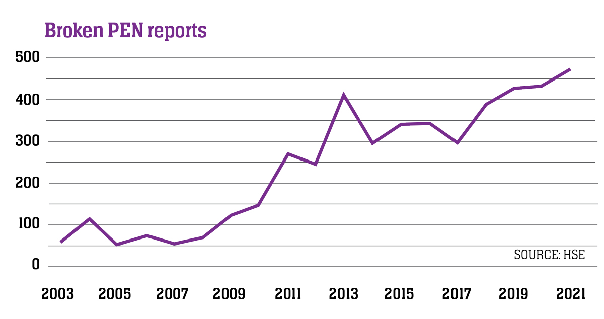

Kerbside charging is a real problem due to the loss of PEN problem, not so much of a problem if charged away from general public, and no problem when charged in a garage.
There was a number of publications about this this one highlights the increase of loss of PEN and this one says how the HSE has refused to act it is an on going saga, and it is just a matter of time before government is forced to act. The problem is when governments do act, it is likely to be a knee jerk reaction. And likely they will go OTT yet again, this is what they normally do.

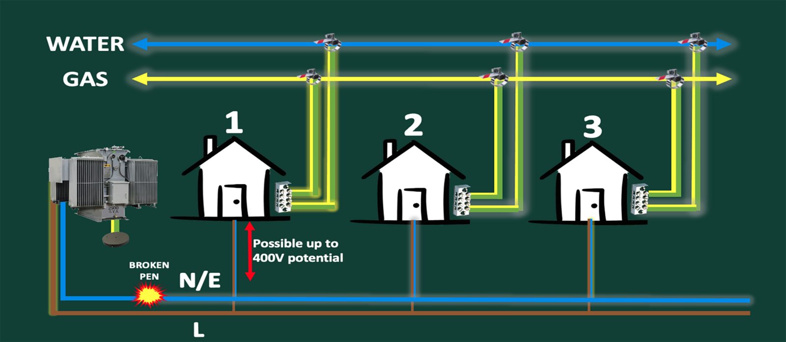

As I'm not an electrical engineer, would you please explain the circumstances in which a reasonable person, charging their EV in a reasonable fashion, realistically risks being electrocuted?
i.e. not sticking their keys into the outlet, or hacking at the cable insulation.
CNE conductor in the supply is damaged (also called a PEN conductor by some).
This results in all earthed conductive items becoming live, which includes the metal parts of a connected vehicle.
It's an unlikely event, but dangerous when it occurs, and a single break can affect multiple properties.
A few 100 incidents per year, out of 10s of millions of properties.
To be fair number of injuries caused as a result of loss of PEN lower than number of times it has been lost, however it is the raising trend which is the issue. In the main due to copper theft and road works. And the main concern is gas supplies bonded on the wrong side of the insulating block or block missing and the gas pipe melting and setting fire to the gas.
The hope is the homes are even loaded, if it is then even with a broken PEN the voltage will not vary much, but with a three phase supply one of the phases will quickly go out of limits and switch off the EV supply, but with a single phase supply it can remain connected some time, and even turning off the main isolator although it will save equipment, it will not remove the shock risk as most isolators do not switch the earth.
