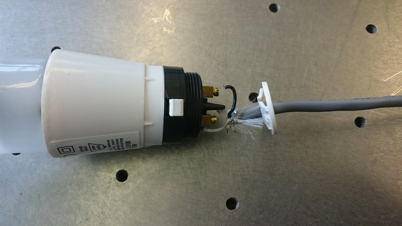

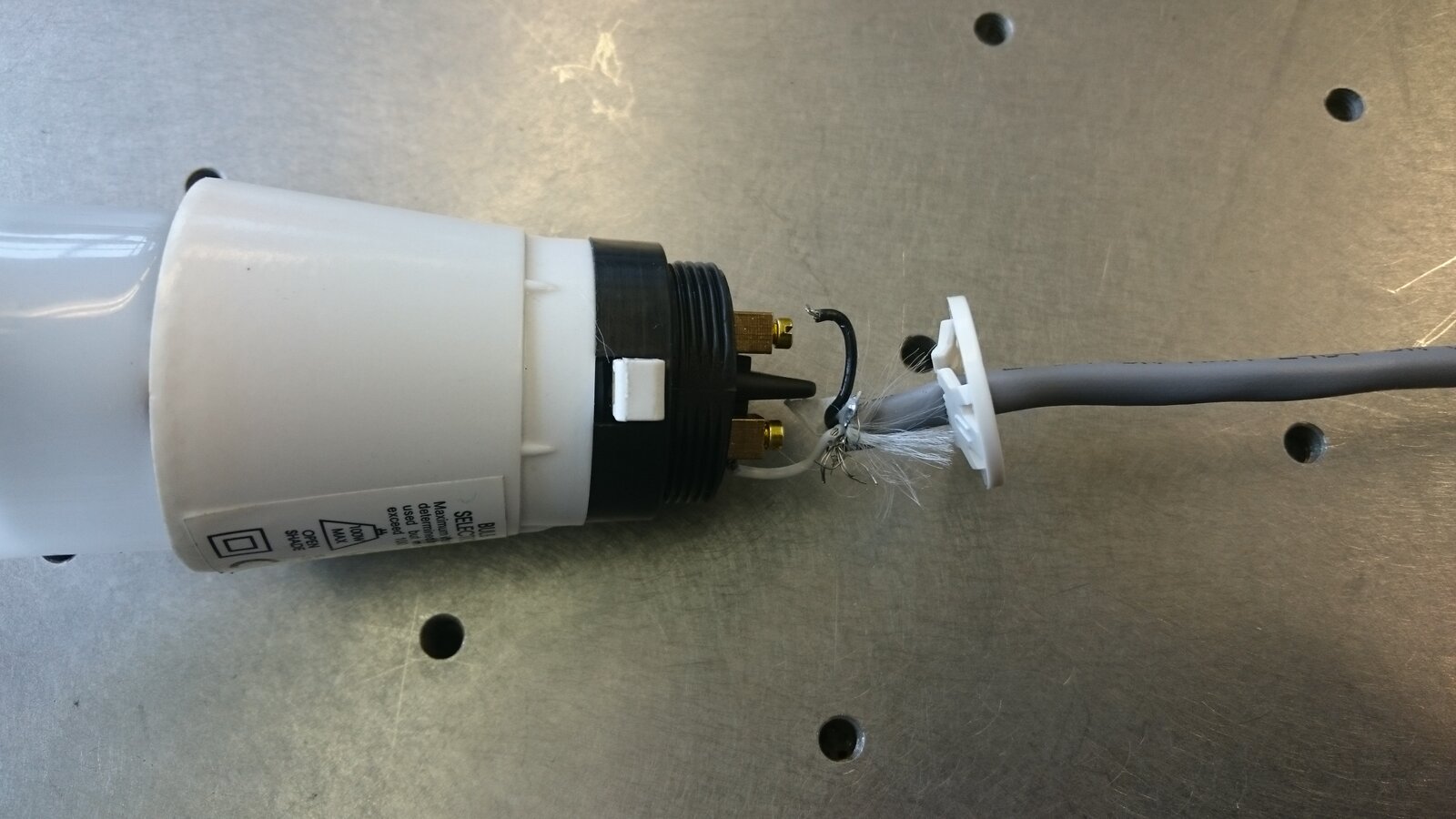

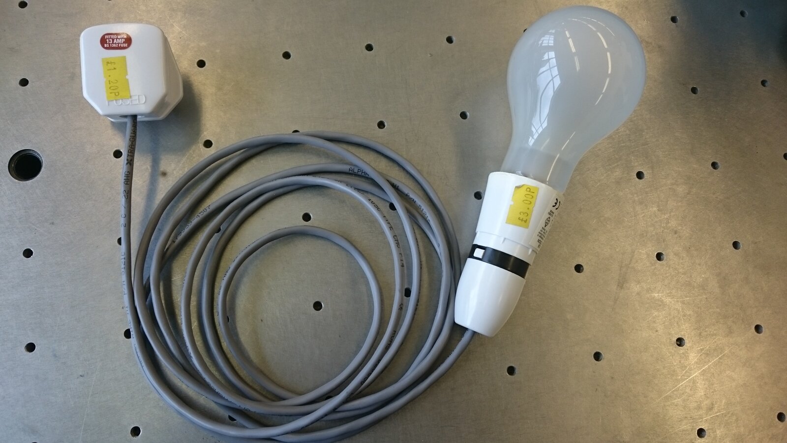

Failed PAT
I've just been going through some of my archive! :)

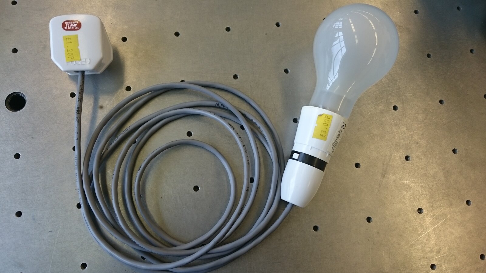

How about a 200W bulb and some network cable!

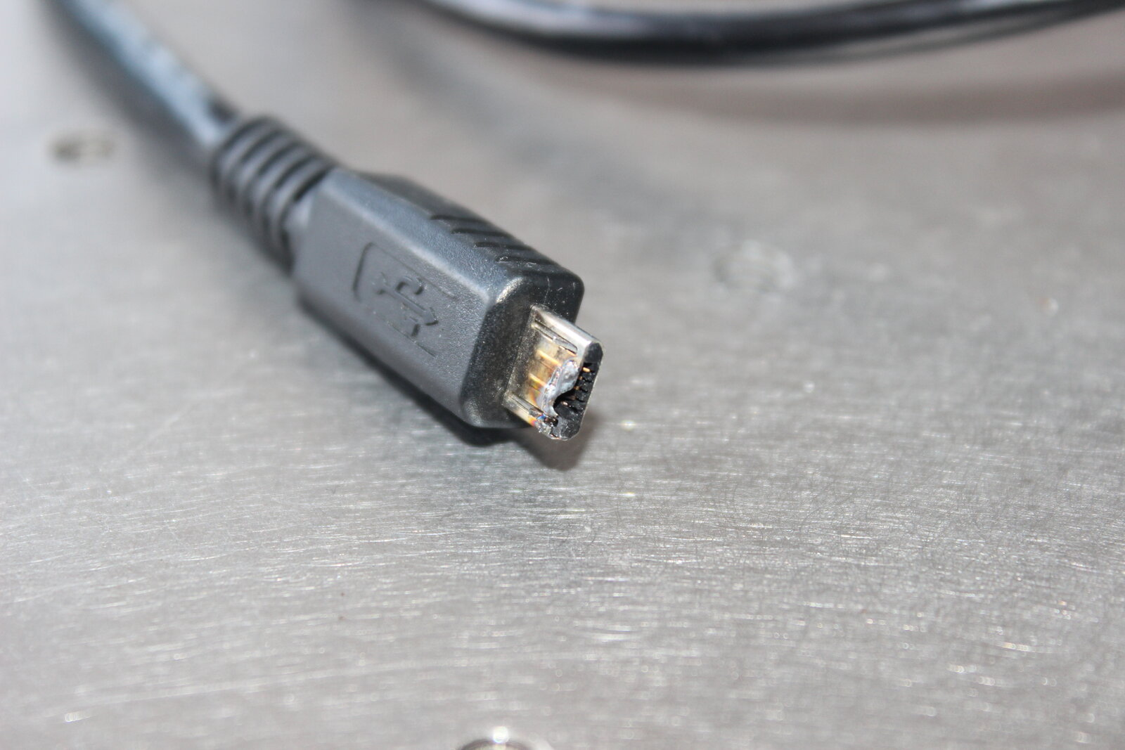

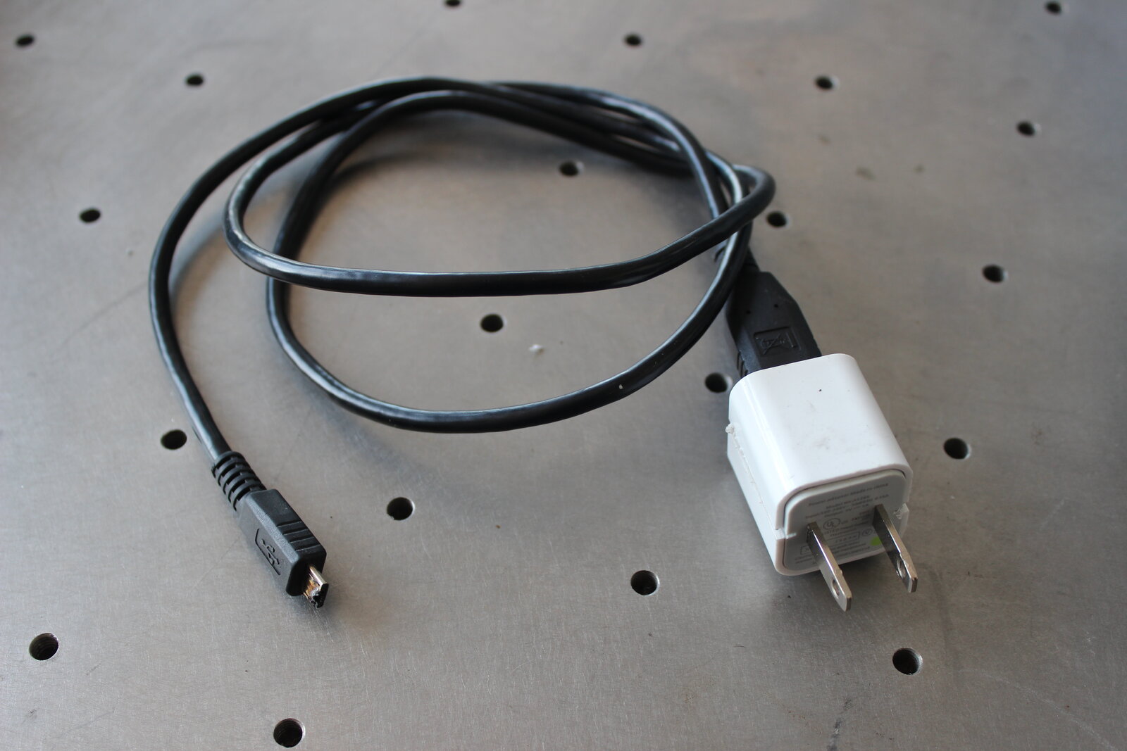

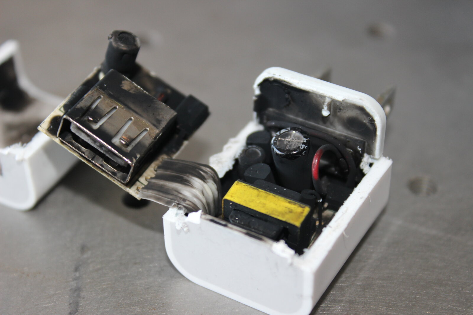

...A fake 'Apple' USB PSU exploding when the cable touched an earthed optical bench.
An Apple laptop PSU. Although it was on the ELV side, the arcing damage was quite severe!

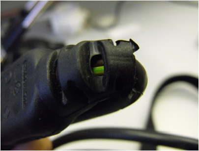

...And we had a whole batch of computers (100's) supplied with cables like:
The cable wasn't fully molded onto the connector. The fault wasn't initially found.
It took years to find them all after they went into service!

I purchased a load of those too, it was 24x 6 & 10m IEC extension leads for stage lighting. I was never sure if they were like it new or if the cable had pulled/shrunk but every one was like it, one end or the other.

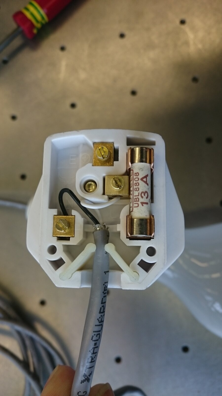

What got me was the really poor wiring that pulled straight out from the terminals, the shielding flapping around in the bulb holder and the 13A fuse!
This all from people who develop space instruments! :)
...and the butchering of a decent length high quality network cable, when reels of appropriate flex was available, if only they had asked!
