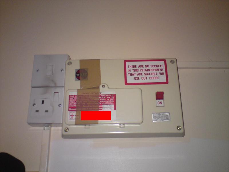

OK, so being a 1 bedroom flat what if I use a single RCD covering the whole installation and install an emergency light in the hallway, where it can be seen from everywhere (glass doors).
BTW the wall the FCU is on is 760mm from the edge of the bath. Am I OK to install an FCU there? As I understand it that is outside of zones.
Oh and whoever said it looks like a blank plate not a flex outlet, you were right. The flex exits through a knockout in the backbox (no grommet of course).
Colin C
if you have a fixed neutral to earth fault you are gonna be pretty annoyed at not spending some extra cash on some RCBOs when the three hours of 8w light runs out.
- There are no RCDs at all, so that doesn't comply with current regulations, and didn't comply when it was installed either.
:?: Under the 16th the only things that had to be on a RCD was sockets likely to supply things used outside. As this is a flat (unless it's ground floor of course) then it's easily plausible that no RCD protection was required when it was installed.
You're right about the rest though.
I reckon the best way for a small installation like this to meet the 17th RCD requirements is to use a a single RCD slip-load CU, with the lights on an RCBO.
An awkward argument there, when the sky 'engineer' arrives and you plug his extension in then that isnt protected, when you run an extension to vaccume the car, that isnt protected. Even if some are RCD protected then that doesnt stop the person with a faulty appliance or ext lead in plugging into another socket that doesn't trip out, therefore all sockets with the exception of ones behind fixed appliances should be RCD protected. Thats my interpretation of the reg mind.
