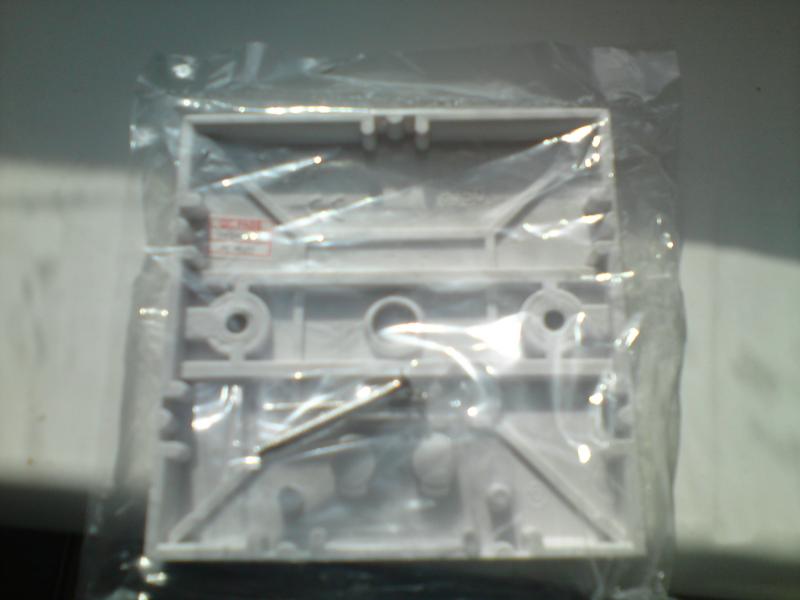

don't blank plates usually come prepared with notches that can be removed for allowing a flex through?
Usually not - they are just plain bits of plastic.
IMO, probably better suited than a Flex outlet plate as the cable comes from the bottom, not the middle
Some flex outlet plates are like that, e.g. MK K1090
blank plate with notches and even a knockout in the centre should you wish to use it. (not MK)
Adding strain relief as appropriate should be the simplest of tasks for a decent spark. sorry bout the rubbish photo.
Or a manufacturer saving costs by selling just the faceplate part of a flex outlet on its own, to be used purely as a blanking plate?
possible, but i don't think so. There doesn't appear to be any provision in the moulding for any other parts to be attached
A blanking plate is a blanking plate
and
A flex outlet is a flex outlet.
The work involved in making that blanking plate into a flex outlet proves this.
No strain relief
No connections
Possibly that centre hole is for making TV sockets by the manufacturer.
And the very shallow knockouts round the edges could be used with a flushed in box for fixed surface wiring, something like BT wiring.
