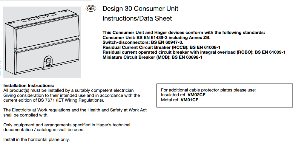

A lot (if not all) do say 61439-3 and Annex ZB plus other conditions.
Note the bottom line of this capture - although everyone has probably forgotten that bit of the thread.
I can't find any technical documentation.
Thanks. I must say that I don't recall having noticed the 'including Annex ZB' bit in any I have looked at - but maybe that's a memory problem! As I said before, I presume this implies that the devices are <16kA, since if they were 16kA, there presumably wouldn't be a need to do a 'conditional' 16kA test. In what you posted, there is no mention of the breaking capacity of the devices - unless that is implied by the Standards cited in relation to the various devices.
That is also very interesting, and I wonder why they say it? Given that I imagine that the same devices (other than the main switch) are probably used ('horizontally') in 3-phase boards, I suspect that it's not them that result in that instruction. Is it perhaps about the IP rating of the case (since 'top surface' requirements differ from the others)? At the start of the thread I did look at the instructions for several CUs, but found none which said anything about orientation, but I may not have looked at Hager.
All it states is:
As above, I cannot find the technical documentation.
Maybe they only do their tests (whatever they are) in the horizontal position?
Yes, that is probably the most obvious explanation, and the "why?" of that could be due to the fact that so few people will want to use them vertically. In passing, I recently wrote ...

Perhaps they feel that the lid will not self-close unless the CU is horizontal?
Yes, possibly - in fact, if you will recall, that was the one and only reservation I voiced in relation to vertical installation.
