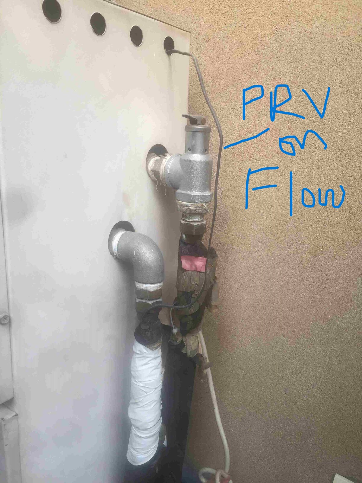

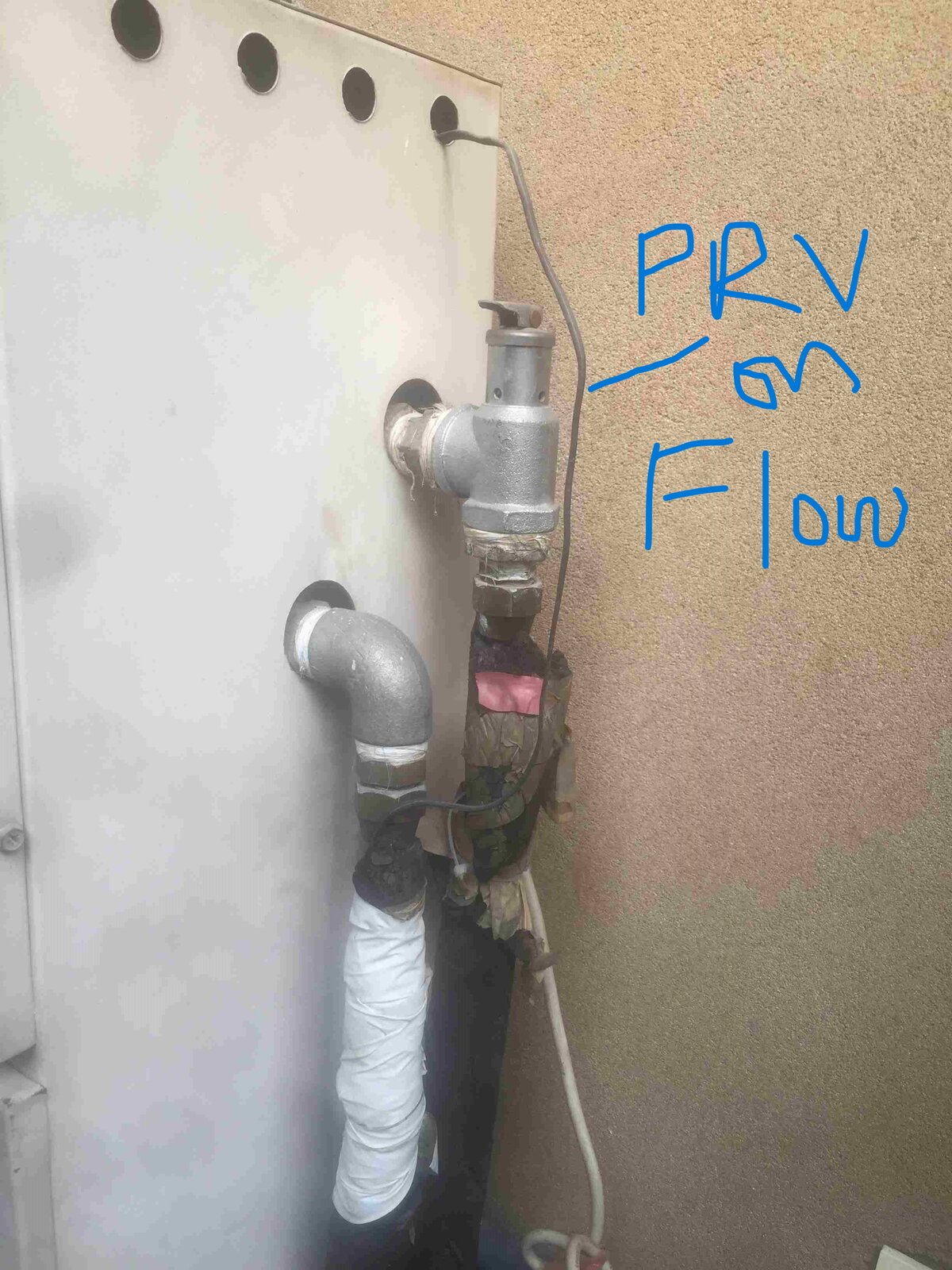

Yes, I have seen it in all reading material that I have gone through and wondered why I haven't got one. I looked at the old boiler and it has a PRV installed on flow pipe, I think I found the answer on NRV and combined vent & Feed in my pipework?

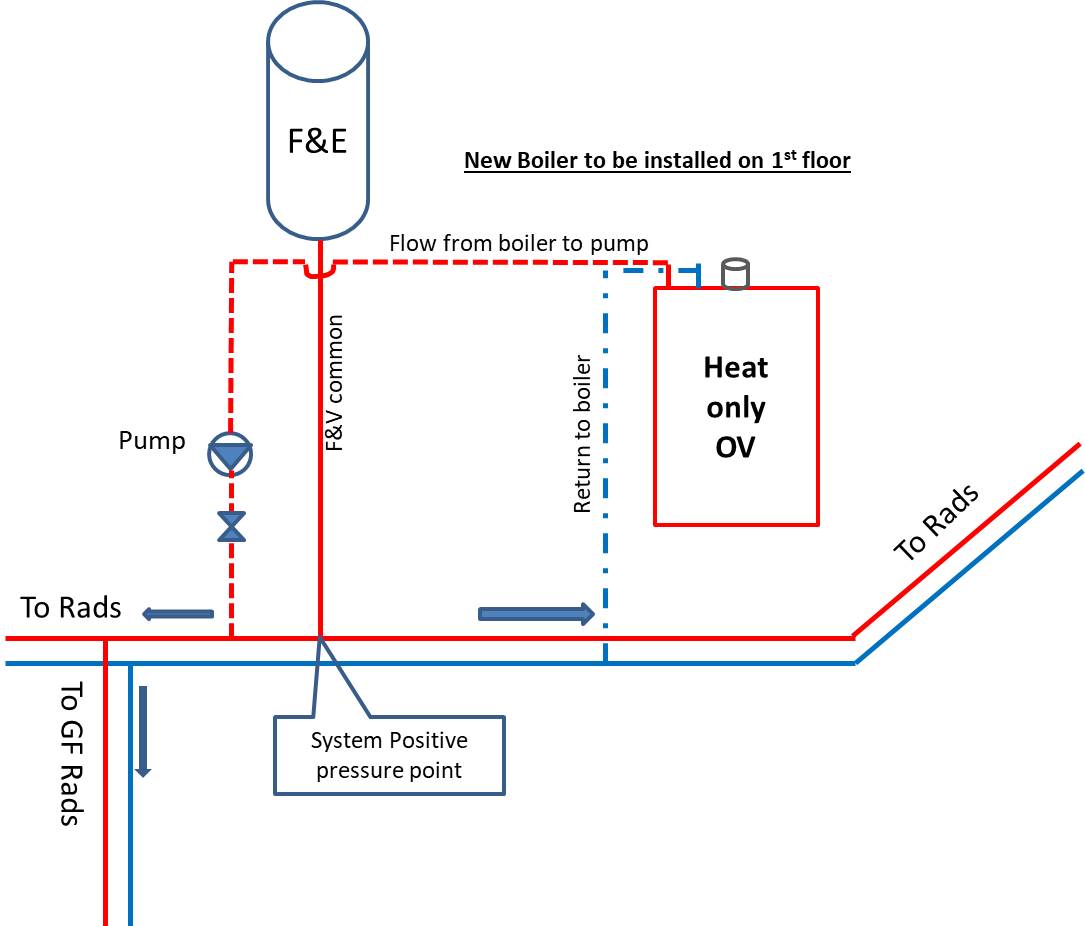

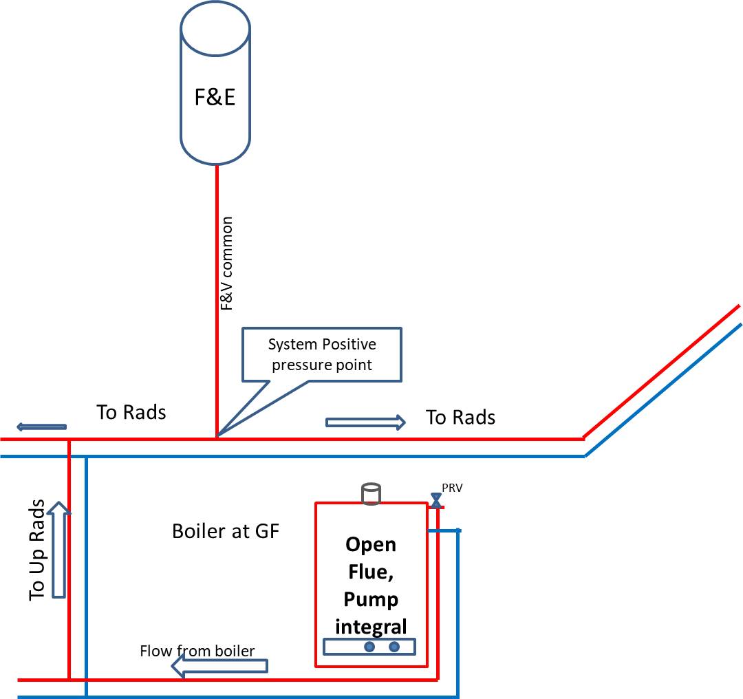

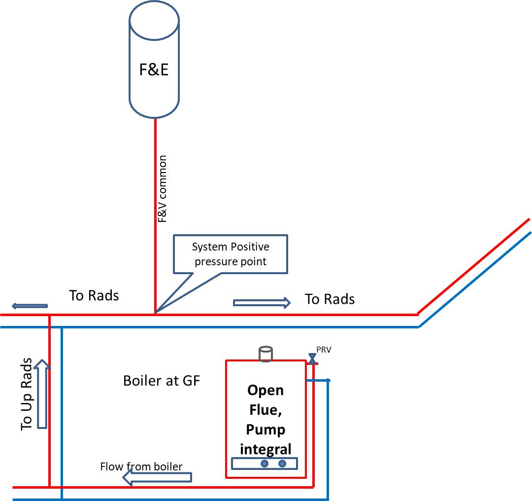

There is nothing mentioned in Viessmann manual in installing a PRV but if I remove the non return valve from tank which will serve as f&v (no separate vent pipe), would it be safe to install a PRV on flow on boiler? I have attached old setup drawing (1st photo at Ground Floor) and new boiler to be setup at first floor (2nd photo). In the new boiler setup there has to be no direct feed from head tank to flow inlet of boiler? The boiler HEX takes it water from flow pipes.
Please have a look and let me know if this is correct. Thanks

If you have a PRV then that would point towards it being sealed rather than an open vent but if it's gravity fed by a cistern that's open to the atmosphere then that would be more like an open vent system, all a bit confusing. Not sure it that's a US quirk. I think you may want to take it back to a standard to ensure everything works as it should, sealed or OV. You don't want any valves incorporated into the feed or vent or combined, as suggested though a combined isn't a standard, it's really implemented to fix issues/badly design systems that are drawing in air or pumping over.

you want to avoid having any rads in between the feed and vent and the pump, they will work but the system will need to be finely balanced.
Secondly, the return line to boiler will also be teed at the same positive pressure system point but on return line or it doesn't matter?
Not quite sure what you mean? anything prior to the feed and vent will be under positive pressure, it's only at the feed that it changes to negative. On a 2 pipe system then one pipe is the flow and the other the return so the return shouldn't have to 'tee' into anything, if you see what I mean. The only tee that would be incorporated would be the return from the cylinder, if and when it's added (apart from the feed and vent of crse)

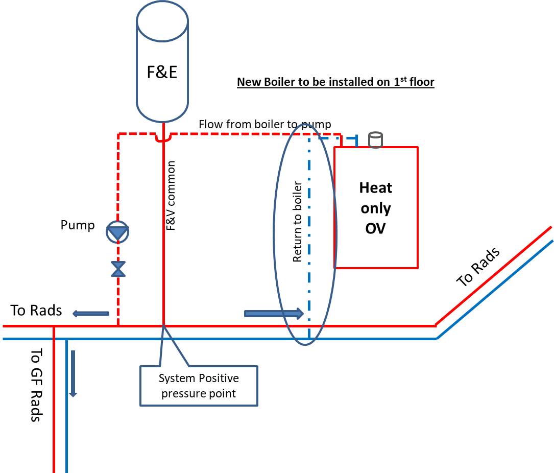

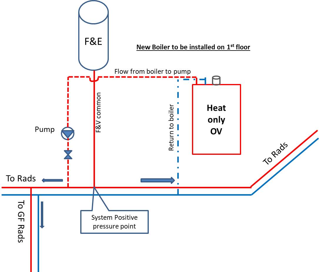

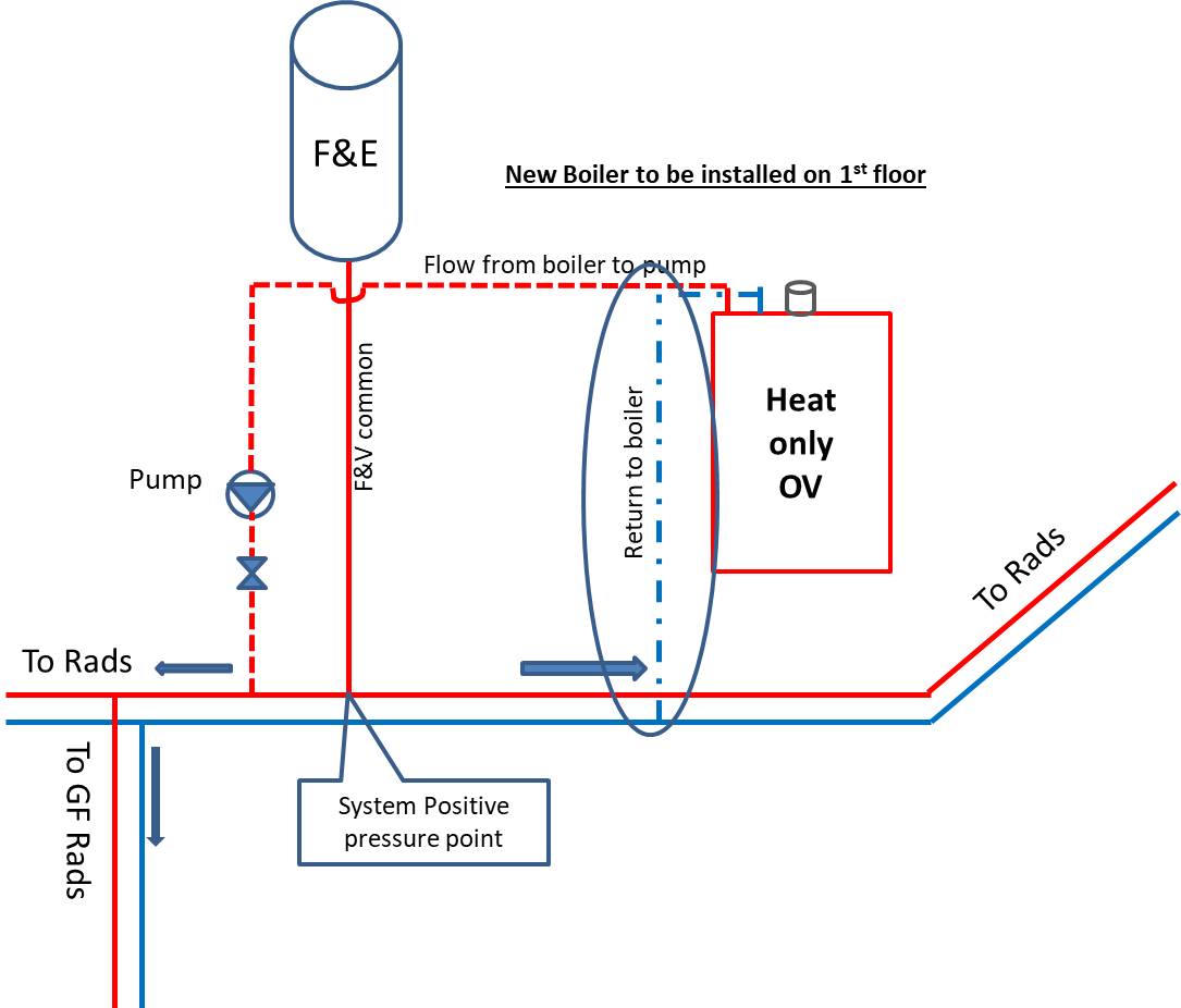

Thanks, extremely helpful comments. Sorry if this confuses you but I wanted to confirm the return piping connection to boiler (see blob in pic dotted path to return inlet of the boiler)

That's a very convolute design setup, I would recommend you look at it again and try and 'flow' the 2 pipe system a little more direct than that to make it as easy as possible to setup and maintain the system properly. In that pic it seems you are pumping towards the feed rather than the feed entering the flow prior to the pump, so not the best. That will take a very precise balancing exercise to ensure it all heats up properly.
As a starting point you would look at something like this for the feed (and vent), that way the only part of the system that's under neg pressure is between the feed and the pump.

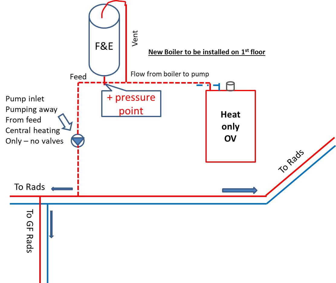

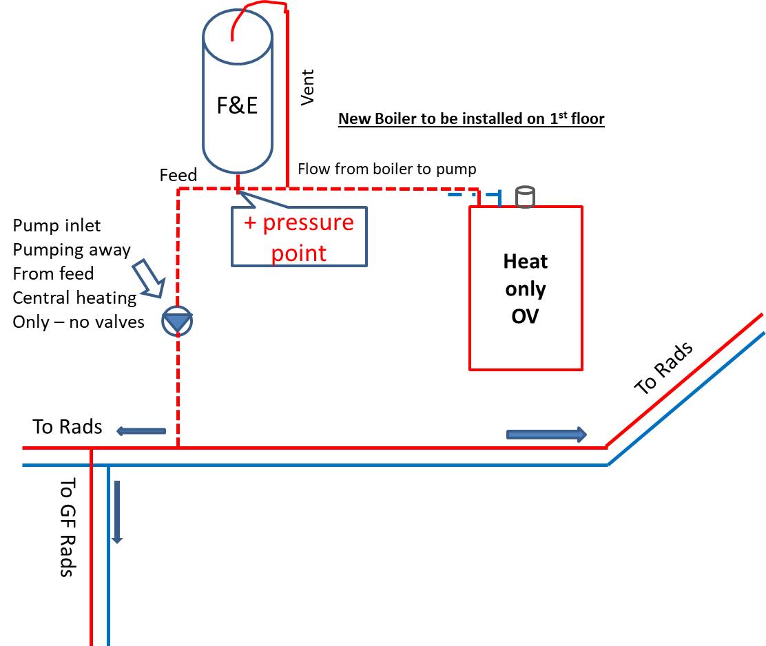

I am with you, not the best job with the drawing, sorry if it confuses you. To simplify it further:
- vent pipe added, Teed from feed tank
- feed point is Neutral point of the system.
- As you say the section between feed and pump inlet is under negative pressure
- pump location showing inlet to the pump; and is pumping away now (downward from feed)
- where do I add return line to boiler's inlet port?

In your Pic1, boiler with integral pump is a system boiler, and AFAIK always has an integral expansion vessel, so F/E tank not needed. But it's possible to use a F/E tank, in which case I believe the connection should be to the boiler return, which is as close as you can get to the pump suction.
In Pic2 the vent is not shown and the feed is in the wrong place. It should be as Madrab shows in #24

- Pic 1 is currently what I have in terms of boiler and pipework. The boiler didn't have an expansion tank inside it; F&E was placed over on 1st floo
Roger.
What about the return line to the boiler?

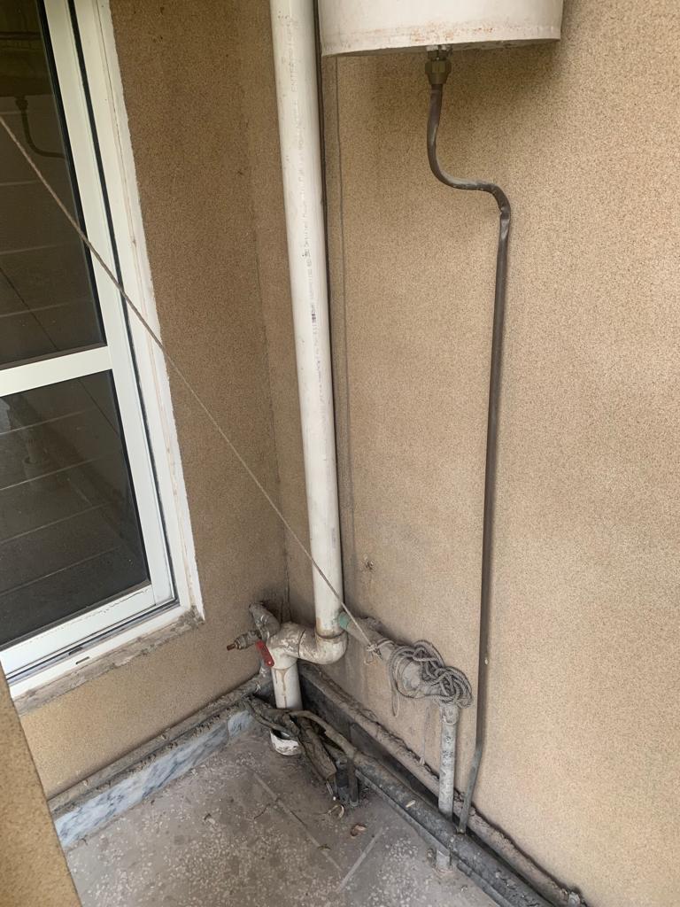

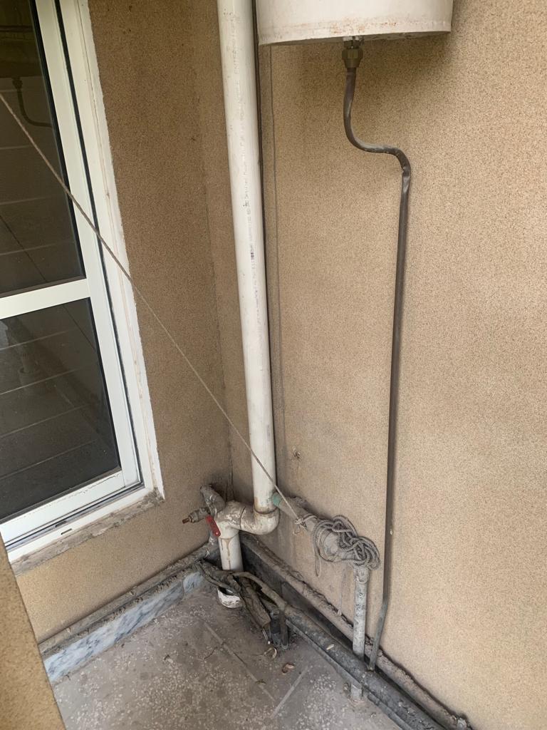

The part I wasn't clear about was do I need to change the existing feed to the boiler and other connections to existing pipework. see 2nd photo of the feed from tank to the existing pipework and how to make other connections to the boiler.
I will be removing the existing feed and will modify the pipework as per manual.

Boiler with pump but no exp vessel is a new one on me, but we live and learn! I don't know whether system boilers have the pump on the flow or the return, or some of each, but in any case I would put the cold feed on the return pipe, preferably close to the boiler. If you use a separate vent, put it 150mm or less before the feed (flow-wise). Where it's shown there is a chance of getting negative pressure at some point.
It's shown on Madrab's #24. I agree with that.
