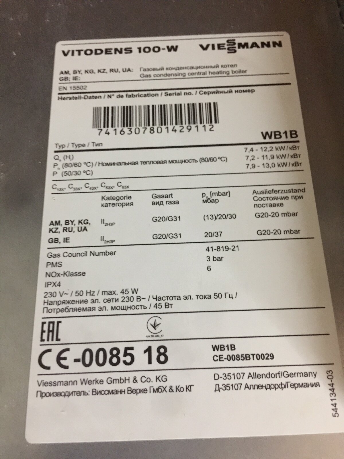

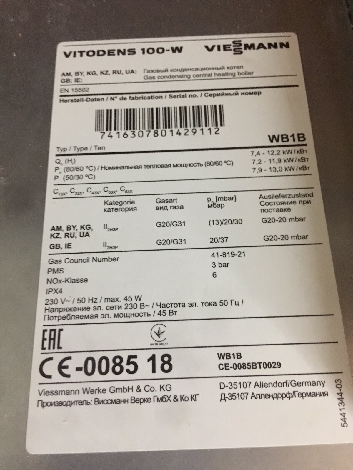

Can you give us the GC number off the boiler data plate - should be 41-819-xxx, that will allow an exact spec to be looked at. Some of them actually ask for 0.2bar as a min head (2m), that will be for filling/air purging purposes no doubt. So as long as there is enough head to purge the system then fine.
Sure.
OK ... Page 20 of that boilers manual - Open vented heating system: The static head must be at least 0.2 bar.
101-w Compact
So ultimately that boiler's looking for 2m head, so ideally the cistern should be 2m above the system so the open vent would be another 450mm above that again. That is will be to ensure that the system can be purged of air easily so if you don't have that height then as high as you can get it will have to do. The min height of the vent, again, will be to avoid any water being pushed up and out of the vent when the pump kicks it etc.

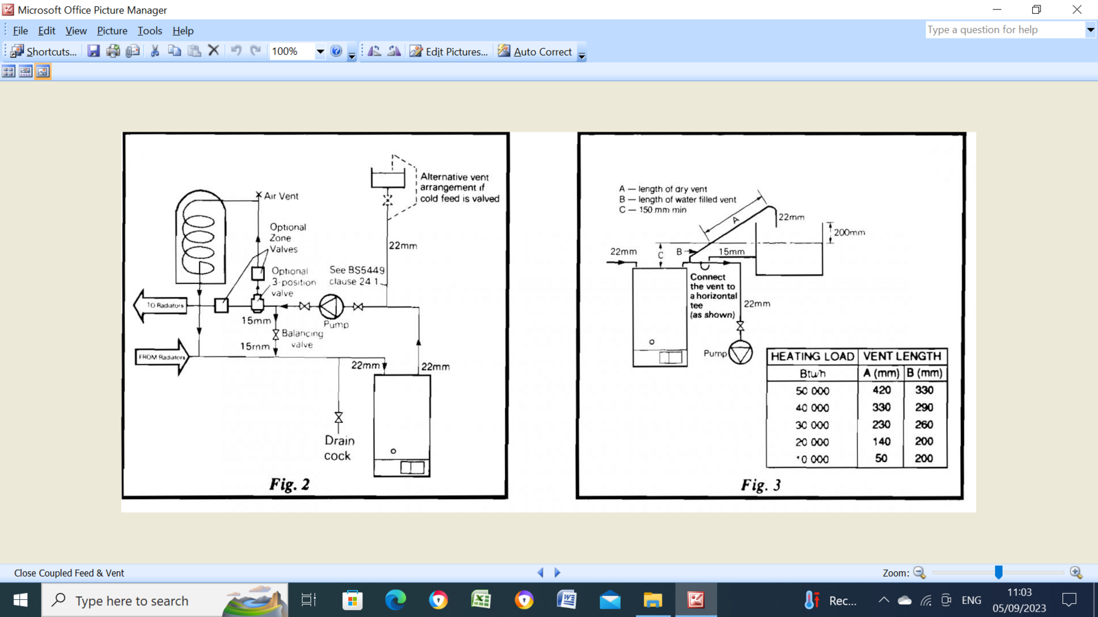

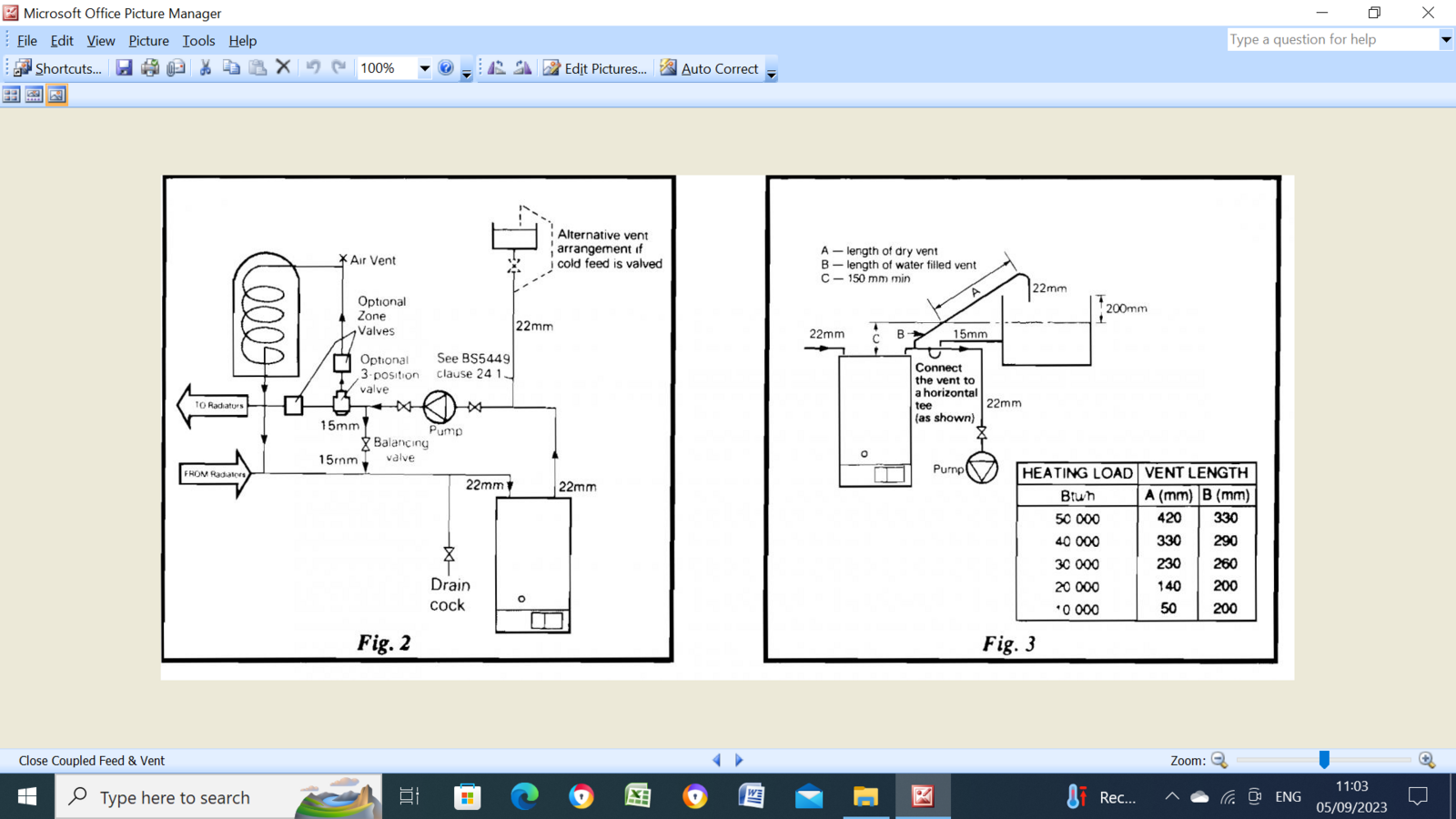

Came across this from a gas boiler MIs, can't remember which one.
I would take that with a generous pinch of salt. In Fig 3 dimension C, 150mm looks very sparse, and much lower than other makers say. Dimension A is useless as the angle of inclination is not given. Everybody else says the vent loop height, 450mm (vertical), is constant, not varying with boiler output. And it certainly wouldn't want to be as low as 50mm, giving vertical height around 30mm, for any boiler size.
