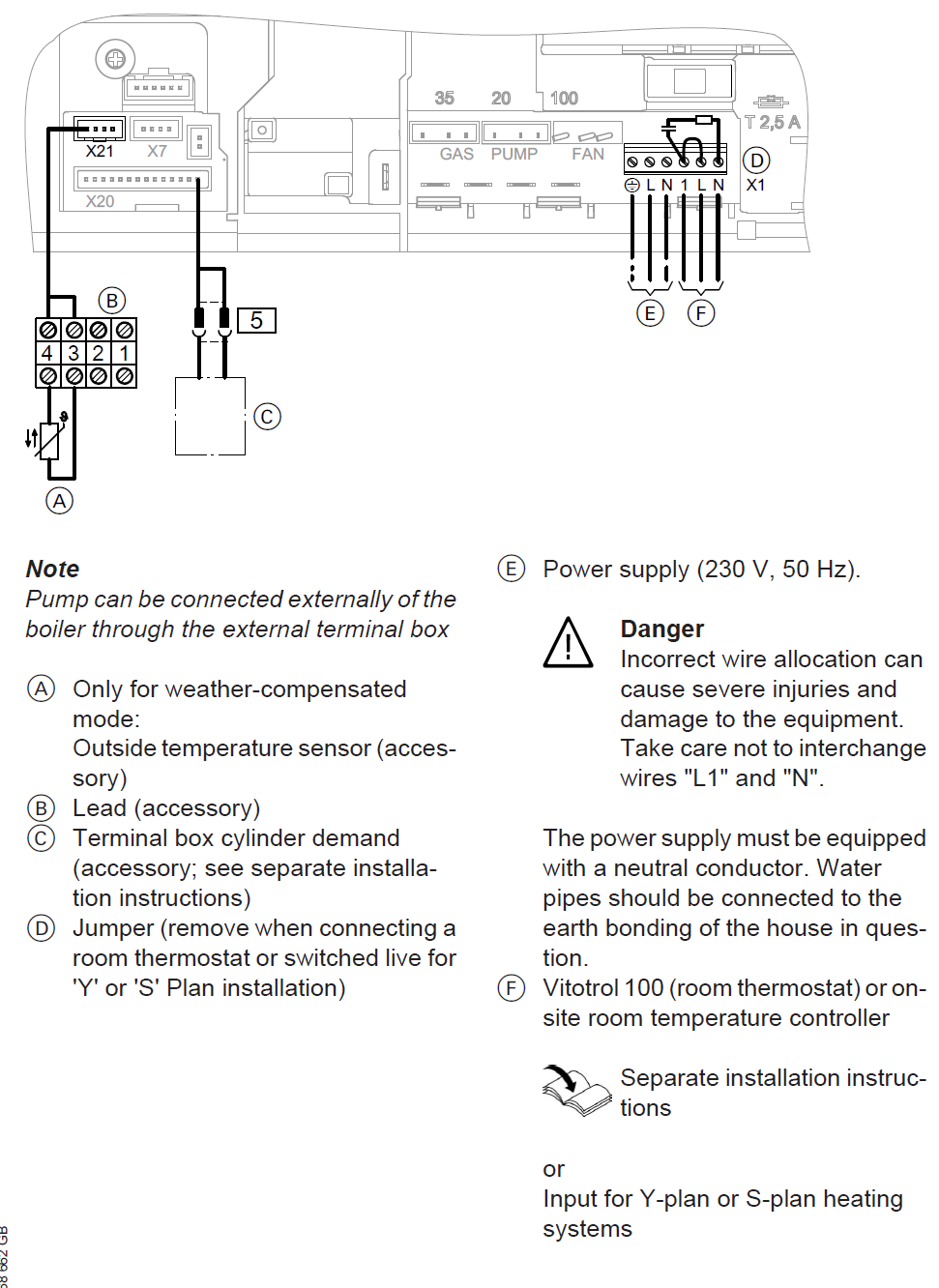

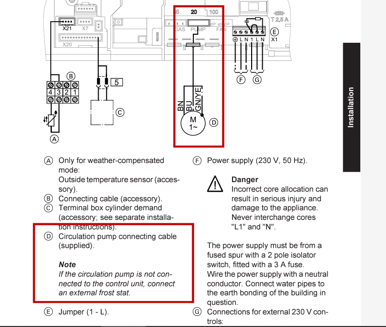

That boiler will happily feed the pump and control it's overrun and comes with a pump supply cable that connects to the board,0000 so the boiler will feed the pump directly incl overrun which is what you want
Remove the stat and set the boiler cabling back to the way it was and run the boiler directly and see if that changes things, how/where are you connecting the stat? What kind of stat is it? If the boiler is reaching 100Deg then it's overheating so something isn't firing the pump up, how is the pump connected at the moment?
The manual I found showed this, pump isn't shown as clearly, but I missed it.

I have tried bypassing the Room Stat and tried to connect boiler directly with same result. It doesn't fire up. It only fires up when I reset it and it goes in 'serv' mode.
The boiler and pump are connected to the wiring center. Wiring center N,L and E is fed by Spur. The Programmer and Room stat are installed away from boiler (inside lounge) and it gets its N and L from home wiring in lounge. There is no separate wire for Switch Live or pump Live to boiler. The wiring center has only N,L,E connections for Boiler and Pump. I suspect the wiring is not correct.

As you have to stop it manually in Serv mode it must be getting a Fire signal independent of the roomstat. The puzzle is why it won't fire in normal mode. It's difficult to analyse remotely! It might be worth rechecking the wiring and ensure it's in line with the manual.
