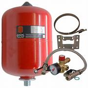

When you source an EV for the system, if sealed is the way you're going, then just get a sealed system kit. It'll come with the EV, 3 bar PRV, gauge, filling loop and a 4 way coupler to connect it all up. You just need to size the vessel accordingly.

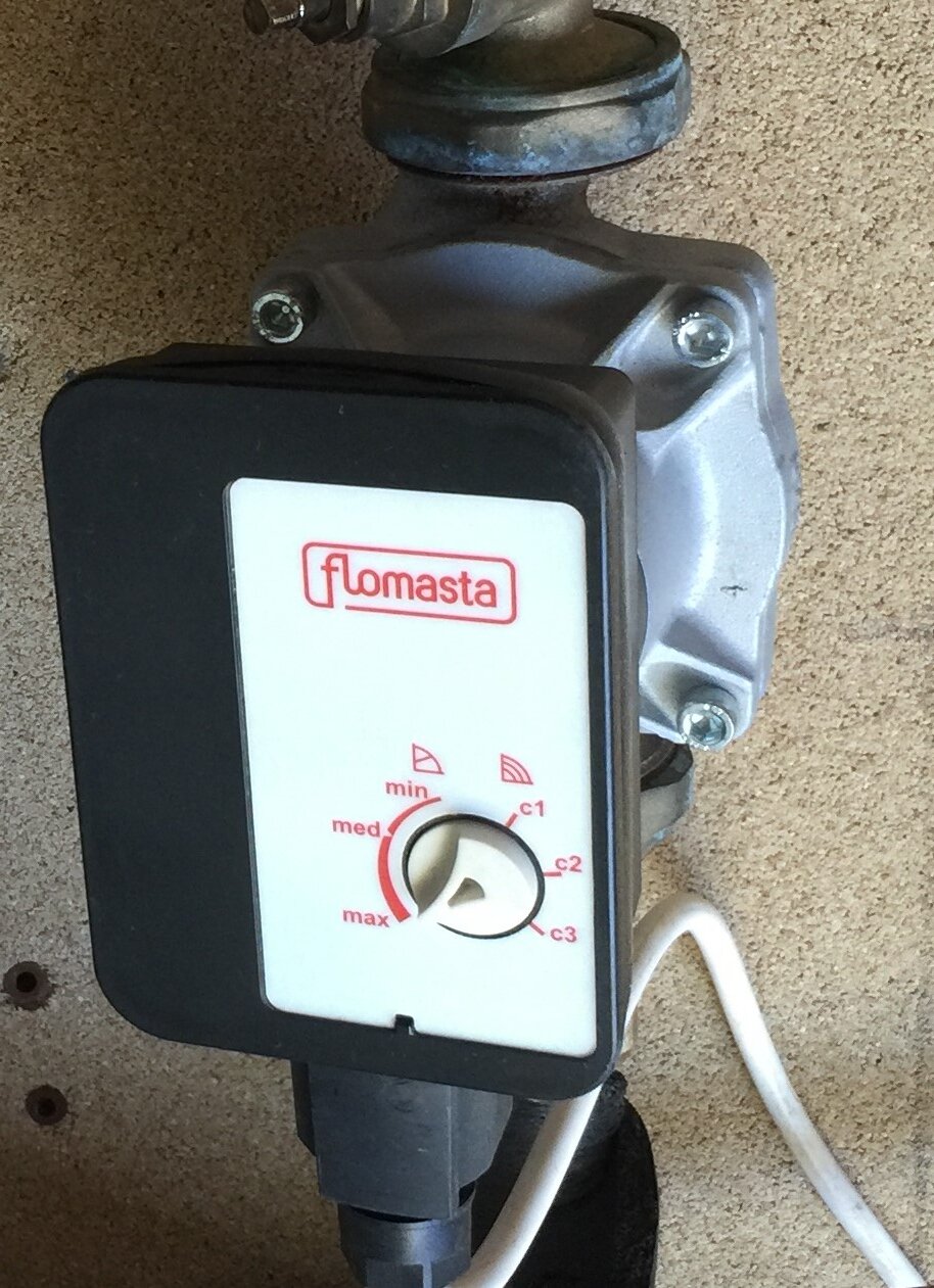

Flomasta make with 6m head. No ABV installed.

That pump does not have constant pressure mode, it has the traditional CC or fixed speed settings of 2M,3.8M & 6M, it also has numerous PP settings of 1,2,3,4&5M. What mode and setting are you on?
I don't understand its settings clearly and I have tested it on c3 (max speed) but thought I ask before switching it to other settings.
Based on my load which setting should I run it on. My back of the envelope working indicates a flow of 600 litres/hour based on a load of 9kw? Based on this which setting should I run this pump on? Thanks
600LPH or 0.6m3/hr is a pretty good estimation IMO, C3 will give a head of 5.7M at that flowrate, if your rads aren't all getting hot at that setting then you have a problem somewhere else, C2 would normally satisfy that requirement.
What about other PP settings? I haven't tested it yet.
Thanks, probably I have only balanced the first two rads which are closer to the boiler and not others. I need to balance the rads first and then set the pump speed? I thought setting the pump speed first and then balance the rest of the radiators.

Certainly sounds like you're on your way. I think you would need to go with a medium setting, C2 is certainly the place to start as suggested, and then perform a balancing exercise throughout the whole system. You need to settle and tune the system so it heats up uniformly, then if alterations to pump settings are required for heat up then that becomes part of the fine tuning process. Open up all valves on the rads and mark which ones are the flow then start the balancing.

I would balance them on C2.
C2 was indeed the setting that balanced all rads. I had already marked the flow on rads so balancing was smooth and all rads heated up nicely; the farthest one on the circuit took its time but it got to the temperature at the end.
