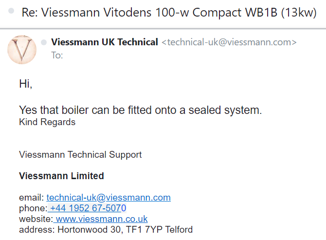

Boiler is stated as an OV as the presumption is that model is designed for OV systems, though most HO boilers can be used for either and it does also mention pressure settings when filling as sealed (unvented) but another confirmation from Viessman couldn't hurt.
I have sent them an email for confirmation already. It doesn't have pressure guage, not sure about PRV inside the boiler.

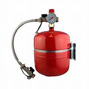

If it doesn't have pressure gauge and PRV built-in, it's easy enough to fit them externally on the pipework
Yes, there was a prv on on my existing boiler as well, and an EV, that's it?
What I meant to say that my existing setup has a PRV but no EV. I need to add EV to set it as pressurised system.
If you mean a PRV as in pressure relief valve then there must be a pressure gauge somewhere as well, either on the boiler or after the filling valve
I have a pressure relief valve on my boiler but no EV, as mine is a OV system.
When you source an EV for the system, if sealed is the way you're going, then just get a sealed system kit. It'll come with the EV, 3 bar PRV, gauge, filling loop and a 4 way coupler to connect it all up. You just need to size the vessel accordingly.
