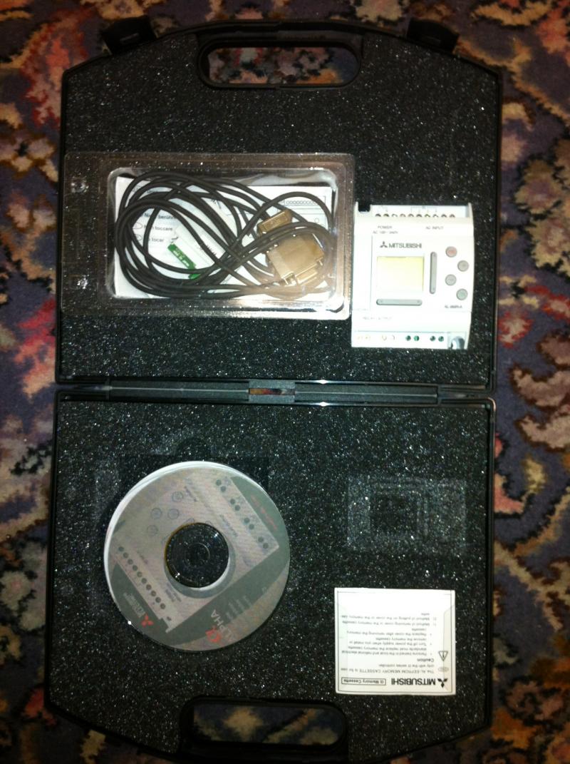

Which looking at the picture is a DB9 to something else. As you probably know not many lap tops have a serial port now and that is what I was responding to.

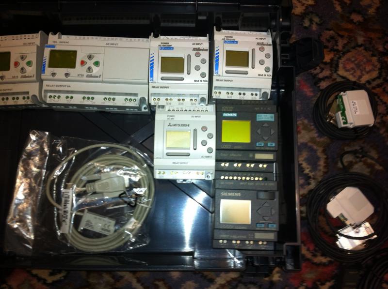

flyingsparks needs an SR to USB cable. See the photo.
It's possible that an SR to DB9/DB25 cable would work with the right driver (disclaimer - I don't know how compatible signal voltages are between V.28 and USB), but a standard serial lead, or a DB/USB converter would be no use.
The vital component is the plug on the end which fits into the Telemecanique device, and that's what is priced at £70.
There's plenty of room in that white enclosure with the proprietary socket for a PCB. Without seeing one it's impossible to say 100% sure, just going on the other brands where there are components and a PCB within the socket.
