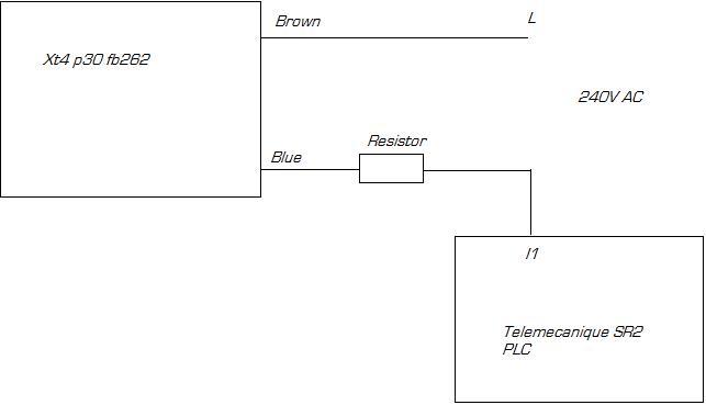

Thanks for your replies. I have been struggling to find a 240V capactive proxy switch for less that £100, but then stumbled across this on ebay which I bought and have now got. It is a XT4 P30 FB262
Data Sheet:
http://www.global-download.schneide...F3E5D0882575780038E422/$File/146067001a55.pdf
You can see the wiring diagram half way down slightly right hand side of the middle. I am now wondering if I can use this as it needs a load connected in series with the blue wire. Is there a way I can put its output into the PLC input? Perhaps having a power resistor there instead of the load then out of that into the PLC input? Or am I screwed? :oops:
Or I use the proxy switch to operate a coil of a small relay which then puts 240V on to the PLC input?
Not sure about putting a resistor in series with it, the resistor may need to be positioned across the input to the PLC and neutral for it to work.
It depends on the load that the PLC input takes and the prox switch as wether or not you need to have a dummy load or not.
gone down the route of the proxy switch energising a relay coil and then putting 240v into the plc that way. Had to get a coil of atleast 2.5W I think it was so as to draw enough current for the proxy switch to operate.
