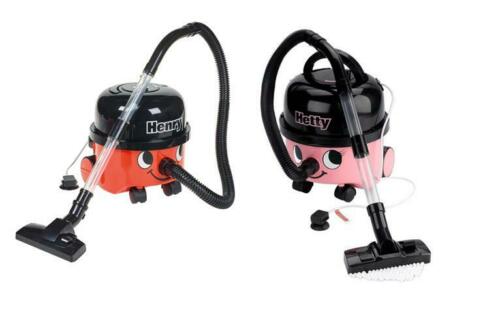

For What it's worth I've just done a little experiment, I turned on all the lights in a lighting circuit (about 600W) supplied by a B6 RCBO and plugged 1200W Henry in and do you know what?... Henry was doing a grand sucking up job. Then I thought 'I know what, I'll let Henry and 1200W Hetty play together', do you know what?... Henry and Hetty performed just as I expected, even on high power with the hoses blocked off to pull more current.
Edit:
Just for fun I added a fan heater, even on 2.5KW the RCBO didn't trip straight away.

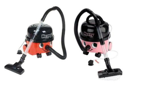

For What it's worth I've just done a little experiment, I turned on all the lights in a lighting circuit (about 600W) supplied by a B6 RCBO and plugged 1200W Henry in and do you know what?... Henry was doing a grand sucking up job. Then I thought 'I know what, I'll let Henry and 1200W Hetty play together', do you know what?... Henry and Hetty performed just as I expected, even on high power with the hoses blocked off to pull more current. ... Edit: Just for fun I added a fan heater, even on 2.5KW the RCBO didn't trip straight away.
It depends upon the duration of your experiments ...
A B6 should trip in about 30 seconds with a current of about 20A (4,600 W) or in about 1 minute at a load of about 15A (about 3,450 W) and in about 8 minutes with a load of 10A (2,300 W), and should allow about 6.78A (about 1,560 W) to flow indefinitely without tripping. I guess one has to view those figures in relation to the "EU" rules on the permitted power of vacuum cleaners!

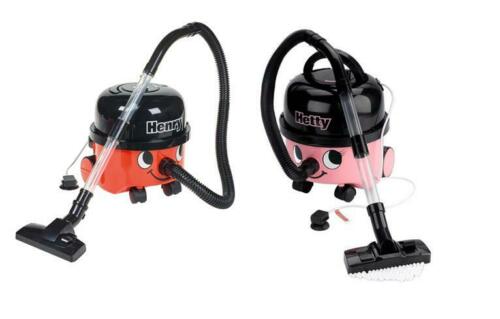

Edit:
You must have lots of time on your hands. Many years ago I plugged a kettle into a 13A socket in a garage not knowing it was on a lighting circuit. It immediately took out the fuse (5A fusewire in a fusebox).

I hope they behaved and did not couple up their hoses
well if you were unlucky they might have twins

I'll estimate the lights/vacs were continuously running for something like 5 mins, I couldn't do much about starting surge as they are soft start. Assuming everything was running correctly I assume they were running at around 5A each and expect a total of about 13A. I expected the RCBO to trip in that time, adding low setting of fan heater tripped the RCBO in about a minute.
Leaving to cool for 2-3 mins, restarting and switching vacs to high for a few seconds then adding 2.5KW fan heater (total of 5.5KW) tripped it in ~10 seconds.
