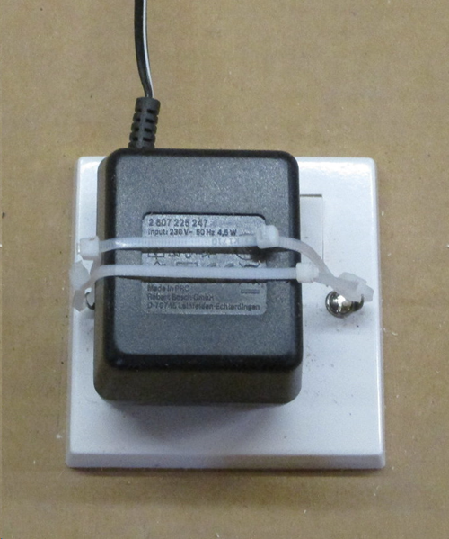

... if (seemingly exceedingly unlikely) a very large load was ever plugged into a socket on a 6A circuit in a loft, the worst that would happen is that the circuit's OPD would trip - and, in turn, the worst (and oft-cited) consequence of that would be to be 'plunged into darkness' in the loft. However, as crystal ball implies, anyone doing things in a loft without a functioning torch in their pocket probably deserves any fate they suffer - given that, at least in my part of the world, a brief power cut would be a far more likely cause of that 'plunging into darkness' than would someone plugging a very large load into a socket clearly intended for something specific and different (and quite probably labelled as such.
... and, in any event, as I have illustrated during previous incarnations of this stupid discussion, one can do more than just 'labelling' if one wants to keep the vacuum's plug out of, say, the wallwart's socket ....
