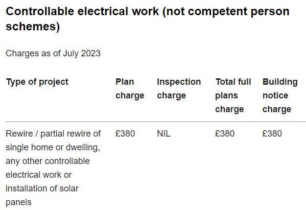

I looked at this option about 11 years ago. Your LABC should have a table of fees on their website- for notifiable electrical work back then it was about £600. For what i needed doing it was much cheaper to get a real electrician in to fit the CU and bathroom stuff

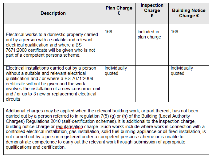

It varies a lot between LAs. The current one for where I live is:
The LA where I have another property is more complicated (see below). If they judge the person doing the work to be adequately qualified, and if that person provides an EIC, but the person is not a member of a CPS, they charge Just £168, with no additional charge for inspection' (goodness know what, if anything, they do for that £168 :) ).
On the other hand, if the person is not suitably qualified and/or if an EIC will not be given ,(and, by implication, is not a member of a CPS, they charge an unspecified ("Individually quoted" and, per the note below, will also charge an (again unspecified) amount for the I&T!
Kind Regards, John
