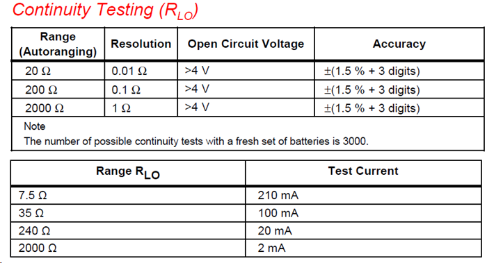

Multimeters in resistance mode normally act as current sources. I just checked a couple of meters that were to hand and they both used currents of around 1.5mA in their most sensitive resistance mode. I don't think expensive meters are substantially different in this regard but i don't have one to hand right now to check. That means 1 ohm is 1.5 millivolt, 0.1 ohm is 150 microvolts and 0.01 ohms is 15 microvolts.
Yes, all true.
It's clear that battery voltage is not the limiting factor here. I strongly suspect the reason is that people expect to use multimeters on sensitive electronics and going any higher would risk damaging said electronics. Battery life may also be a concern.
Again true, and I agree that those may well be at least some of the explanations - although 'battery life' is presumably not an issue for many bench meters?
Your fluke meter by contrast gives a choice of 10ma or 250mA.
Mu 1562 give no 'choice' of test currents.
In fact, I'm a little confused about what it does do (per extract from manual below). The meter has no manual range selection. The first table below seems to imply that it auto-ranges between 20, 200 and 2000 ranges. However, the second table gives test currents for 7.5, 35, 240 and 200 'ranges' - so I don't know whether they are also 'auto-ranged ranges, or what!
However, some quick measurements indicate that when measuring 0.33Ω, 1Ω, 10Ω, 47Ω and 150Ω resistors with the 1562, the voltage across the resistors were (consistently) about 60 mV, 200 mV, 1.0 V, 0.9 V and 3.0 V respectively, implying test currents of about 200 mA, , 200 mA, 100 mA, 20 mA and 20 mA respectively, which is certainly consistent with that second table below.
In contrast, and heading in the direction you suggested above, when measuring a 1Ω resistor, a cheap DVM put only about 0.6 mV across the resistor, hence a current of about 0.6 mA Edit: I should have added that, despite the low current, the meter gave a roughly correct reading.

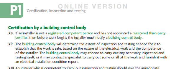

Is this what people are reading to form their views on the subject?
Approved Document P, 2013 England.
I don't like using such documents but there is nothing else apart from Regulation 12 which just tells the householder that he is "required to give a building notice or deposit full plans".
So, can 3.9 be achieved with merely a written notification from the householder - or is it just sumfin wot sumwun rote and the whole thing (especially since 2013) is totally meaningless?

Yes 3.8 and 3.9 are the sections that informed me when I initially started this thread. In plain English it states A) you have to notify the LABC before work begins B) the LABC (or their contractor) will do I&T during & after the works.
I'm inferring from your other replies that you don't think approved doc. P counts for much... my view is that it's much like the Highway Code which is de facto law, and a court would refer to it as such

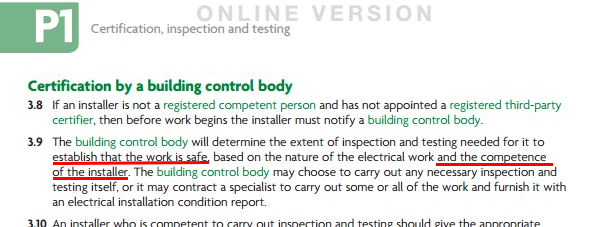

How does the BC do that by just reading that someone has stated they are going to replace their consumer unit?
Whilst they would undoubtedly "take into account" what is written in Approved Doc P (and other guidances and opinions), I'm pretty sure that a Court would assert that it is the Court, and only the Court, that can rule on interpretation of the law.

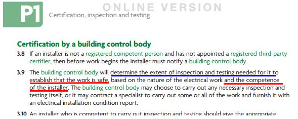

You appear to have forgotten to underline the crucial bits which indicate what the bits you have underlined relate to, so I've added (in blue) it for you below. Hence, on the basis of the information in the notification, the building control body has to decide what/how much I&T is required "on the basis of the nature of the electrical work and the competence of the installer".
The 'nature of the electrical work' is straightforward enough. As for "the competence of the installer", as I said I could not remember whether notification forms ask about qualifications, but it sounds as if they probably do (or, at least, would be 'asked about' as soon as one had submitted a Building Notice. On the basis of those two bits of information, they then decide upon "the extent of I&T required".
Per what I have recently written, I have never seen, anywhere (or heard of happening) a building control body 'rejecting' a Building Notice because of the lack of qualifications of the applicant - if they regard the qualifications (if any) as 'inadequate', they simnply arrnage for I&T do be undertaken by someone 'competent'.
