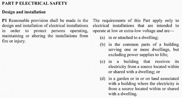

However, since The Building Regulation 12 (it is not Part P) included electrical work in 2005 to regulate ancillary trades and DIYers I have always understood the the BC could prevent people they deemed unsuitable from doing notifiable electrical work.
What, other than that, was the legislation intended to do? Surely some form of 'permission' must be given.

As we've been discussing above, the notion that you have to apply for electrical work seems to be unsubstantiated.. part P only requires you to notify.

It's not Part P; it is Regulation 12.
Part P merely states:
So what if the BC decide you cannot ensure that safety because you do not have the required test equipment, not to mention knowledge.
