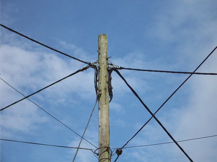

Thanks again. I don't doubt that some of the underground LV network cables are pretty big - ones I have occasionally seen 'down holes' when DNOs have been working have appeared pretty meaty.
However, my overhead supply is clearly not using such massive cables (yet, as observed, I don't see very large fluctuations in supply voltage. The photo below shows the last (most downstream) pole for the cable that supplies me. For a start, for some who have been commenting, it's clearly not a 'ring' (but I suppose someone wanting to continue the argument might suggest that it could be 'a spur from a ring' :) )
However, the main point of the phot is that the incoming ABC cable (the one coming from bottom right of pic) is not vastly bigger than the ones feeding individual installations from it, which I imagine are at least 16mm². Maybe I'm wrong, but I find it rather hard to believe that the 'main' feed cable (which looks the same throughout it's length) is bigger than 35mm² (maybe 50mm² at the very most). What do you think?
