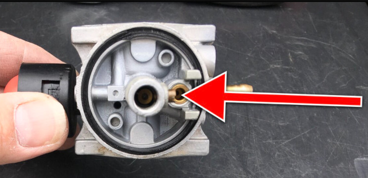

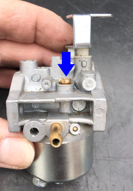

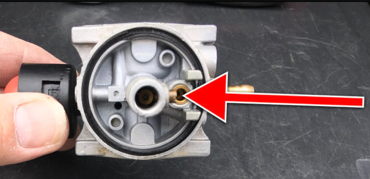

These are the only jets with holes in.
Blue arrow has 3 holes & i think it controls fuel that enters the carb / float.
Red arrow has 2/3 holes & i think its where the fuel enter through it & up the emulsion tube.
So far never been able to remove emulsion tube but straight up the middle is 100% clear

The blue arrow indicates the slow running fuel supply. (pilot mixture, if you like).
The red arrow points to the main jet which must be completely clear.....above it is the float needle jet.
The emulsion tube may have an obstruction if it has drillings into the side of it, but as you can't remove it we'll never know.
John :)

I tried to press with flat screwdriver the top of the emulsion tube hoping it would pop out but it was very very tight so it never moved.

There is the smallest of holes in this main jet & trying to squirt fuel through it is a big ask.
I believe there are say 1/2 in the side of the jet & 1 straight the middle.
What if i opened up the one throgh the middle but even then a big ask

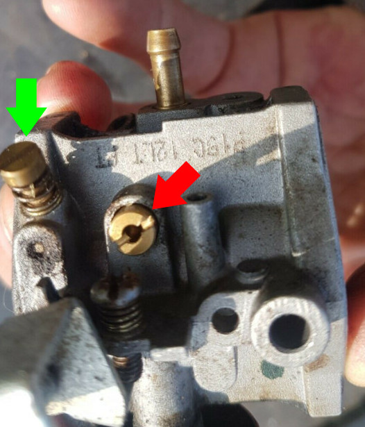

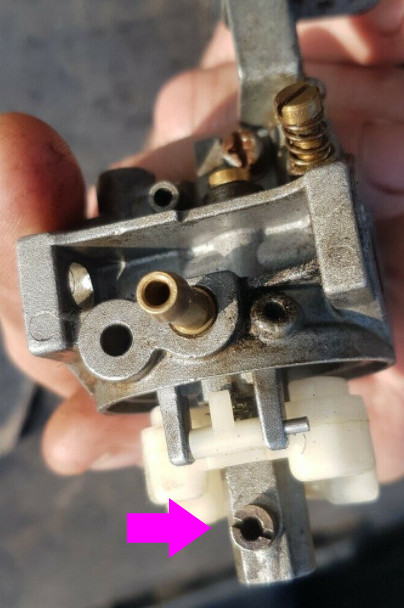

Here is the carb on the way to me.
Slightly different but same mower model
RED ARROW..........SLOW RUNNING / PILOT
GREEN ARROW...........??????????
PINK ARROW.............MAIN JET

Leave the main jet alone....just make sure it is completely clear. Leaving it out will allow far too much fuel into the engine and that will be hopeless.
I can't say that the emulsion tube has any cross drillings - but as its jammed in place so leave it be. Forcing the thing out is likely to damage it.
Lets leave things until you fit the new carb!
Red arrow - pilot jet underneath, incorporated in a brass screw and not adjustable.
Green arrow - pilot jet fine tune.....often one full turn out from fully in.
Pink arrow - the ever important main jet.
