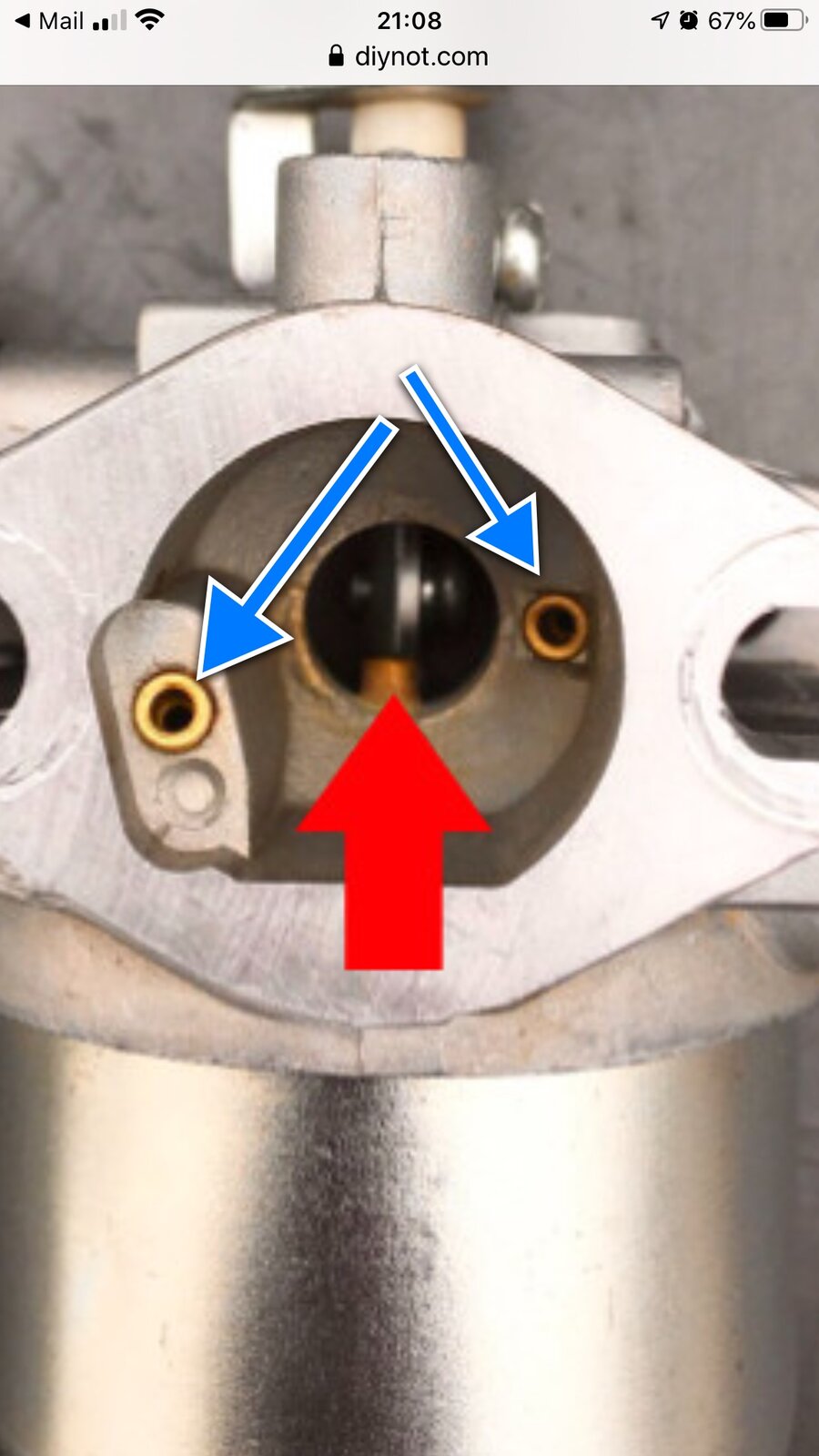

However, looking for the carb picture of where the air filter bolts onto the carb body.....notice the tiny two brass inserts to each side of the main venturi?.....These are air access ports for slow running and must be clear - squirt carb cleaner down them to see.
Now....just to complicate things. Look for a tiny drilling into the venturi, just down stream of the throttle butterfly. If there is one, it needs to be clear. This is where the slow running fuel gets drawn into the engine.
I have to stress, not all carbs have this feature.
John :)
Monday I will apply carb cleaner to the items marked with blue arrows.
