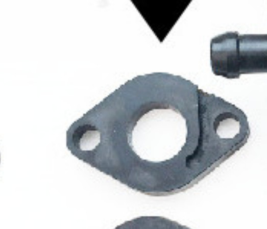

No not certain about black block,i cant even remember if i tried it the other way as ive had it on / off so many times.
From memory one side is flush & the other has a driiled hole "BUT DOESNT GO RIGHT THROUGH" this hole then leads to a groove down the block.
Im sure its fitted with hole / groove engine side as opposed to carb / air filter housing side.

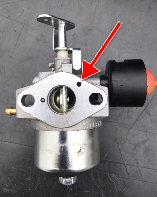

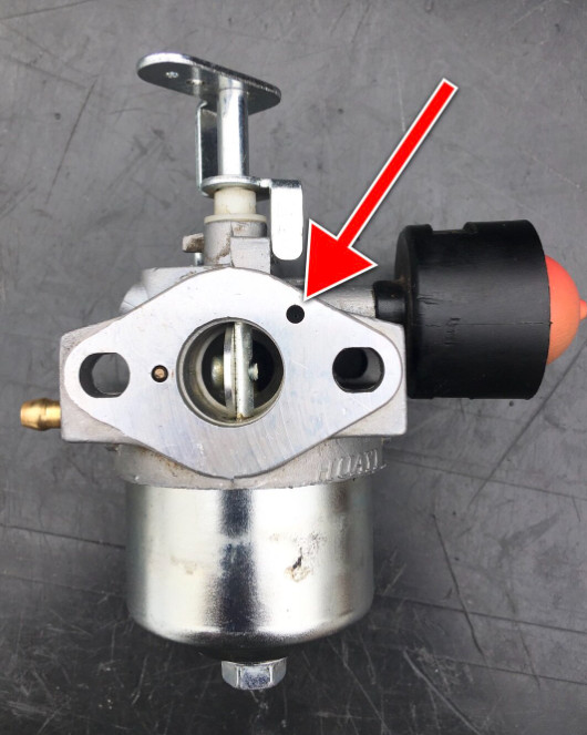

See attached photos.
From memory i could see a spray of fuel from the arrowed hole.
BUT
If i press the primer say 10 times it starts but chugs & youve got your fingers crossed its going to go.
Same as before a squirt of brake cleaner stright into air filter housing with foam element remote & first pull starts & sounds great,only to burn that off & chug or stall then im pulling & pulling
The hole / groove is shown in nylon block.

Right, that’s a bit more info!
I think you are going to have to juggle the number of primer pumps because I think you are flooding the engine, especially if it recovers maybe blowing a little black smoke.
Try say 4 quick presses then immediately going for a start - if it’s reluctant maybe one more then try again.
John :)

Did look / touch the carb block as you mentioned as i assumed its the correct way fitted or it would even start ?
At least we have a start up situation now....try it again in the morning to see if you can establish a reliable sequence.
At this time I'd leave everything alone to settle down, and that includes the black emulsion block.
