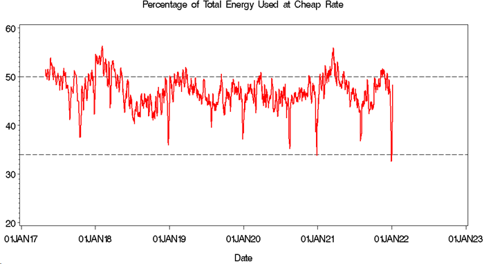

JohnW2..do your graphs indicate that your daytime and nighttime usage is broadly similar or am I reading them wrongly?
Yep - exactly that. As the first graph below shows, i generally run at between 45% and 50% of consumption at night rate -which is why E7 is financially advantageous for me. [ The very brief excursions down to 30-35% every Christmas (and occasionally at other times) result from a very high daytime usage when entertaining at Christmas etc.! ].

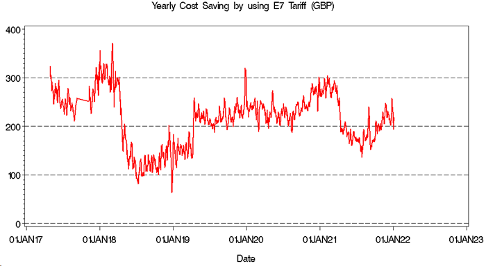

The second graph shoes the saving (of E7) over the best comparable single-rate tariff from the same supplier. Although tariff changes in April 2018 resulted in a considerable reduction in the benefit of E7, in April 2019 I changed to a different supplier who offered a more attractive E7 deal, and (following a small detrimental deterioration of tariff in April 2021) today am still achieving something like a £200 pa saving as compared with my current supplier's single-rate tariff.
