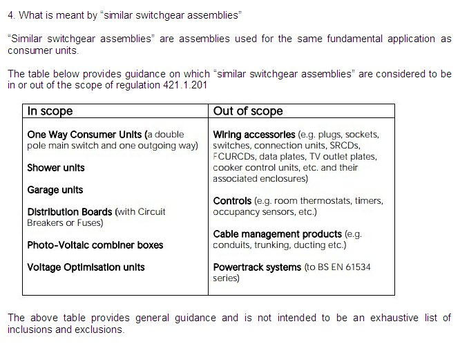

In my loft I have a small enclosure containing some DIN rail terminals, a fuseholder and a contactor. If I were installing it next year, would it have to be "non-combustible? Ditto for Bernard's box of lighting relays.
Good questions. In their infinite wisdom, BEAMA have taken it upon themselves to give 'guidance' on this matter - but it doesn't really help very much ...

How does BEAMA know that?
I presume because they have deemed themselves to be omniscient - either that or they have purchased a crystal ball!
More seriously ... (a) (although they shouldn't call it 'guidance') they are essentially just proposing a fairly 'common sense' view of what the regs might intend and (b) I would imagine that they are probably represented on JPEL/64, so might just possibly have some genuine insight into what the 'intent' actually was.

Would it be possible for you to give us a rough idea of what that definition says?
3.1.1
low-voltage switchgear and controlgear assembly (ASSEMBLY)
combination of one or more low-voltage switching devices together with associated control,
measuring, signalling, protective, regulating equipment, with all the internal electrical and
mechanical interconnections and structural parts
