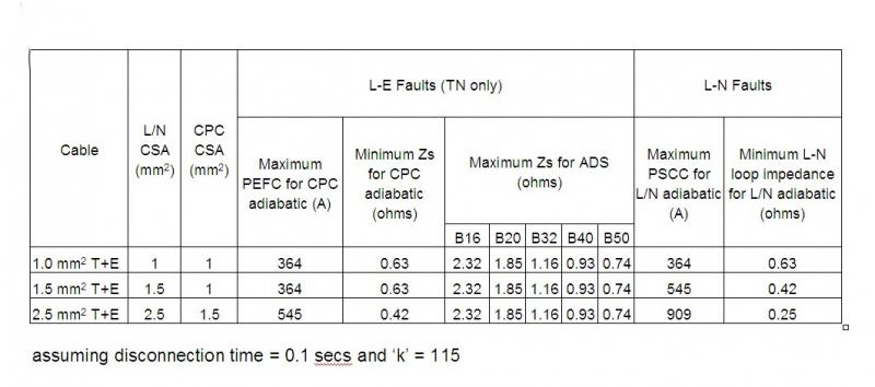

Yes, you are right John - you wouldn't 'bat an eyelid'. But you wouldn't contemplate hanging 1mm off a 50A MCB, as you know, because it would fall foul of other design criteria......so not entirely sure what you are saying Old Bean.
I thought it was probably time to do some sums, and, if I've done them right (please tell me if you think I haven't - which is quite possible!), assuming a disconnection time of 0.1 secs and a 'k' value of 115, I get:
As you can see (assuming my figures are right), and as one would expect, the situation would be pretty tight if one were hanging a cable with a 1mm² CPC (i.e. either 1mm² or 1.5mm² T+E) off a B50 circuit. However, it would seemingly not be impossible. If the Zs were between 0.63Ω and 0.74Ω, and if the PSSC were ≤364A for 1mm² T+E, or ≤545A for 1.5mm² T+E, then it would appear that both the adequacy of conductor CSA (adiabatic calculation) and disconnection times under fault conditions would meet the requirements.
As can also be seen, needless to say, as the extent of the 'undersize' of the cable gets less extreme (in relation to the In of the OPD), the scope for it being acceptable under (L-E or L-N) fault conditions becomes greater.
Have I got this right?
Kind Regards, John

Though at first glance, do we need to use 230V as the nominal voltage?
Regards
Voltage obvioulsy only comes into what I did in relation to calculation of Zs (and L-N loop resistance) from PEFC/PSCC - and, yes, I used 230V as the nominal voltage, which I thought was the conventional thing to do. Is that not the case? However, if you wanted to use some other voltage (e.g. the actual supply voltage that happened to be present at the time of inspection), that would not have a major impact on the figures I presented, and my conceptual bottom-line conclusions would remain unchanged.
To my mind, the most iffy bit about adiabatic calculations when using MCBs is deciding what disconnection time to use, give that the operational curve is essentially vertical, over a wide range of times, in the region of interest. It seems fairly convention to use 0.1 sec in that situation, which is what I did. Given that assumption, everything else is obviously simple arithmetic.
If one uses disconnection times greater than 0.1 sec for the calculations, the adequacy of fault protection obviously diminishes. If I've got my sums right, in terms of the example we were discussing, using 1mm² or 1.5mm² T+E on a B50 would cease to be possible (in terms of CPC fault protection) if disconnection time rose to above about 0.137 secs.

I would say that your calculations are what would normally be done to ensure the required information for what would be a 'worst case' situation.
The disconnection times could be (a lot) less than 0.1 seconds and the maximum Zs may not be the 80% value depending on the load.
If desperate then the let-through information from the manufacturer could be obtained.
230V should be used because that is what is used to work out the maximum Zs values.
If the actual voltage were used with the corresponding values, would not the result be the same?
I would say that your calculations are what would normally be done to ensure the required information for what would be a 'worst case' situation. ... The disconnection times could be (a lot) less than 0.1 seconds and the maximum Zs may not be the 80% value depending on the load.
Thanks. Indeed - which is why I believe I have undertaken the calculations in the conventional 'worst-case' fashion.
True, but I doubt many people are going to do that. I'm a little surprised that more useful information is not 'published', so one doesn't have to go asking for it.
230V should be used because that is what is used to work out the maximum Zs values. If the actual voltage were used with the corresponding values, would not the result be the same? Am I missing something?
As I said, I believe use of the nominal voltage is conventional for such calculations. However, I'm not sure that I agree with what you say - the 'maximum Zs values' are determined by dividing voltage by the minimum current required to achieve the required disconnection time. If you used a different voltage for that calculation, you would surely get a different answer? Am I missing something?
[as you will be aware, the proposal for next year's Amd3 of BS7671 involves very extensive changes to all the 'maximum Zs' figures to take into account the fact that the actual supply voltage may be less than the nominal 230V]
In any event, in the figures I presented, I did not calculate the 'maximum Zs figures' (for ADS), which I just took from the OSG. It was only when calculating the minimum Zs to provide adequate fault protection of conductors (adiabatic calculation) that I used a voltage, and for that I used the nominal 230V.
Not sure.
My point was that the maximum Zs is proportional to the voltage.
So, with our meters, at least, calculating Zs from the actual voltage but we allowing only the 230V maximum then this will include some tolerance.
Although the R1+R2 of the circuit in question will not alter, with a higher voltage a higher Zs would technically be allowed.
So, we should use 230V for calculations or alter all of the parameters.
With a higher voltage and same R1+R2, PEFC will be higher causing the OPD to operate quicker and result in the CPC acceptability, or not, being unaffected.
I was not aware.
That doesn't seem logical.
Not sure. My point was that the maximum Zs is proportional to the voltage. So, with our meters, at least, calculating Zs from the actual voltage but we allowing only the 230V maximum then this will include some tolerance. Although the R1+R2 of the circuit in question will not alter, with a higher voltage a higher Zs would technically be allowed. So, we should use 230V for calculations or alter all of the parameters.
Exactly. If one calculated Zs using the actual voltage, if that voltage happened to be high at the time of measurement (e.g. 240V or 250V) and the Zs calculated on that basis was low enough for satisfactory ADS at that voltage, if supply voltage were to fall (say to the nominal 230V, or even lower), PEFC may then become inadequate to satisfy ADS requirements. That is, I presume, why the regs plan to change the 'maximum Zs figures' to take into account the possibility that the supply voltage might be up to 6% below the nominal 230V.
That our meters determine Zs by dividing actual voltage (at the time) by actual current (at the time, at that voltage) is correct, and results in a true figure for the actual loop impedance, regardless of the voltage at the time. You would still get a correct figure for Zs even if (hypothetically) supply voltage were 100V or 500V at the time!
Are you now talking about my adiabatic calculations? If so,you are essentially right - but, as discussed, in practice we are not able to determine (from readily available data) the extent of that reduction in disconnection time - but, rather, are having to 'guess' a 0.1 sec figure.

In a way, I'm just saying that if 230V and its 80% Zs and 0.1s are used then the result will be well on the conservative side.
