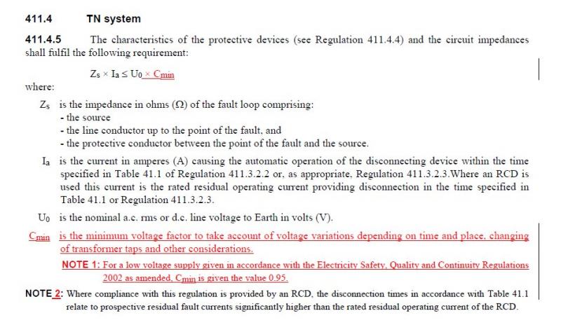

As you said, the maximum Zs's in 411 are Uo/Ia.
The values in your chart are 218/Ia.

Ah, I see - when you say 'my chart', you mean the Amd3 proposals! I should have explained in more detail. In their infinite wisdom, in order to take into account the possibility that supply voltage is less than nominal, the IET are proposing to introduce a 'correction factor' of 0.95 (not 0.94), thereby allowing for voltage to be as low as 230V-5% (rather than 230V-6%) - as you say, 218.5V (not the 'permitted minimum' of 216.2V). I presume that this is not meant to make sense :) See....

Unfortunately, when I read the DPC, I subconsciously thought that all the proposed changes we are discussing resulted from application of a correction factor ("Cmin") of 0.94, which would have made total sense (to me). It was only when EFLI pointed out yesterday that the proposed new Zs figures were based on a voltage of 218.5V (not 216.2V) that I revisited the document, and saw that they were actually proposing Cmin=0.95. Had I realised that a few weeks ago, I would certainly have submitted a comment (and proposal that they should consider Cmin=0.94).

Fair enough. I'm pleased to hear that you feel the question is worth asking. It occurs to me that the reason why the proposal 'does not make sense' to me could be the result of a misunderstanding on my part, so maybe you or someone else (westie?) could clear this up for me?
As you will realise, my 'surprise' is based on my understanding that a UK electricity supply is ‘permitted’ (by whom?) to be as low as 230V - 6%, namely 216.2V. The proposed new Note 1 to 411.4.5 indicates that, for LV supplies “in accordance with ESQCR (2002, as amended)”, minimum Zs values should be calculated from U0 x 0.95 - i.e. 230V -5%, namely 218.5V. This almost implies that ESQCR imposes a minimum supply voltage of 230V - 5% (i.e. 218.5V), rather than 230V - 6% (i.e. 216.2V).
Can you (or someone) possibly clarify exactly what regulations say what about the minimum supply voltage in the UK? I really need to be clear about that before I can comment on the DPC without potentially making a fool of myself!

From reg 27 of the ESQCR 2002:
(2) Unless otherwise agreed in writing between the distributor, the supplier and the consumer (and if necessary between the distributor and any other distributor likely to be affected) the frequency declared pursuant to paragraph (1) shall be 50 hertz and the voltage declared in respect of a low voltage supply shall be 230 volts between the phase and neutral conductors at the supply terminals.
(3) For the purposes of this regulation, unless otherwise agreed in writing by those persons specified in paragraph (2), the permitted variations are—
(a)a variation not exceeding 1 per cent above or below the declared frequency; .
(b)in the case of a low voltage supply, a variation not exceeding 10 per cent above or 6 per cent below the declared voltage at the declared frequency;

I have to say that I'm very surprised - not so much because they are going to look at my late comment, but by the suggestion that my comment is 'new'. My comment that (in view of the ESQCR-permitted minimum supply voltage) I would have expected 'Cmin' to be be 0.94, rather than 0.95 seems so 'obvious' that I had imagined that many people would already have raised the same issue.
I suppose the upside of this is that, should the regs end up with Cmin=0.94, I will be able to satisfy myself with the knowledge that it was probably 'all because of me' (with some encouragement from stillp). Now we wait! Of course, if that happened, some electricians would be less pleased (by the requirement for 'even lower' Zs), and might send out a 'hit squad' to find me :)
