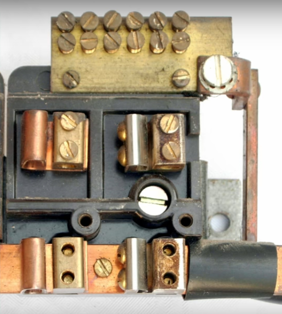

We have, for example, discussed the fact that some organisations seem to be suggesting that a plastic CU in certain locations (e.g. under stairs) should be given a C2, involving a landlord in expenditure of £££ which would not be necessary if a different inspector had undertaken the EICR.
I agree, I have not seen a single old fuse box go on fire. This type Wilex-board-with-RCD.jpg have been going for years however were only rated 60 amp Wylex 60 amp.jpg and fitting over size fuses did cause damage Wylex burnt contacts.jpg there was a heavy duty Wylex heavy duty.jpg but in the main limited to 32 amp. And in the example show it was in a garage anyway so should be reasonably fire resistance. Also in the case shown they were RCD protected. My son who now has that house will replace the consumer units, it has been planned for many years, the new consumer unit has been sitting in the garage ready to be fitted for nearly 20 years, so clearly I did feel there was a need to change. But the problem was the RCD's tripping not lack of RCD or fire resistance, but the enclosure for the RCD's is a rather flimsy plastic and more likely to burn than the bakelite plastic used in the Old Wilex.
The installation shown should fail, as I have well over 60 amp on one consumer unit, and the DNO has fitted a 100 amp fuse, they were when fitted on a 60 amp fuse, but it was swapped to 100 amp on a routine meter change. I show my old house because I know the faults, but I don't think this has been staged
It does seem a real fire, it seems the person who posted this picture has not worked out why, which is worrying as they claim to be an electrical firm, and I have seen a video of a device designed to put out consumer units fires, where they used a pencil torch to start the fire, to demonstrate how it worked, so are these fires real?
