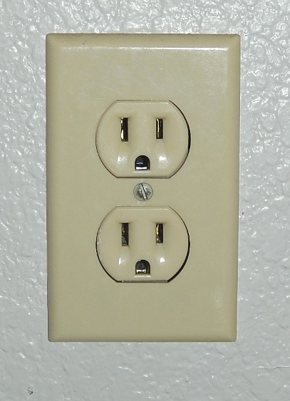

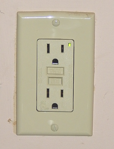

The combination GFCI/receptacles are common here, but I'm not that keen on them, in part because they're only available in the "Decora" style (large, flat rectangular face with matching cover plate), like this one currently in our garage:
So if you want matching receptacles in a room, you then have to use the Decora-style throughout, as it clashes somewhat to have one GFCI-receptacle like the above in combination with the more traditional types elsewhere:
So for myself, I much prefer the GFCI breaker (equivalent to the British RCBO) back at the panel. Here's one I've already acquired for the changes I'm planning as an example:

those are from the 1950's, right?
No, the receptacles are early 1990's, appear to be originals from when the house was built in 1991. But Leviton has made a standard duplex receptacle (second picture) in that same basic style for decades.
The C-H breaker is new-old stock, date coded 1983.
