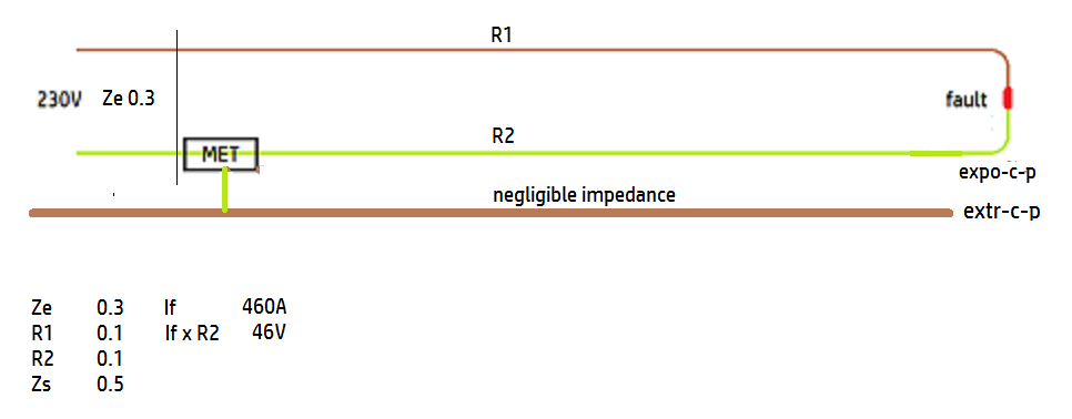

Something I cannot get out of my mind:
In the event of an L to exp-c-p fault at an appliance, are you sure the MET is still at 0V during the fault?
After all, it is not really THE earth point (the planet), is it? In TN-S and TN-C-S (not PME), that will be at the sub-station.
So, R1 and R2 is a continuous conductor from the supply to the MET and back to the sub-station.
Are your calculations and diagrams ignoring the effect of Ze?
If the CPC were disconnected from the MET the Voltage on it would be ~230V, wouldn't it? Yes.
Does that not mean that the Voltage between the exp-c-p and the MET during the fault is If x R2?

... Are your calculations and diagrams ignoring the effect of Ze?
As per the second 'disclaimer' at the start of my most recent post in the other thread, yes, I am ignoring Ze (hence ignoring the rise in MET potential {relative to true earth} during a fault) - but, as above, that is irrelevant to these discussions - since (again!) " all that matters to a person within the property are potentials relative to MET potential (regardless of what MET potential is relative to 'true earth' potential)".

Please answer this for me.
Imagine the Line conductor of a circuit is a bare conductor.
One could touch that Line conductor at any two points and not get a shock - apart from the Volt drop created by the current and resistance of the conductor between the two points of contact.
E.g. 10A x 0.1Ω = 0.1V
Is that correct?
So, with an earth fault at an appliance, in effect the line and CPC are one continuous conductor.
Why then, cannot one touch the CPC at two points (exposed-c-p and MET) and be subject to the same conditions?
E.g. 160A x 0.1Ω = 16V
Why is it not the 16V but 142V you calculated?
P.S. person not earthed, of course.
Please answer this for me. Imagine the Line conductor of a circuit is a bare conductor.
One could touch that Line conductor at any two points and not get a shock - apart from the Volt drop created by the current and resistance of the conductor between the two points of contact. E.g. 10A x 0.1Ω = 0.1V Is that correct?
Yes, that is correct, other than for your arithmetical error :) (10A * 0.1Ω = 1V, not 0.1V ).
However, in terms of the fault scenarios we are talking about, it could well be, say, 600A X 0.3Ω = 180V !
So, with an earth fault at an appliance, in effect the line and CPC are one continuous conductor. Why then, cannot one touch the CPC at two points (exposed-c-p and MET) and be subject to the same conditions?
E.g. 160A x 0.1Ω = 16V ... Why is it not the 16V but 142V you calculated?
At least your arithmetic is correct this time :)
Your application of Ohm's Law is obviously correct - i.e. if there were 160A flowing through the path (consisting of the L-conductor {R1}and CPC {R2} in series, hence a total resistance of R1+R2), then if you touched two parts of that path which has a resistance of 0.1Ω between them, then you would indeed experience a 16V potential difference.
However, your figures are impossible (unless one had a cable in which the CPC was massive in comparison with the L-conductor). With a 230V supply, a current of 160A implies that R1+R2 = ~1.44Ω. With a real-word cable, the resistance between the exposed-c-p and the MET (i.e. the resistance of the CPC, R2) would then be an awful lot more than 0.1Ω - for example, as I've said, with a 2.5/1.5mm² cable, if R1+R2 = 1.44Ω, then R2 would be about 0.9Ω (1.44 x 5/8), not 0.1Ω. Hence the PD between exposed-c-p and MET (i.e. across R2, the CPC) would be about 144V (160A x 0.9Ω)
Does that help/make sense?

Arrrgh! ...
Ah, sorry about the error (partial edit)
Yes, it could be more - but it shows that the Ze has an effect.
That's good. I thought I was going mad.
Yes, but contrary to what I said before, perhaps your method of using ratios of conductors was not ideal as there are different permutations.
There could be 600A but that's unlikely.
In some circumstances it could mean that the touch voltage was low enough without supplementary bonding such as just a metal light with circuit and water pipes connected to the CU on the other side of the bathroom wall.
Perhaps not a frequent occurrence but it is possible.
There still seems to be nothing related to R < 50/Ia.
In the above diagram it would be 50/30 = 1.666 which would be way too high.
Yes, but not an effect on what we are considering, which is potential differences relative to the MET.
I don't understand. As I explained and illustrated in my recent post in the other thread, "using the ratio of conductors" is simply arithmetically slightly simpler that marking out the current and then multiplying by the resistance - both will give identical answers.
The current doesn't affect anything. If it were 600A going through R1 (L-conductor) and R2 (CPC in series), then the voltage across R2 would be (600 x R2) and the voltage across R1 would be (600 x R1) so the ratio of voltages across the resistors (i.e. R2/R1) would be (600 x R2) / (600 x R1) = R2/R1.
If we consider, say, 2.5/1.5 mm² cable, then R2/R1 is always 5/3, regardless of the length of the cable. The voltage across R2 (CPC) will therefore always be 5/3 times the voltage across R1 (L-conductor) - which means that the voltage across R2 (CPC) will always be 5/8 of the voltage across R1+R2 (i.e. the full supply voltage during fault) - and all that regardless of the actual value of the resistances (hence current) - it is only the ratio of the resistances (which will always be the same for any length of any particular cable) that matters.
In some circumstances it could mean that the touch voltage was low enough without supplementary bonding such as just a metal light with circuit and water pipes connected to the CU on the other side of the bathroom wall. Perhaps not a frequent occurrence but it is possible.
For a start, in terms of T+E, the figures in your diagram would only work for 1.0mm cable, since that is the only T+E for which R1=R2, so I will assume that such is the cable we're talking about (i.e. R2/R1 = 1).
You have somewhat moved the goalposts. As I said, I was 'ignoring' Ze - or, at least, was considering a situation in which the voltage at transformer and the Ze were such that the voltage at the origin of the installation was 230V during the fault. You have calculated a low 'touch voltage' by postulating a situation in which Ze was (50%) higher than (R1+R2), which means that the voltage at the original of the installation would fall to only 92V during the fault.
My calculation would therefore still work. With a supply voltage (at origin of installation) during fault of 92V and R2/R1=1, my calculation would lead to the same answer (92V/2 = 46V) as you got.
If you want to include the added complication of supply voltage falling during the fault (with supply voltage of 230V {assuming no other loads} before onset of the fault), try repeating your calculation with (probably more realistic, with 1.0mm² cable) Ze = 0.2Ω and R1=R2=1.0Ω. Using 'my approach', I would determine that the supply voltage (at origin) would fall to about 209V during the fault - so that, with R1=R2, the 'touch voltage' (voltage across R2) would be about 104.5V. I presume (hope) you will get the same.
If one used my 'simplification' of assuming that the voltage at the transformer and the Ze were such that voltage at the origin was 230V during the fault then, of course, with 1.0mm² cable (hence R2=R1) I would get a touch voltage of 115V (230v/2) - or, if it were 2.5mm cable [R2 = (R1 x 5/3], I would get the 'now infamous' 144V .

.... There still seems to be nothing related to R < 50/Ia.
I should have added (but didn't, because it probably seemed obvious) ....
... I agree. Quite apart from discussions about the magnitude of the 'touch voltage' (pd between extraneous- and exposed-cps) (which I hope I have clarified in my previous post), what you (and your diagram/calculations) seem to indicate is that you now agree that the 'touch voltage' is in no way dependent upon the resistance from extraneous-c-p to MET - hence making it very difficult to understand 701.415.2(vi).
On the contrary, as I've said, the only effect of that resistance is that, for any given magnitude of 'live' voltage (relative to MET) one is touching (as well as touching the extraneous-c-p), the current through a victim increases as that resistance decreases. 701.415.2 therefore seems to be, if anything, "erring on the side of being dangerous", by implying that 'lower is better' for that resistance :rolleyes:
