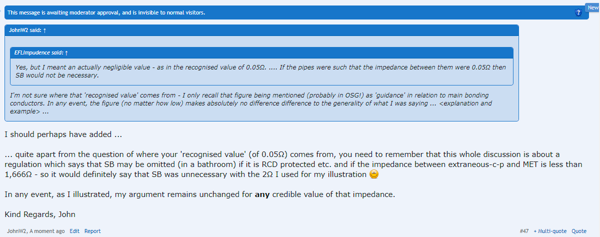

Yes, but I meant an actually negligible value - as in the recognised value of 0.05Ω. .... If the pipes were such that the impedance between them were 0.05Ω then SB would not be necessary.
I'm not sure where that 'recognised value' comes from - I only recall that figure being mentioned (probably in OSG!) as 'guidance' in relation to main bonding conductors. In any event, the figure (no matter how low) makes absolutely no difference difference to the generality of what I was saying ... <explanation and example> ...
I should perhaps have added ...
... quite apart from the question of where your 'recognised value' (of 0.05Ω) comes from, you need to remember that this whole discussion is about a regulation which says that SB may be omitted (in a bathroom) if it is RCD protected etc. and if the impedance between extraneous-c-p and MET is less than 1,666Ω - so it would definitely say that SB was unnecessary with the 2Ω I used for my illustration :-)
In any event, as I illustrated, my argument remains unchanged for any credible value of that impedance.
Kind Regards, John

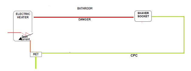

What's wrong with this little one, I wonder? :-)
But surely there would be no current in the dead-end CPC/exposed-c-p - until you touched it and something earthed. That would be just like receiving a shock from a live conductor while earthed; not really what we are talking about, is it? In the case of a pipe enlivened by a boiler fault then surely all earthed parts and extraneous-c-ps in the room will be similarly enlivened to a similar voltage.

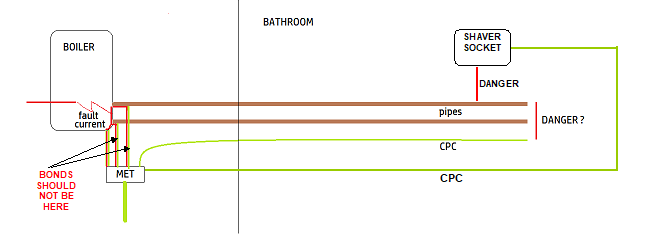

If I understand your diagram correctly, that scenario is very different from the 'simple' situation we have been discussing.
We have been talking about a scenario in which an exposed-c-p, connected via a CPC to the MET, becomes 'live' as a result of a fault and where there is an extraneous-c-p which is also connected to the MET (via bonding and/or earthing). When the fault arises, the potential of the exposed-c-p rises to considerably greater than MET potential, whereas the extraneous-c-p remains at MET potential - hence a considerable PD between the two parts.
However, if I understand your diagram correctly, the extraneous-c-ps (pipes) are connected directly to the exposed-c-p which is 'live' because of a fault (i.e. the boiler). In that situation, the exposed- and extraneous-c-ps will obviously at the same potential (connected by copper pipe, through which no current is flowing), and hence no significant PD between them - so, from that POV, there would clearly be no point of/need for SB.
However, in that situation there will be dangerous PDs between both extraneous- and exposed-c-ps and the MET (due to the 'VD' in the CPC from exposed-c-p to MET, due to very high fault current), so would represent a hazard for anyone touching either of those parts simultaneously with touching something connected directly to the MET. That means that, getting 'more complicated', if there were another extraneous-c-p, connected directly to MET but (unlike the ones already considered) NOT connected to the exposed-c-p with a fault, OR if they were an exposed-c-p on some other circuit (again, connected directly to the MET, but to connected to part with fault), then there would (during fault) be a dangerous PD between that part and the other two (both 'live') ones - and the only thing that could be done to avoid that would be SB.
Kind Regards, John
Originally yes, but then you introduced a CPC acting like an extraneous-c-p because of a fault elsewhere on the circuit.
Is what you had in mind not like my diagram?
OK. I got something right.
Is that (my diagram) not what you meant by an exposed-c-p acting like an extraneous-c-p?

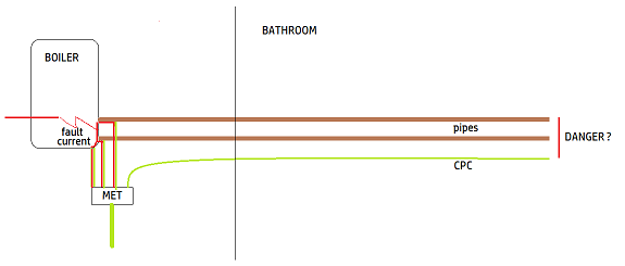

@EFLImpudence ... your introduction of the 'boiler fault' example/diagram has made me realise that, at least in the context we are discussing, the attempt at a distinction between "exposed-c-ps" and "extraneous-c-ps" can be potentially confusing and misleading, since, in functional terms (in relation to faults), there roles are essentially 'reversible'.
Not the least because of the BS7671 definitions, we tend to think of an "exposed-c-p" as the touchable metal parts of a Class I item which "... is not normally live, but which can become live under fault conditions" and an extraneous-c-p as touchable metal parts which are "... liable to introduce a potential, generally Earth potential" ("... and not forming part of the electrical installation).
In other words, we usually think of an "exposed-c-p" as the touchable metal parts of an item in the room which can become 'live' (high PD relative to MET) in the event of an L-CPC fault in that item (OR anywhere else on the same circuit) and think of "extraneous-c-ps" as pipes etc. which are "liable to introduce roughly MET potential" because of deliberate or 'incidental' connections to the MET. Under fault conditions, there can therefore be dangerous PDs between those exposed- and extraneous-c-ps. It is also important to realise that the CPC of a different circuit is at least as "liable to introduce roughly MET potential" as is a pipe, and so (in the presence of a fault) presents exactly the same potential hazard as does the ('earthed') pipe.
However, as I explained/illustrated in my previous post, the opposite can happen. If a metal pipe is in electrical continuity with touchable metal parts ("exposed-c-ps) of something Class I, then, if there is an L-CPC fault which makes the exposed-c-p 'live' (high potential relative to MET), then the pipe is really just an extension of that exposed-c-p, and will 'become live' (high potential relative to MET) if/when the exposed-c-p does. If that pipe enters some room, it is therefore (despite it being called an "extraneous-c-p") that pipe which may, under some fault conditions, 'become live' (high potential relative to MET). On the other hand, if CPCs (hence exposed-c-ps) of any other circuits (other than the one with a fault) enter the room, then it is they which will remain at roughly MET potential during a fault, thereby resulting in a dangerous PD between them and 'the pipe' (but 'the other way around' in comparison with the previous paragraph's scenario).
Hence, if we continue to use "exposed-c-p" to refer to the touchable metal parts of a Class I item and "extraneous-c-p" to refer to things like pipes, then I think we need to try to get it out of our heads that it is always the former which can 'become live' (high PD relative to MET) and the latter which is liable to be at something like MET potential - since, as above, it can easily be the other way around. However, no matter which 'way around' it is, the PD between the two 'parts' can be equally dangerous.
Kind Regards, John

Just to explain my diagram:
I did draw them ridiculously close to the boiler but the green lines are boiler CPC and bonds or other CPCs to which the pipes might be connected before they get to the bathroom; not supplementary bonding as they go to the MET.
The purpose of it was to illustrate that none of the fault current would be flowing in the pipes nor CPCs within the bathroom.

Just to explain my diagram: I did draw them ridiculously close to the boiler but the green lines are boiler CPC and bonds or other CPCs to which the pipes might be connected before they get to the bathroom; not supplementary bonding as they go to the MET.
Yes, I more-or-less realised that.
I very nearly re-drew your diagram with all those green lines to MET much longer because I think that, as you drew it, there is a psychological issue which possibly 'impairs understanding' ... they are so short that there is a temptation (at least, on the part of my brain!) to think that they are all 'joined together and to the MET', and hence will all be at similar (MET) potential - but, of course, the truth is that the very high fault current travelling through those (significantly long) 'green conductors' (all essentially in parallel) will result in a large potential difference between their ends (i.e. between boiler/pipes and MET).
Fair enough. However, the point I was trying to make (perhaps not very well) is that I think the only sense in which those green conductors (close to boiler) from pipes to MET (hence also to the CPC going to bathroom) may not qualify as effectively being "SB" (even if not explicitly installed as such) is because of their probable remoteness from the bathroom. If, hypothetically, the boiler were within the bathroom, then I think you might find it difficult to argue that conductors connecting (within the bathroom) the pipes to the incoming CPC (connected to MET) were not "SB conductors", wouldn't you?
