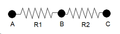

OK. Start with the simplest situation, which I presume is what you are thinking of, namely ...
If that's all there is, then, obviously, the resistance you measure between A and C will be R1+R2 and the voltage you measure between A and C will be zero, regardless of the resistance.

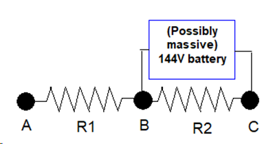

Now find a hypothetical 144V battery, man enough to push a current of 144/R2 amps through R2 (and if R2 is 'extremely small', then the battery will have to be 'extremely large' :) ).
Since the voltage across R2 is now 144V, you will hopefully agree that the voltage you now measure between A and C will now be 144V, despite the fact that the measured resistance between A and C (obviously without the battery connected!) could be anything, including 'incredibly low'. Do you agree? Translating that into the real-life scenario I have been talking about, we get ...
You will hopefully agree that the voltage measured between A (now the extraneous-c-p) and C (now the exposed-c-p) will again be about 144V, and that will remain the case no matter how small the (R1+R2) you measured
If you agree with the above, it takes me back to the question I asked above - what is the point/significance in 'passing' the 415.,2.2 'test' if it still allows a potentially lethal PD to exist between (potentially) simultaneously touchable parts??

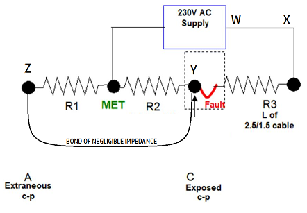

Yes, that's alright as you have drawn it, but isn't the last statement agreeing with what I am saying - and the regulations?
Surely with a bond between your A and C like this:
would mean a person (assuming not earthed) touching Y and Z would not result in a shock any more than if touching W and X.
Yes, that's alright as you have drawn it, but isn't the last statement agreeing with what I am saying - and the regulations? .... Surely with a bond between your A and C like this: .... would mean a person (assuming not earthed) touching Y and Z would not result in a shock any more than if touching W and X.
Yes, of course it wouldn't.
However, surely the point is that if (without SB) you had measured a very small resistance between your Z and Y (or between Z and MET), you would have concluded that the bond was not required, wouldn't you? If that were the situation, and your conclusion, such that you did not install any SB, you would have left the door open to a potentially lethal PD arising between your Z and Y (which might be 'simultaneously touchable'), wouldn't you?
Whatever, my question about the 'test' of 415.2.2 remains - what on earth is it attempting to achieve? As a test of the adequacy of SB which one had installed (which is seemingly what it is intended for) it is surely superfluous - since it's inconceivable that any bit of G/Y SB conductor would not satisfy the test, isn't it? - i.e. all one would be testing would be how well one had connected the G/Y.

Only one of my diagrams (the last one) is relevant. The fundamental difference between mine and your modification of it is that my diagram (and everything I have written) relates to the situation in which there is NO supplementary bonding in place.
Ok.
In your modification, you have added SB (i.e. a short bit of G/Y, usually of of ≥4mm² CSA, between extraneous-c-p and exposed-c-p) - which, as you say, would obviously ensure that the potential difference between those two parts would be close to zero under any credible circumstances.

Look back at the middle one of the three diagrams I posted (the one with the 144V battery). Do you not accept that you would measure 144V between my A and C, despite the fact that (if your meter had 'infinite' input impedance) no current would be flowing through "R1" (which is analogous to path from extraneous-c-p to MET).
Similarly (again assuming that your meter has 'infinite' input impedance), do you not accept that you would always measure 144V between A and C, regardless of the value of R1 - i.e. it you would measure 144V if R1 were zero (hence the total path impedance be as low as possible, namely R2) and would also measure 144V if R1 (hence total path impedance) were extremely high? In other words, the PD between A and C remains the same (144V) regardless of the impedance of the path between them.
If your meter is drawing no current ('infinite input impedance'), then R1 is really nothing more than an extension of your meter lead, so that what your meter is measuring is the voltage between B and C (i.e. across the 144V battery)
You still seem to be thinking of the first of the three diagrams I posted, in which no 'external influences' are injecting voltage into part of the path between A and C.

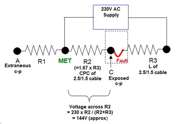

One more try. .... So, won't it happen in the CPC during the fault with, say, 160A flowing to the MET to which the extraneous-c-p is connected.
In the fault situation I was talking about (L-E fault in a Class I item), the extraneous-c-p (or anything else connected to the MET) is irrelevant as far as the fault current is concerned. In the absence of SB, all of the fault current (160A or whatever) travels through the circuit's CPC to the MET, resulting in a large voltage drop along the length of that CPC (144V VD in my diagram, for a 2.5/1.5 mm² cable) - the voltage at the downstream end of that CPC (i.e. at the exposed-c-p) is therefor 144V (or whatever) above MET potential.
However, the extraneous-c-p has nothing to do with the fault, fault path or fault current. No current ('fault current' or otherwise) will be flowing through it, so there will be no VD along it's length - so the end at the bathroom will be at MET potential.
With the exposed-c-p at 144V (or whatever) above MET potential and the extraneous-c-p at 0V above MET potential, there is clearly a 144V (or whatever) potential difference between those two parts.

I assume that by "touch voltage" you're referring to the potential difference between the extraneous- and exposed- parts. Is that correct?
If so, then, as I explained/illustrated, in the absence of SB it is essentially determined by the ratio of CSAs of the L-conductor and CPC of the cable of the circuit with a fault - the 144V I've been talking about is roughly what it would be with 2.5/1.5mm² cable (144V being 230V x 5/8) but, for example, it would be around 115V with 1.0/1.0mm² cable.
This is where I might well 'lose you' even more, because if one does add a SB conductor, then things get quite a bit more complicated, and one can probably look at things in terms of earthing as well as bonding!
Thought of in terms of bonding, if one connects the two parts with a relatively short length of an adequate conductor, then one more-or-less ensures that there can never be much of a potential difference between the two connected parts (the two ends of the SB conductor) - since it will have a very low resistance/impedance, such that no appreciable voltage will be developed across the length of the conductor with any credible current flowing through it.
However, by adding that SB conductor, what one has actually done is to place an additional conductor in parallel with the circuit's CPC, thereby reducing the effective "R2" of that circuit, hence also reducing its Zs (and hence increasing PEFC). The total fault current will therefore increase - if it were your 160A without SB, it could be appreciably, perhaps considerably, more than 160A after you added the SB. In that sense, therefore, one has 'improved' the earthing of the circuit, by effectively reducing the resistance of its CPC.
However, that (increased) fault current due to the SB will now be shared between two parallel paths back to the MET - one via the circuit's CPC and the other through SB conductor and the extraneous-c-p. How the fault current is shared between those two paths will obviously depend upon the relative resistances/impedances of the two paths.
As a result of the effective reduction (due to SB) of the CPC resistance (R2) of the circuit, the potential of the exposed-c-p (relative to MET) during a fault will reduce - e.g. if the cable is 2.5/1.5 mm², the voltage of exposed-c-p during a fault will reduce from ~144V (230V X 5/8) without SB to some lower (but probably not dramatically lower) figure with SB.
So, it's quite likely that, even with SB, the potential of the exposed-c-p during a fault will still be 'dangerously high' relative to the MET. However, because there is now a proportion (possibly a substantial proportion) of the fault current going (via SB) through the extraneous-c-p, the potential of its bathroom end will also rise considerably above MET potential. Without SB there was no current through the extraneous-c-p, hence no VD along it, hence the bathroom end of the extraneous-c-p was AT MET potential. However, with the SB, which results in an appreciable proportion of fault current flowing through the extraneous-c-p, there will be a considerable VD in that path, and hence the bathroom end of extraneous-c-p (as well as the exposed-c-p) will now be at a potential considerably above that of the MET.
Without SB the exposed-c-p was (during fault), say, about 144V above MET potential and the extraneous-c-p at 0V above MET potential - so a difference between them ('touch voltage'?) of 144V. However, just pulling numbers out of the air for illustration, with SB the exposed-c-p may have fallen to, say, 90V above MET potential, but the extraneous CP risen to, say, 85V above MET potential - hence now a difference ('touch voltage') of only 5V.
However, what I've just written illustrates one important point namely if one applies ANY supplementary bonds (between extraneous-and exposed- parts), then it's probably essential that one bonds together ALL extraneous and exposed parts in that location - since, during a fault, bonded extraneous-c-ps could be at a high potential relative to MET, hence a serious risk if simultaneously touchable with something unbonded which was connected to the MET.
