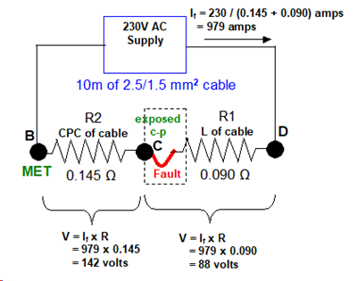

OK - and so to the “illustrations later” :). Firstly, a couple of disclaimers:
  • Firstly, some of the figures are not totally precise. Neither the ‘rounded’ VD figures for cables in BS7671 nor the more precise conductor resistance figures in the OSG correspond exactly pro-rata to the CSA’s of different-sized conductors. I have, for simplicity, used the ‘rounded’ BS7671 70°C figures - namely 22.0, 14.5 and 9.0 mΩ/metre for 1.0, 1.5 and 2.5 mm² conductors respectively.
  • It has been assumed that the L-conductor and CPC will be at the same temperature and, since (as below) it is only the ratio of the resistances of those two conductors that matters for this discussion, it does not matter what temperature is assumed, since any changes in temperature will affect the two equally, hence leaving the ratio unchanged. The standard BS7671-tabulated 70C° figures have been used. However, it seems unlikely that, during 'normal operation' (e.g. immediately before appearance of a fault) the CPC will be as hot as the L-conductor - so the calculations below might be over-estimating the resistance of the CPC
  • Secondly, again for simplicity, I have essentially assumed that Ze is ‘zero’ - or, at least, that the supply voltage at the origin of the installation is 230V during a fault. In practice, of course, voltage at the origin would decrease during the fault (because of VD across Ze). However, for the purpose of this discussion/illustration, all that matters is the voltage at the origin during the fault, regardless of what is happening external to the installation
So now consider the simple situation shown in this first diagram, in which a supply voltage of 230 is maintained whilst there is an L-E short at the end of 10m of 2.5/1.5 mm² cable.
The L-conductor has a resistance of 0.090Ω and the CPC has a resistance of 0.145Ω so a total path resistance of 0.235Ω. That means that with the voltage of 230V, the current is 979 A. That current flowing through the CPC (resistance of 0.145Ω) therefore results in a ‘voltage drop’ of about 142V (0.145 x 979). The voltage between the MET at the location of the fault (i.e. the exposed-c-p, at the other end of the CPC) is therefore about 142V.
If we change the length of the cable, say to 100m, then the resistances of L and CPC become 0.90Ω and 1.45Ω respectively, hence the total resistance 2.35Ω, the current with 230V is 97.9 A (230/2.35), and hence the voltage across the CPC (hence voltage from MET to exposed-c-p is, again, about 142V (1.45 x 97.9). We could similar do the same for various lengths of different-sized cables (using different R1:R2 ratio).
However, we don’t really need to calculate the current. If the fault current is If, then the voltage across the CPC (i.e. from MET to exposed-c-p) is (If x R2), but we know that (at 230V) If is equal to 230/(R1+R2) - so, taking those two together, we get:
Voltage = 230 x R2 / (R1+R2)​
… so the voltage depends just on the ratios of resistances, which remains the same for any length of a particular cable, without needing calculation of the current.

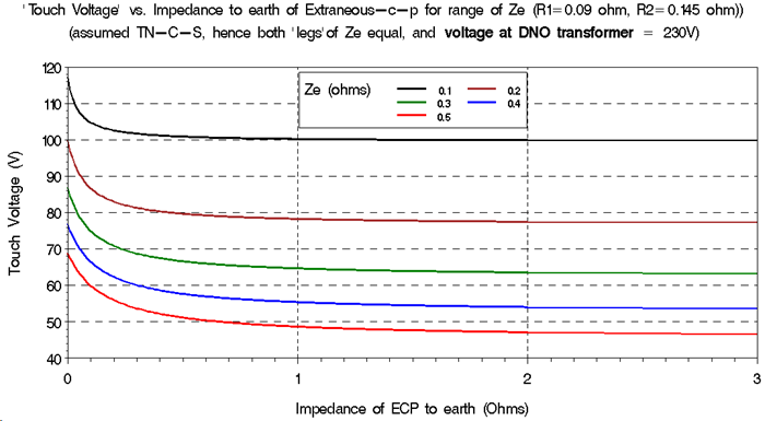

Your Diagram 1 (without MPB) and calculations are essentially correct (albeit I get fractionally different answers to my calculations), but probably not very realistic.
You appear to be assuming that the voltage at the transformer is 230V. I presume that your R1e and R2e are the two 'legs' of Ze (which will only be equal, as you have assumed, with TN-C-S) which means that, as you have said, there will be a VD of about 69V in each of those legs (hence about 138V VD in total), so that the 'supply voltage' (at the origin of the installation) would fall to about 92V during the fault - very different from my ('simplified') assumption of a supply voltage of 230V during the fault! However, that aside, your calculations are roughly correct. Since the ECP is assumed to be at true earth potential (since little/no current flowing through it), the 'touch voltage' will simply be the sum of the voltages across your R2 and R2e - which, as you say, would be around 125V (slightly higher by my calcs).
However, when one moves onto your Diagram 2 (with MPB), things start going a bit wrong, because you have assumed that the ECP has a zero impedance/resistance to earth.
It's obviously not a realistic real-world situation, but IF that impedance were zero, then all of the fault current would go through the ECP (totally 'bypassing' R2e), but the potential of the ECP (hence also potential of MET, if the resistance of the bonding conductor was 'negligible') would still remain at earth potential. However, the total fault loop impedance would then fall to 0.41Ω (0.175Ω + 0.09Ω +0.145Ω), so that the fault current (with 230V at the transformer, per your diagram) would become about 561A. The 'touch voltage' would then be simply the voltage across R2, namely about 81V (561 x 0.145).
In a real-world situation, the impedance/resistance of ECP to earth would obviously not be zero, in which case the fault current would be shared between the ECP and R2e. The potential of the ECP, hence also MET, would therefore rise to above earth potential. However, that would again result in some reduction in fault loop impedance (since R2e would now be in parallel with another path to earth, hence higher fault current, hence more VD across R2.
To illustrate with some figures, if one assumes that the path to earth from ECP had the same impedance (0.175Ω) as your R2e, the two of those in parallel would have a combined impedance of 0.0875. Total fault loop impedance would then be 0.4975Ω (0.175Ω + 0.09Ω +0.145Ω +0.0875Ω), hence fault current about 462A (230/0.4975), and hence the 'touch voltage' (voltage across R2) would be about 67V (462 x 0.145) - which, co-incidentally, is close to the figure you got.
More generally, as the impedance to earth of the ECP increases upwards from zero, the 'touch voltage' progressively decreases (from a maximum of about 81Ω 81V, when the ECP impedance is zero), and, with all your figures (including an assumption or 230V at the transformer) the touch voltage' approaches a minimum value of about 57Ω 57V when that impedance gets very high - per the graph below.
Assuming I've got it right, does any of the above make sense to you (or anyone else)??

... More generally, as the impedance to earth of the ECP increases upwards from zero, the 'touch voltage' progressively decreases (from a maximum of about 81Ω, when the ECP impedance is zero), and, with all your figures (including an assumption or 230V at the transformer) the touch voltage' approaches a minimum value of about 57Ω when that impedance gets very high - per the graph below....
.... I could/should perhaps have elaborated .... the minimum 'touch voltage' of about 57V was a consequence of your particular figures - it would be different for different values of your R1 and/or R2 and/or Ze (your R1e + R2e). This graph shows (with your values of R1& R2, and 230V at the DNO transformer) how 'touch voltage' varies with the impedance of ECP to earth for various values of Ze (assumed equally split between both legs, as with TN-C-S) ...
[ Edit: I might have observed that, if I've got it right, using your figures/assumptions, touch voltages could only be <50V if Ze were above about 0.45Ω (and impedance to earth of ECP >1Ω or so). Having said that, 'your assumptions' clearly are not realistic, since I don't think that voltage at the transformer would ever be as low as 230V - probably usually at least 252V, I would guess ]...

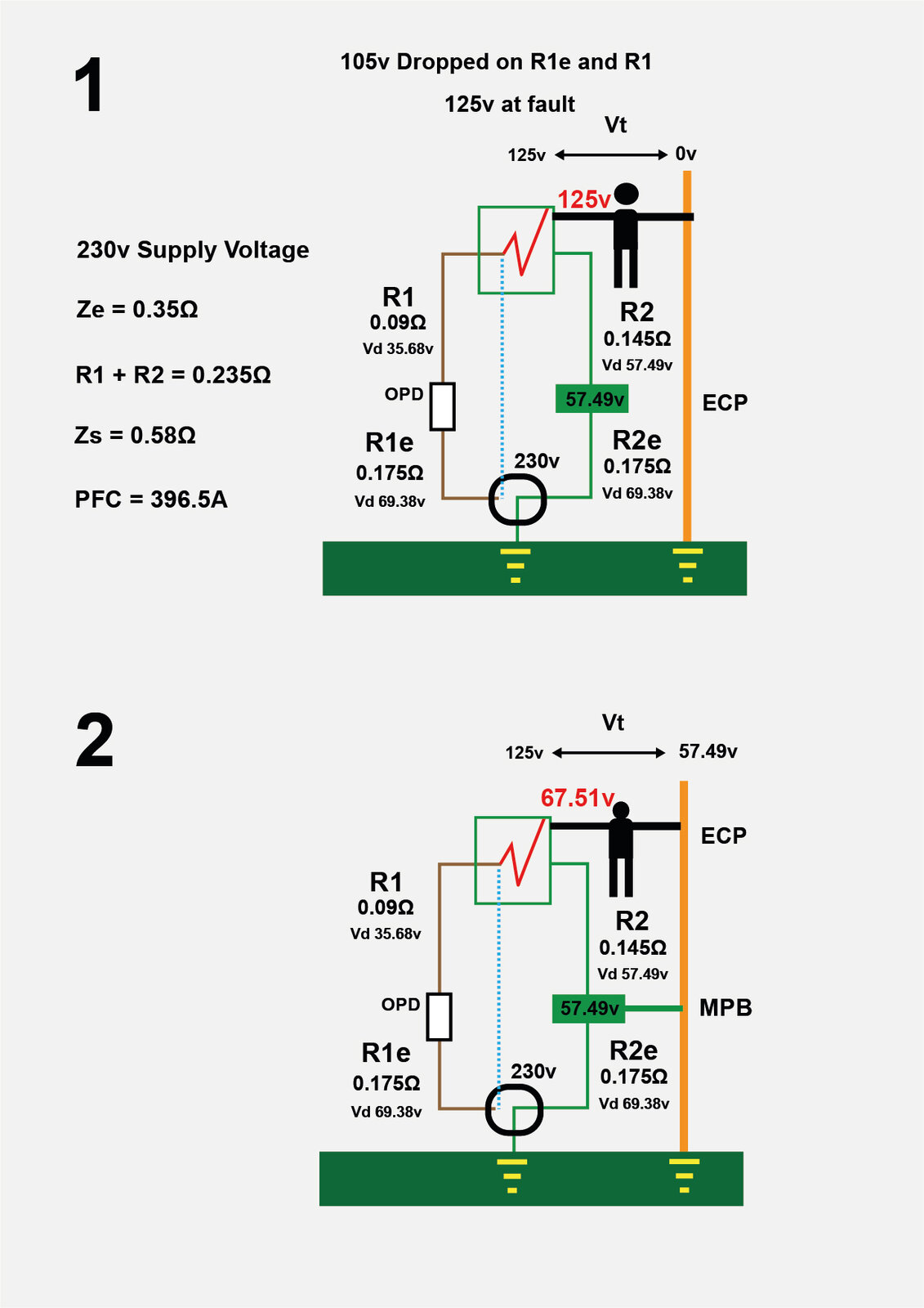

Thanks very much for this John...I Think i am starting to get somewhere, then I lose it all again.

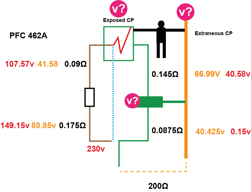

Here are a couple more diagrams.
So in the first diagram, Its the figures you used.
The Black type is the resistance
The Orange is the volt drop
The red is the voltage appearing at each point, deducting as I go around I should end up with 0 volts (I got 0.15v, I presume thats just then maths)
So we have a touch voltage of 67v
Which is the potential difference between the exposed CP and Extraneous CP / MET
This second diagram
I have increased the voltage of the transformer to compensate for the volt drop at the load.
So we have 230v at the load in a healthy circuit and 235.85 at the transformer.
I have a very low External R2 which is caused by Pipe.
Now We are using this figure to get the EFLI, to get the PFC.
But the Pipe apparently being so low in resistance would take the most of the fault current. But that is presuming it has a return to the transformer of 0.05Ω, which it clearly will not have, as the mass of earth is the return path. A figure of 200Ω might be more reasonable.
(Which would give us a ZS of 0.82Ω and a fault current of 287.62A and a Touch voltage of around 86v)
But it does show how a low Ω return path increases the touch voltage.
Which I have at 101.74v
Again in orange I have indicated what I think the voltage will be at...
The service fuse 176.9 v
At the fault 116.26V
At the Met 14.72v
and back at the Transformer - 2.32 ( so some slightly out maths there !!)
But its that R1 section
0.302 Ω 101.74 Volts dropped. Which is the touch voltage.
So the potential difference is between the 116.26V at the Exposed conductive part
and the 14.72V that appears on the MET. ?
So if I put a voltage tester on those two points I would get 101.74V
But this can't be correct can it ??
As touch voltage has to be below 50V.
I don't see how a touch voltage of less than 50V can be achieved.
Thanks...

OK. I'll take it in stages - first in relation to your first diagram ....
So in the first diagram, Its the figures you used. ....
Sort of. You're still assuming that there is 230V at the transformer but you have, for some reason, halved the 'earth side' of the Ze (what you previously called R2e), from 0.175Ω to 0.0875Ω. That doesn't matter, so I'll go with your new figure.
The Black type is the resistance ... The Orange is the volt drop ... The red is the voltage appearing at each point, deducting as I go around ....
OK, I understand, although I do find your diagrams a little confusing. The red figures are, of course, voltages (potential differences) relative to earth.
... I should end up with 0 volts (I got 0.15v, I presume thats just then maths)
Indeed, that small discrepancy is just because you've been rounding some of the figures. The fault current (with your figures) is actually 462.311558..... V (rather than 462 V), and if you used that figure, and did your calculations to a reasonable number of decimal places, you'd end up with a figure (after all your subtractions) very close to zero.
So we have a touch voltage of 67v ... Which is the potential difference between the exposed CP and Extraneous CP / MET
Agreed, but you've made life a bit unnecessarily difficult for yourself, since the 'touch voltage' is simply the voltage across your "R2" (0.145Ω) - so, once you've calculated the fault current, you just need to multiply it by that 0.145Ω .... 0.145 x 462.311558...= 67.035... V.

This second diagram ... I have increased the voltage of the transformer to compensate for the volt drop at the load. So we have 230v at the load in a healthy circuit and 235.85 at the transformer.
Fair enough, but that will obviously still result in the 'supply' voltage (at the origin of the installation) being dramatically lower in the presence of the fault.
I think that your diagram, and thinking, is all a bit confused/confusing. I also think that, at least at this stage of the discussion, you are unnecessarily complicating things by introducing the 3kW 'healthy load'. Apart from anything else, under fault conditions there will be a very much reduced voltage across that load, so (assuming it is a 'simple', e.g. resistive, load), it will be drawing a lot less than 3kW during the fault.....
I have a very low External R2 which is caused by Pipe. ...
No - because, as you go on to say ...

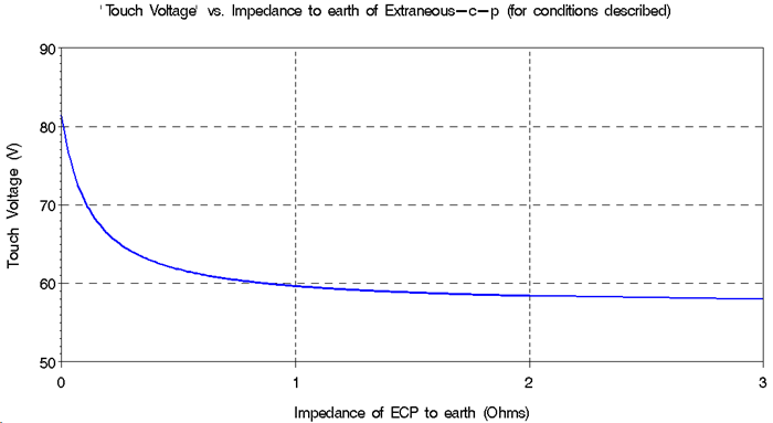

Exactly - although I think that 200Ω is pretty 'pessimistic' - a lot of the concerns about ECPs (particular in the face of TN-C-S 'lost neutrals') is in relation to ones which have 'very low' impedances to earth.
As you saw from my graphs, the touch voltage does alter significantly once the impedance to earth of the ECP gets much above 1Ω or 2Ω (let alone your 200Ω), since very little of the fault current then flows through the ECP.
Hence, the bottom line is therefore that if the path to earth from the ECP is more than "a few ohms", then one is essentially back to your Diagram 1 (albeit you reduced "R2e" from 0.175Ω to 0.0875Ω for that one, for some reason!).
.... But this can't be correct can it ?? ... As touch voltage has to be below 50V.
As I said, if my calculations and graphs are correct, then it's impossible (with your values of "R1" and "R2") to get 'touch voltage' below 50V unless total Ze (assumed equal in both legs) is above about 0.45Ω - why don't you try with a total Ze of, say 0.8Ω (0.4Ω + 0.4Ω) (which would be credible for TN-S)?
Kind Regards, John
Edit: clarification added (in red)
