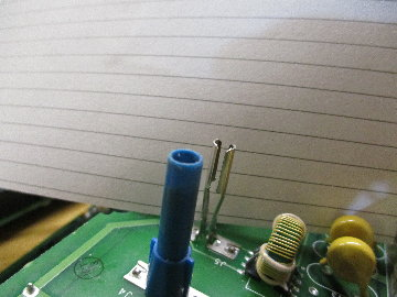

The lead sockets don't look as though you can do much to them.
One doesn't need to - they are remarkably simple. The contact is just 'split' (see the 'naked' PE one below), protrusions inside the coloured sheaths preventing the two halves touching - so, as you say, anything metal inserted will connect the two halves (which have separate connections to the board). Mine are also spotlessly clean - no suggestion of any tarnishing etc. Just to be sure, I've tried explicitly connecting the two sides (of the L and PE ones) but it still thinks that there are no leads. As expected/feared, I therefore think the electronics has gone awry and is not properly recognising that the leads are plugged in ....

Given your description of the sockets, can you see what is in series with them, which might give a clue as to how the presence of a lead is detected? For example, a relay coil might be in series with the split contacts, thus energising the relay when the contacts were joined by a lead plugged in.
I've been trying very hard to trace the circuitry, but it's far from easy.
One side of the ('split') L lead socket, goes through the coil of a little toroidal transformer and thence through a fuse (** see below). If one removes that fuse, on power-up one gets an "Err1" message ("failed self-test - return to manufacturer"), rather than the "LEAd" message.
** that fuse seems a little 'naughty'. Unlike the one which is easily accessible (and replaceable) within the battery compartment (which I suspect is also effectively in series with the L lead), one cannot even see, let alone replace, this second one unless one completely dismantles the machine. ... it would appear that if that second fuse blows, most people would end up having to return the machine to Fluke for 'repair' (at whatever cost!).
My attempts to trace the circuitry continue ... "A circuit diagram, a circuit diagram, my Kingdom for a circuit diagram" :)
