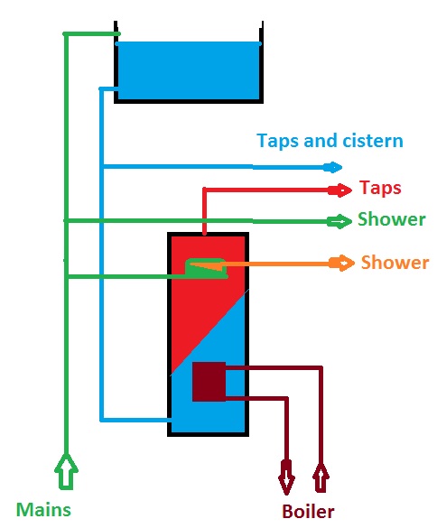

For what it is worth,
I have a hot water cylinder that (a) supplies low pressure hot water to the bath and basin taps and (b) serves as a heat store for heating mains pressure water to the shower.
The green / orange item is a coil
This avoids the use of any pumps or control systems for the shower ( the shower works during a power cut ) other than the cylinder thermostat and timer controlling the boiler heating the cylinder.
Thanks for that, it looks like a nice setup, and not so far from what I would like to do.
