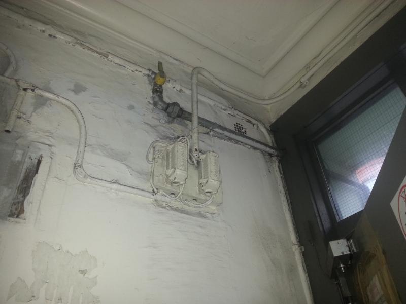

Very old henley fuse box
Connecting a new supply from the lighting system should be fairly straightforward as you say. It's how you'd safely disconnect that old cable that would worry me....
Indeed. Furthermore, we all seem to have been distracted away from the original problem - namely that the (presumably once working) intercom system had stopped getting power. There has to be some reason for that- which ought to be investigated.

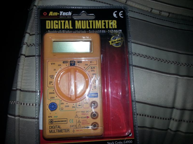

i have one of these but i would not risk using it on 240v i just use it for car stuff

You really, really need to get someone in to sort out those wires. It maybe that those fuses and that box actually belong to the DNO so you can't legally do anything to it. In fact, if that really is DNO property then someone has probably tapped into it illegally and before the meter so the small amount of power used by the intercom may have never been paid for.
There is no safe way for you to do any work on it, call your supplier or get someone in.

ok iv got more pics. this is the top of the fuse box

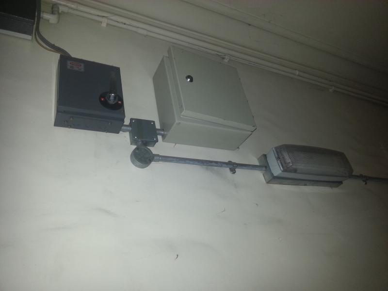

this next pic is the boxes and how it looks, the order is fuse box, intercom, shiftier for the lights control box i think with a key lock, i think if i could get into that i might be able to get power from there because i could switch it off with the shiftier
this is the same only showing the light

Cooor blimey.
All looks like the sort of old stuff with stuff added that you'd find in typical building in a military base.

That cut out is dangerous.
Is that a piece of loose metal resting on the top of the middle fuse. ? Image what would happen if that fell onto the exposed live metal terminal of the left hand fuse and shorted the 100 amp (?) supply to the casing. That would be a serious fire hazard.

its a bit of wood just very dusty as everyone's power go's threw hear i assume the bill will have to be split 6 ways
Clearly true - but do you think that any of those cables look OK to be protected by a 100A fuse? This is surely a generally very dodgy-looking electrical installation (at least, at the supply end) which needs urgent attention (at the very least, inspection and assessment), isn't it?
Basically it's appalling, the means of connection to that age of Henley is generally by a sweated ferrule, which can be seen in some of the photos. How the very small cable and the newer (??) grey PVC are actually connected is another question. There is a single bolt to secure the ferrule but it would certainly not be up to being used for a connection. (we now have some screw ferrules that fit these)
