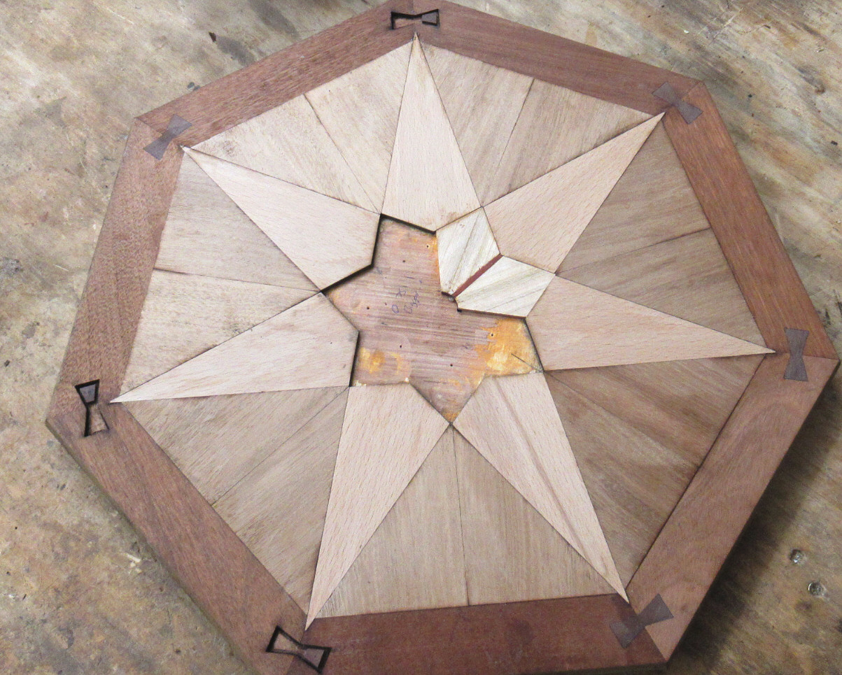

a bit more done - I'm hoping the bits of beech will look like bright rays of sunshine - LOL

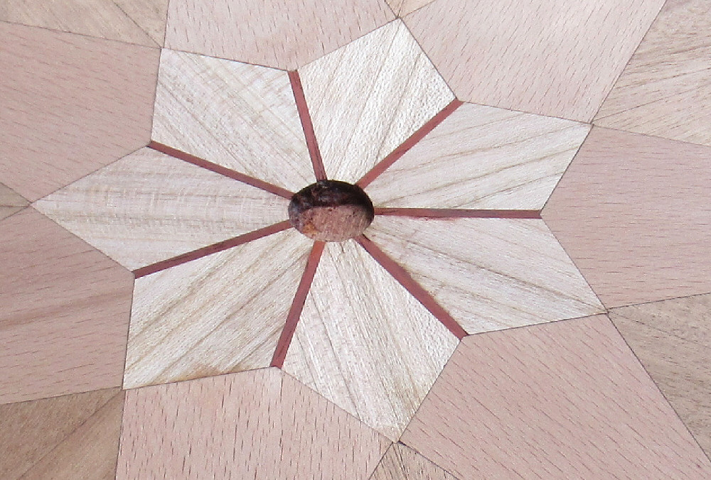

A bit more done, the Cherry with Padauk in the centre is turning out OK,
For reasons beyond me the wood (triangle bits) and I don't know what type of wood it is, won't plane properly. I am going to have to level it all with a scraper - I will need new thumbs!
The beech is coming up nice, as beech always does.

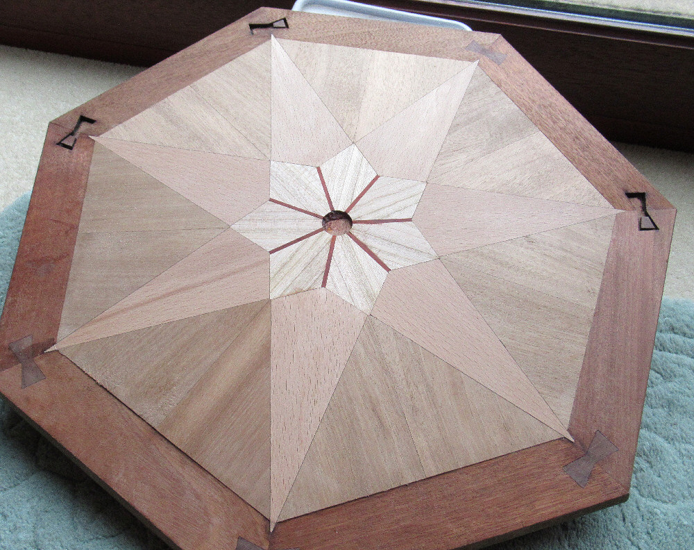

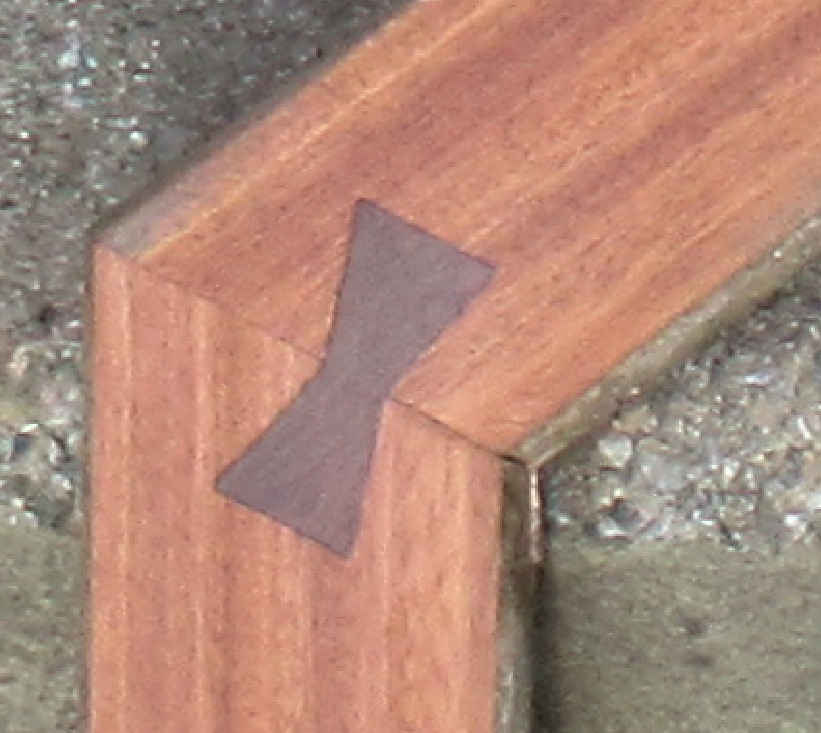

Are the inlays at each point a deliberate design for the table or a practical solution to fix the sides together?
part of the design, it was my suggestion, thought those traditional bow ties would make it look like something made a long time ago, and she liked that idea
the shape of them would give great mechanical strength and then there is the extra glue area. but I doubt it needs them the way I have put it together.
difficult bit next putting in the strange planetary symbols - it could go very very wrong - purposefully saying sober the night to give me a steady hand
A happy coincidence then, as it bears a resemblance to the Extinction Rebellion logo - or the rune 'Dagaz', if she prefers. It adds a pleasing symmetry. (y)

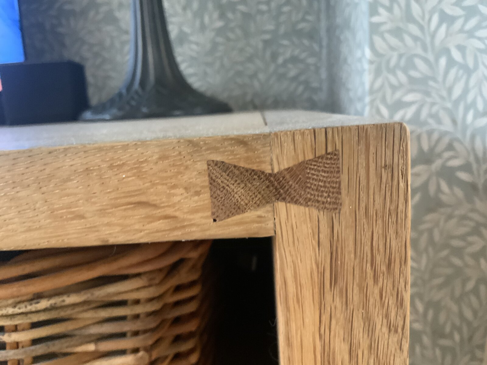

We have some of them on our stuff. I wondered whether they were just decorative or served a purpose. I would have thought that if they were to hold things together they might split along the grain?
Nice job, what will you use as a finish?
so it does Dagaz Rune - the bringing in of change, a new day. Fits perfectly with the tables theme of sun and planets - (or is it witchcraft)
this is a second co incident with with these bow ties; I got the wood out of a skip, Brass coat hooks on a strip of wood, I kept the wood as it was a close grained very dark hardwood - a bloke I know from the shed who is an old cabinet maker (and is a wealth of knowledge of such things) told me it was Black Walnut. A few weeks later me and the wife were at an open garden day and my wife who likes her trees did not recognise one of the decorative trees in the garden so we photographed the leaves so as to identify it on a Plant ID website - you guessed it, it was a Black Walnut!
