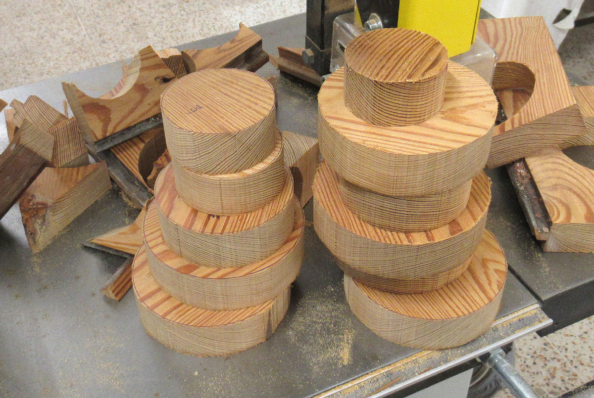

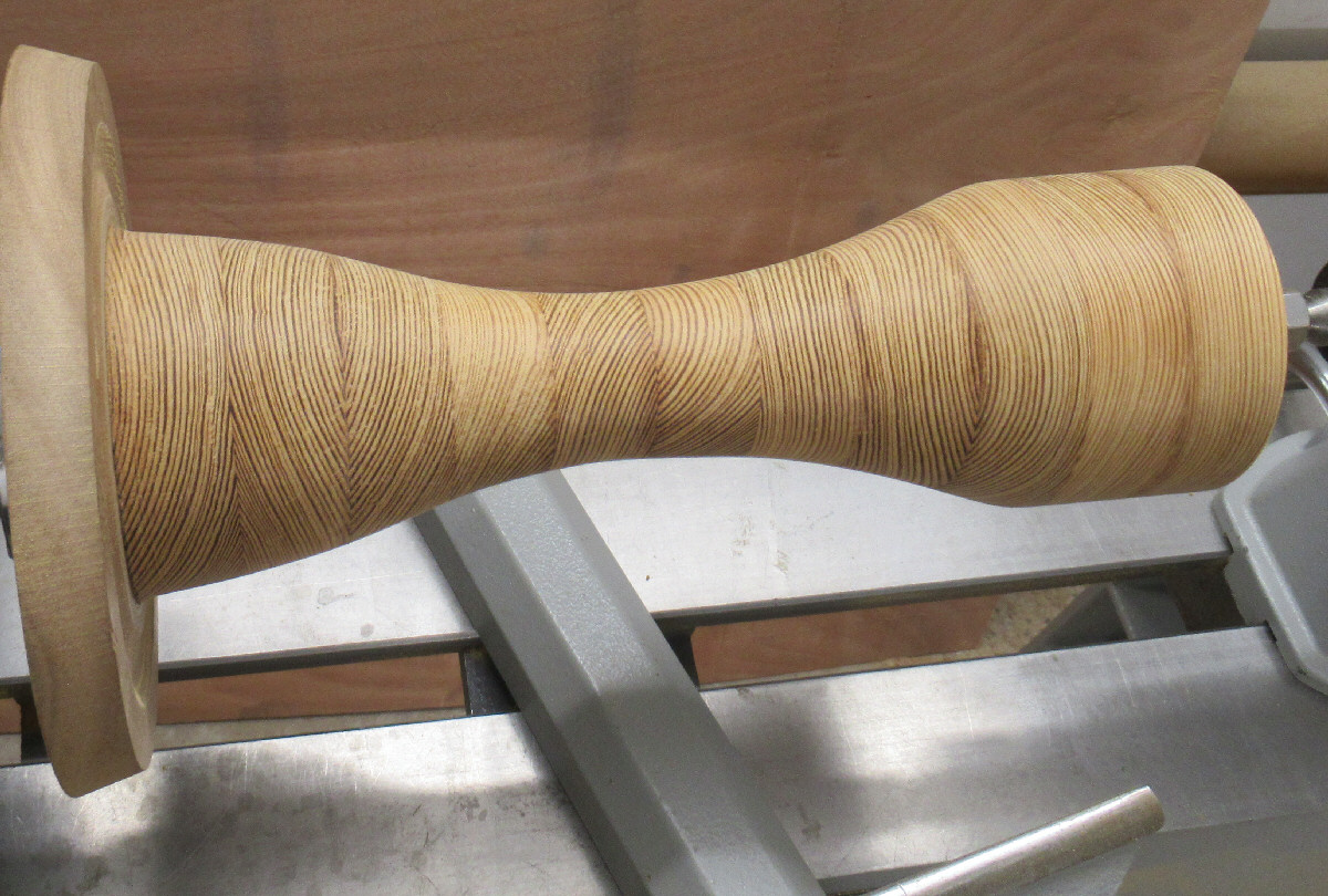

found a bit of wood so I can start the leg, its a bit battered and full of nails and screws but uts Pitch Pine abd that has a beautiful end grain and could look nice
get them all glued together and see what it looks like

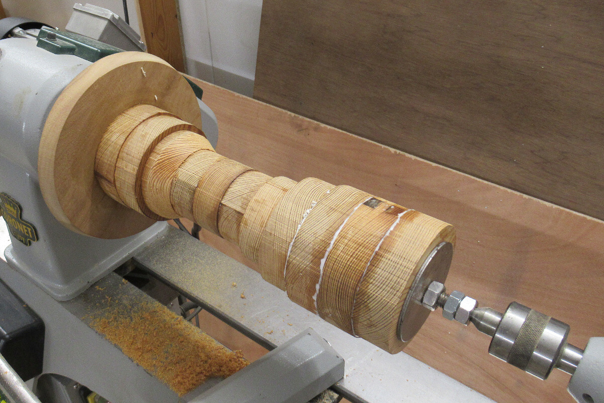

meanwhile, got a bit more done, glued it all up on a threaded bar, the cross grain would make it quite weak
Didn't turn well tried carbide scraper and my super sharper roughing chisel but the finish was awful
So took to it with the angle grinder (36 grit disc) made a lot of sawdust but thankfully it is giving a better finish, been over it with some 80grit and it is looking promising
think I will take it down to 320 before oiling, a lot of time sanding
