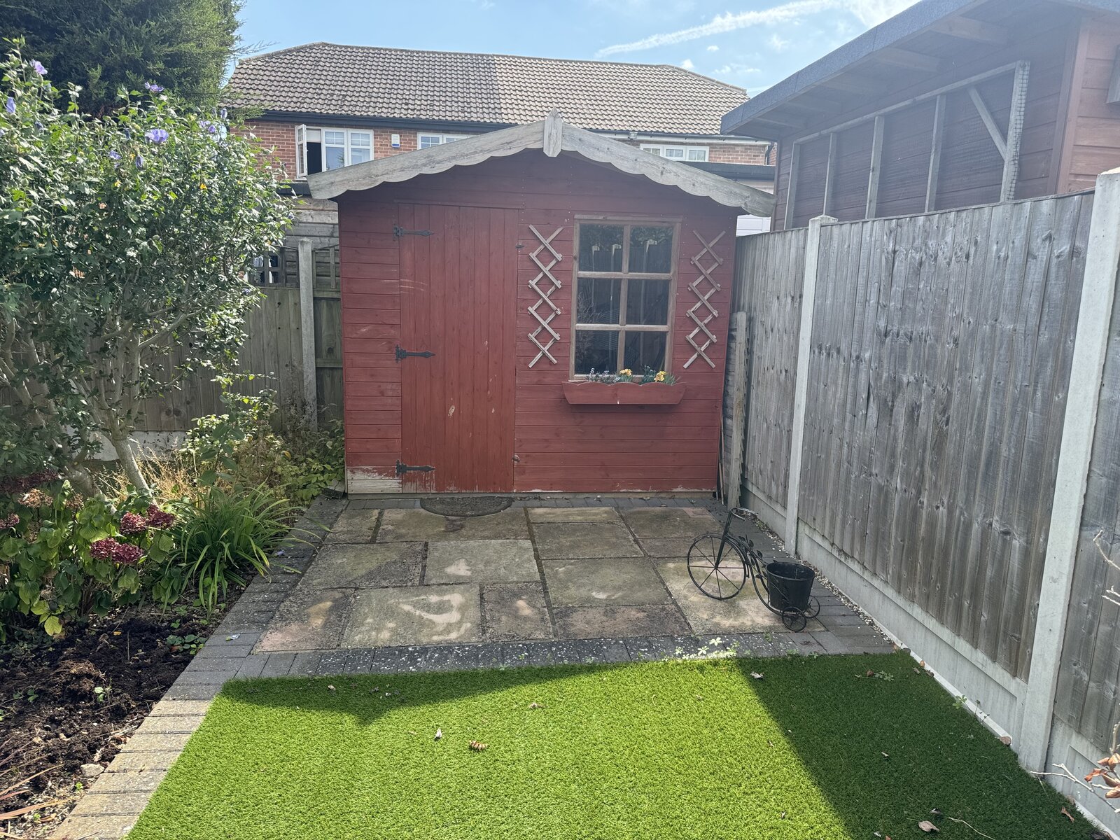

The MIL's house is being put up for sale. Fully furnished but nothing in there that she can take to the care home so it’s all going to be given away/donated/chucked out when the house is sold. I went down there today and took all the gardening tools for the allotment. Also took a wicker table and chairs plus a bistro table and chairs for Miss Mottie who moved from a flat to a house yesterday. She has a nice summerhouse/shed there too which Miss Mottie might want - I think she paid something like £1200 for it to be delivered and assembled.,She'd need to hire a van but I can take it to pieces and build it back up for her. I’ll ask her tomorrow when we go to see the new house.
