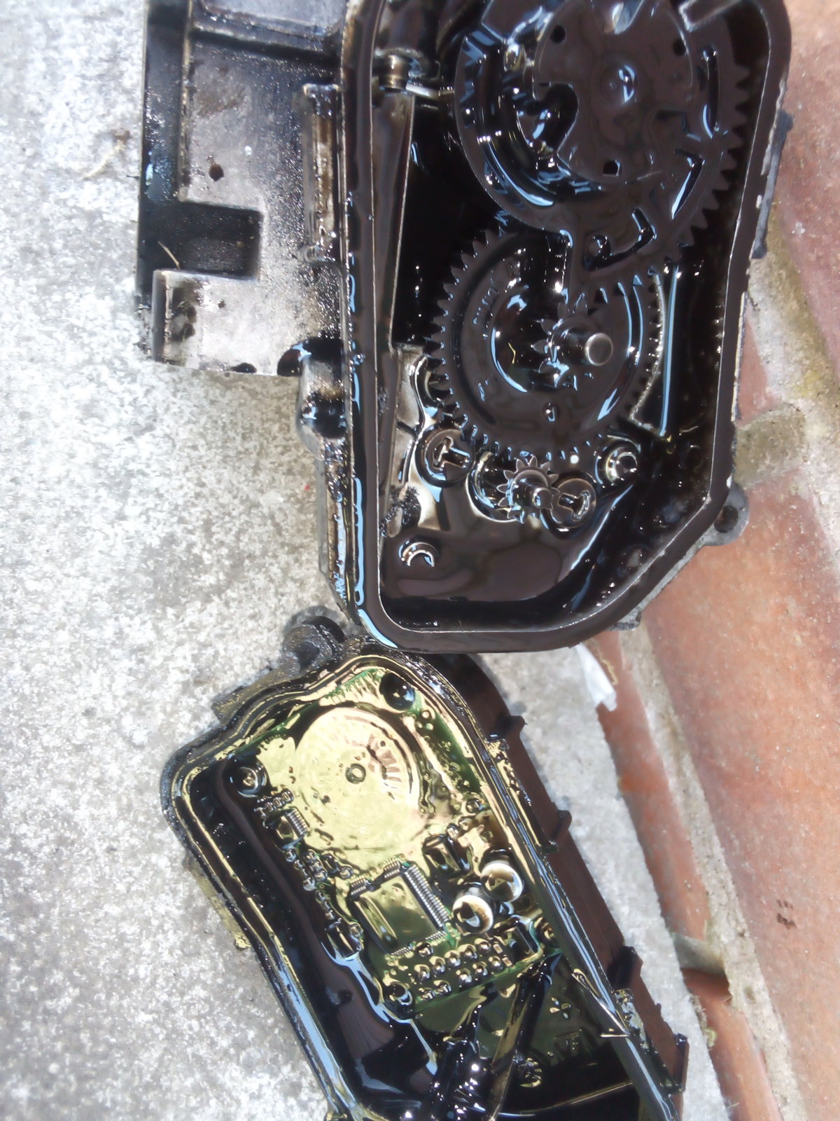

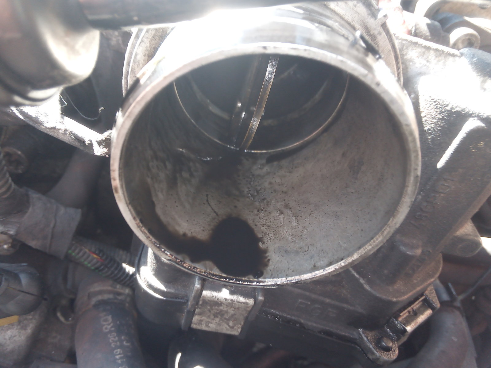

I uploaded a photo here, there is a little amount of oil in inside of the throttle body, whether that is normal I'm not sure . I read up online and it seems a bit of oil is normal inside of the throttle body, especially on a higher mileage engine. In my opinion the little bit of oil inside of the throttle body on my car is not excessive.
I took the old throttle body apart and I am more concerned about the oil leaking from underneath on the bottom of the throttle body , there is a circuit board inside and that was covered in oil

For sure, that oil isn’t doing the throttle body much good, is it :eek:
That oil is coming from the turbo but it could carry on like that for ages......no one can forecast how long its got to go.

Hi John, I assume you are referring to the oil on tohe circuit board and gears ? It had more oil than that in it but I emptied it out before taking this photo
does the small amount of oil inside the throttle body itself look normal ?
The throttle body in the photo is the one I took off the other week when I repalced it, and the replacement is leaking oil also which probably looks the same inside as that one does.
Is it almost certainly turbo related ? If so I may go about just getting it done. I would not sell my car without having to mention it to the buyer anyway as the underside of the throttle body is leaking oil e.t.c. THerefore I would probably have to reduce the price of the car by £300 or I can go about getting it fixed for the same amount and have the problem fixed. so it will cost me either way. ( probably didn't help when the turbo boost pipe was left un attached for 1700 miles of driving )
